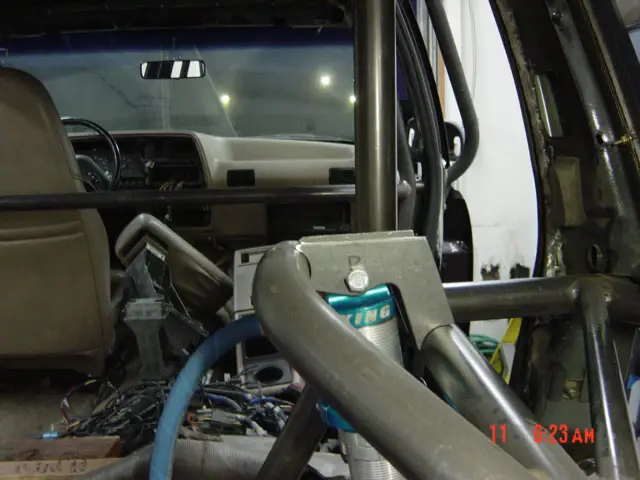

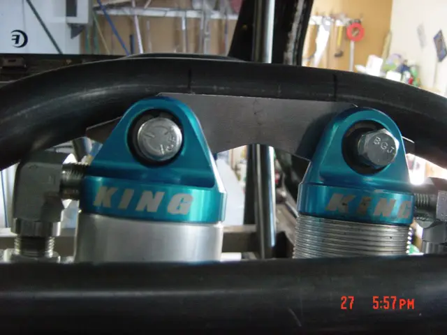

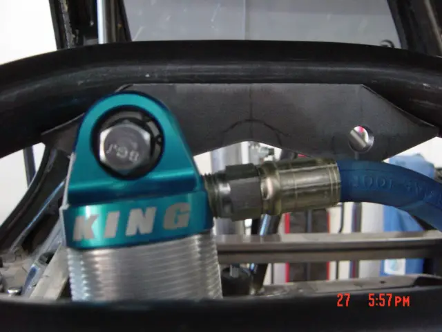

updated photo on a revised shock bracket. The rear shock bracket goes from this first make --
To this updated and final shock bracket that Winter made.

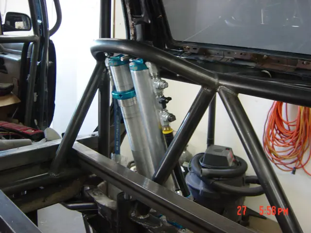

Here a couple more pic--

...I like the change of direction for ease of removal...:thumbsup:
...What thickness did that plate wind up being???...:scratch:

btw not to sound like a smartass:rolleyes:... but i actually liked the first "double shear" shock mount a lot better then the second one (or is there a part missing on the second design?)

The three little birds perched by doorstep said ney IZwack, ney -- for they are air rams, not bypass shocks.
Stephan, no missing part, but like Tbar said, much easier to remove since they are so close together.
Thats even more amazing! Can't wait to see it go up and down :)
Though's 3 little bird's were right!:p: There will be two more up front also. I to can not wait to see them in action. Hopefully no more hi centering.

Single shear is not fine for a rock crawler. Let us know how long they last before the brackets rip off.
Yes yes -- but lets not forget, there are two devices that support the weight per corner.
LOL ..... IMHO a harsh post like that makes you look like a smartass ;)
but i agree: i personally would feel better when them nice big Kings would be supported by shear force and not relay on the bending strength of the bolt (or at least i would replace the 1/2" reducer bushings and run 5/8" bolts together with spacers that are welded to the base plate)

Paul, i hear ya on the easy access.... on my cars there is usually so much stuff and everything is crowded so tight together that you have to remove the bypass shocks to access the pre-load ring on the coilovers :confused:....
a pain in the rear ... but at least after you finally set your ride height there is no need to remove them anymore
Hey Boys.....Paul was mistaken and what you see is only the first plate of much more to lock in each shock. I changed the direction of the bolt so when I valve I can just remove one and not both shocks. The other way I would have to pull the RAM and then the C/O not cool when in the field.:D
