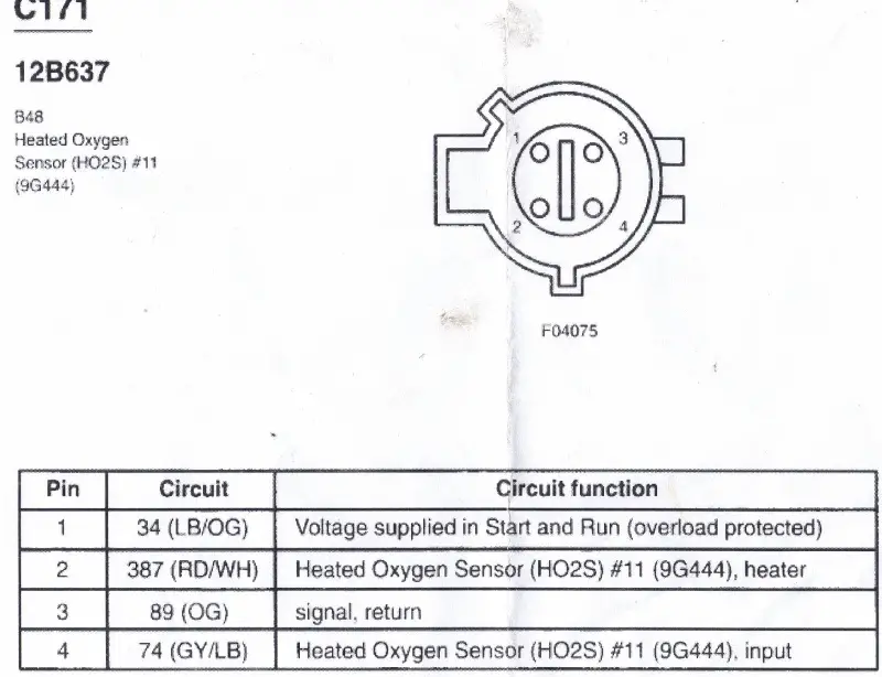

Hi
my 2002 ford explorer 4.6l after built 3/02 original O2 Sensor connector melted. Finally got a new os sensor and pigtail but don't know which color goes to which. Pig tail different to truck harness
Wondering if anyone can help me figure out how to wire the new Connector to the existing harness.

I have a pink ,a black , black with white line , green with orange strip

I’ve been looking for 02 explorer 02 sensor wiring diagrams to no avail yet
But I can tell you what pins are what function
Here is ford 4 wire to Bosch universal oxygen sensor pinout
I found this too just now. My wire colors are the same as '03 explorer 4.6l . Hope the photo shows up. My pig tail is after market different color but now I know the pin and wires
