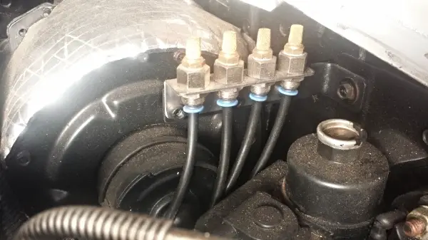

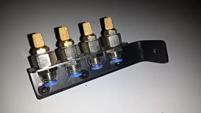

Just made another bracket to suit for my needs.....
Very nice!!

First off, I love following your truck. I haven't seen breather filters before but I have been wanting to do something like what you're doing. Where did you get that set up?
thanks' ... got that from my local 4WD shop but I am sure you can buy that from online...
oh I just had a look and it seem only Australia sells it... (check this one)

Look forward to seeing the lines hooked up.
I do just wish they came in black instead of the blue.
EDIT: for the link I see the tubing is black, just wish the blue seal portions were black lol. I wonder if they can be painted.
yeah mate, I replaced mine to black tubing but the blue part is plastic and yeah maybe its possible to paint it black....
few of my friends uses the air bubbles brass for the fish tank and it does seems look like it too anyway lol... (check this out)
http://www.ebay.com.au/itm/like/390690595672?limghlpsr=true&hlpv=2&ops=true&viphx=1&hlpht=true&lpid=107&chn=ps
http://www.ebay.com.au/itm/like/350915367127?limghlpsr=true&hlpv=2&ops=true&viphx=1&hlpht=true&lpid=107&chn=ps

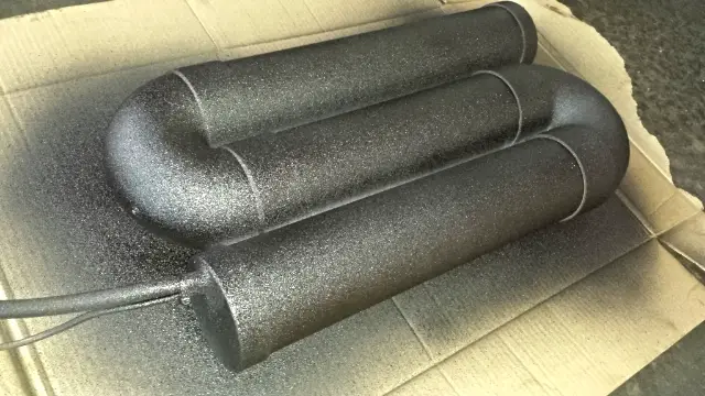

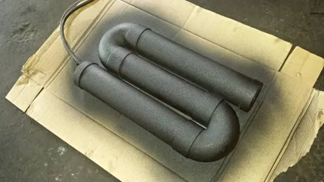

Just made a water tank from pvc pipes to fit under the Explorer...
For shower or washing stuff off road..
Installed a 12V shower water pump and it takes around 20ltrs+ of water to fill, I sprayed the pipe with spray Real Liquid Rubber Coating waterproofing...
