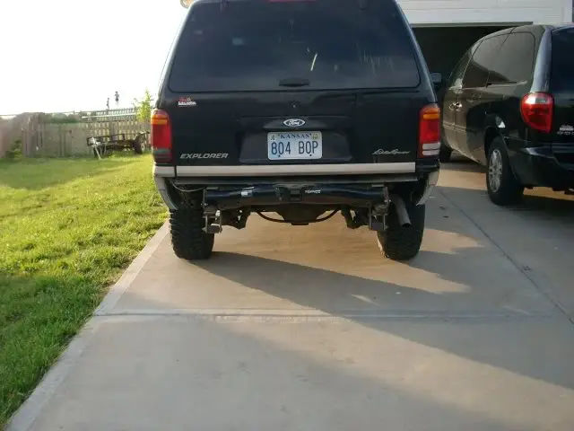

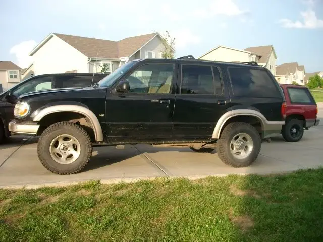

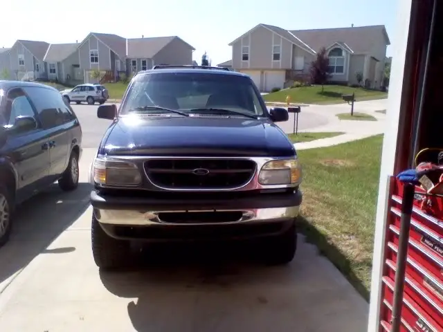

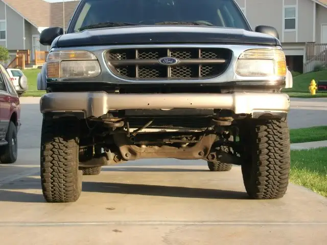

Been working on improving my departure angle, I think this will greatly help. Now it seems there are other things hanging down, the shackles will be taken care of with some bastard leaf springs, and the spare tire is undecided at this point.
on to the pictures
Also placed an order with fastenal today, bolts will be here Tuesday and the body lift block should be here Monday, with install coming next weekend:cool:.

Are you going to cut the chrome and fender under the molding on the sides too?
You might want to think about having your exhaust pipe moved to exit the side behind the tire as well. That will keep it fairly safe compared to where it's at now.
I do like how that hitch is set that high, that makes a big difference in clearance. I have seen a small bumper like deal that attache's to the hitch. You could use that for when your not wheeling.
Your getting there, good work! :biggthump
The hitch almost sits too high, but all I did was take a stock one cut the tabs off and flip it over it was getting dragged way to much everywhere.
I'll probably take of the chrome side things, the exhaust will probably just get cut shorter. Once I get the correct electrodes for my welder, I think the hitch will get beefed up as well as add to the area to make it look more like a bumper. The spare tire is still a mystery since if it gets put on top it probably won't fit in the garage anymore so looks like a spare tire carrier will need to be built as well.

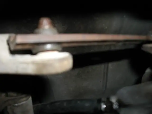

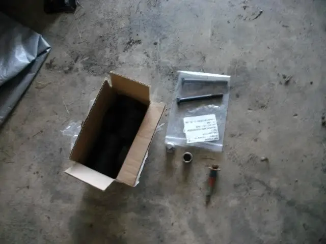

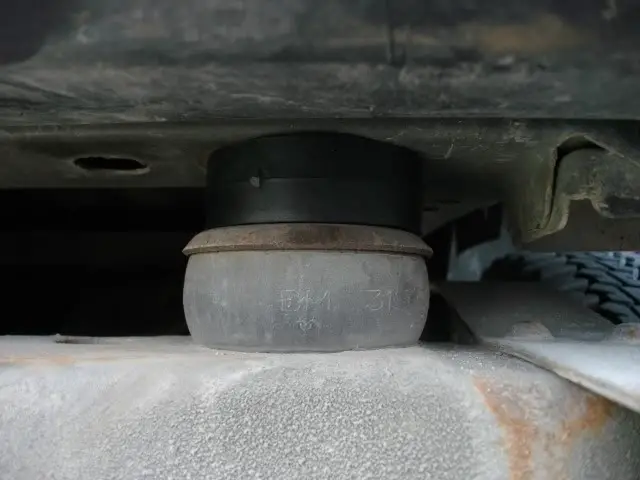

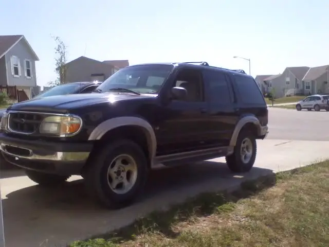

Got the 1in body lift on without any major hichups, the front drivers bolt was a pain, and the two bolts that I bought were too long. But other than that it went awesome. I highly reccomend this to any one wanting a little more clearance, if the two bolts would have been the right size this would have been done in under 2 hours, which seems extremely fast compared to most people's experience with body lifts.
Everything needed for the lift.
10 1in PA BB01 blocks
2 M-12 110mm bolts
15mm socket
18mm socket
19mm socket for new bolts
vice grips
1/2in drive ratchet
block installed
the finished product
bumper somewhat repositioned
the rear without the spare underneith

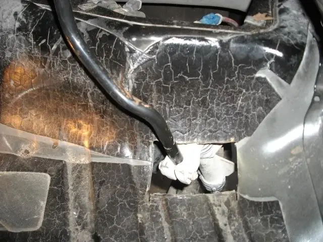

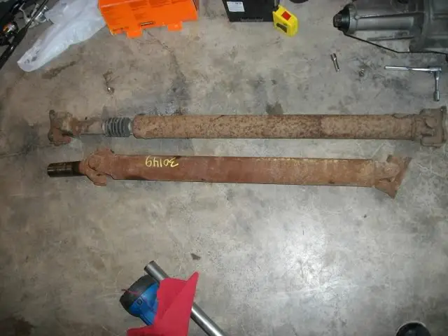

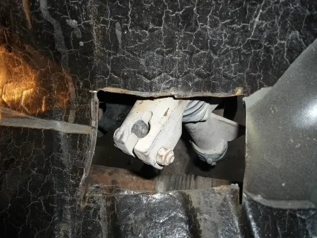

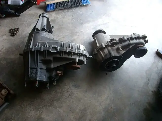

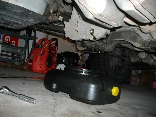

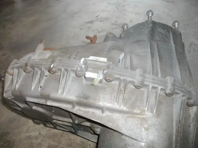

Well now that I finally have the driveshafts for my 4406 they just had to go in, the only bad thing is still no shift linkage.
After starting this it definetly turned into one of the hardest things I have done it faugth me the hole way, the body lift was way easier along with the engine teardowns I have done.
Picture time
Driveshafts
Cover under center console
draining the 4404
broken extension from removing the rear driveshaft
cases next to each other
tabs ground off top of case
4406 installed
slip yoke sticks out a little far for my liking
I didn't get any pictures of when the gas tank needed to be dropped but what a pain it took forever to get everything moved far enough apart to get the 4406 up in there. The exhaust ended up being the biggest pain the stupid rear cats kept getting in the way. The front driveshaft isn't installed yet since I still need to change the u-joint on it. Hopefully a junkyard will finally be smart enough to realize what a manual transfer case shift linkage is soon so it can actually be shifted from inside.

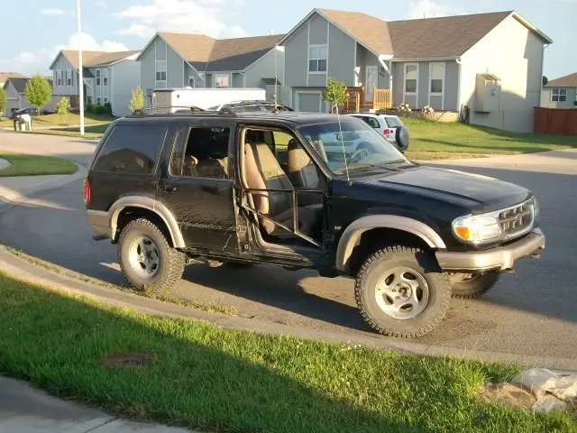

I finally got the curage to take the doors off, man I forgot how much fun it was. Hopefully within the next few days there will be some tube type doors on, more like angle and square but still better than nothing.
yellowford
September 2, 2007
918
Gardner ks
97 xj
Been rocking the tube type doors for a few days, it is getting a little annoying with how many people ask where my doors are at or what happened to them.

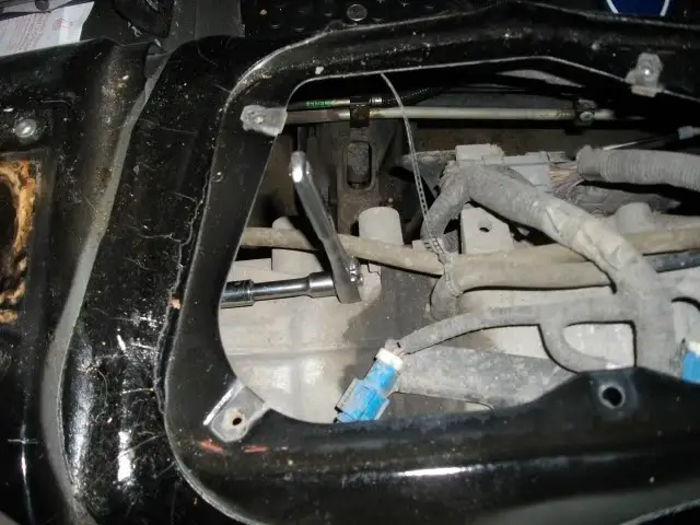

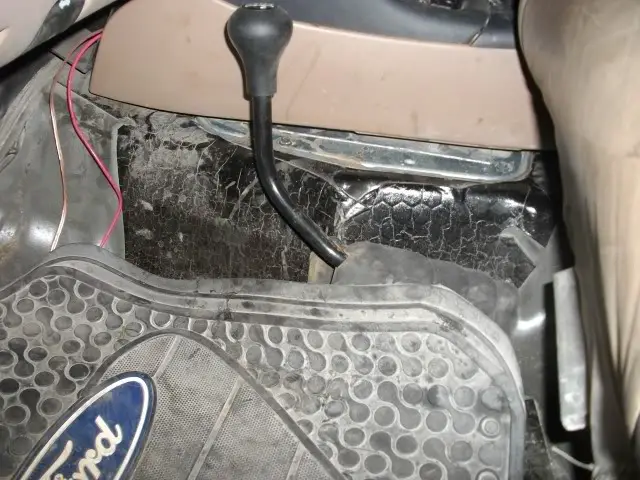

Well it has been quite a challenge to track down the correct shift linkage for my tcase from a 97 up F150.Next step was to try the dealer, how about $247 for all of the necessary parts, no way is it worth that much. So what did I do, the next best thing get linkage and shifter from a 96 F150 and guess what everthing works, the only modification required is to drill a new hole in the linkage shortening it up and cut off the excess past the new hole.
This makes me kind of sad since the cool Ford floor mats will have to be trimmed.
The shift nob, think its a little different than the shifter most use since you have to push down to go to nuetral then 4lo.
Shortened linkage
This makes the only thing left to do before SMORR, is to get my skid plates put back on.

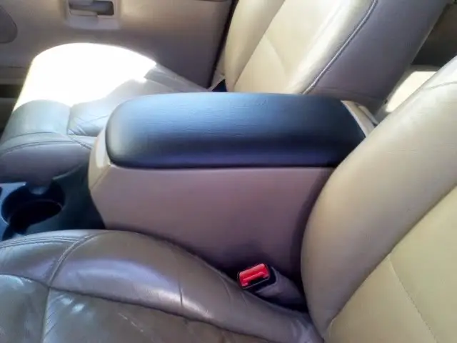

Time for a little update, finally got around to herculining the interior and redoing my armrest with new vinal. Decided to put the rear bumper back on, buy a different front bumper and put the running boards back on. The reason for all of this to possibly sell the Explorer, main reason costing me way too much in gas (close to $400 in the last month) plus wheeling my dd is not going to last long since it has to get me back and forth to school.
