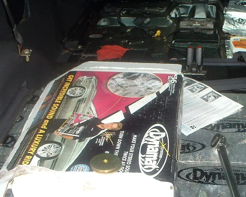

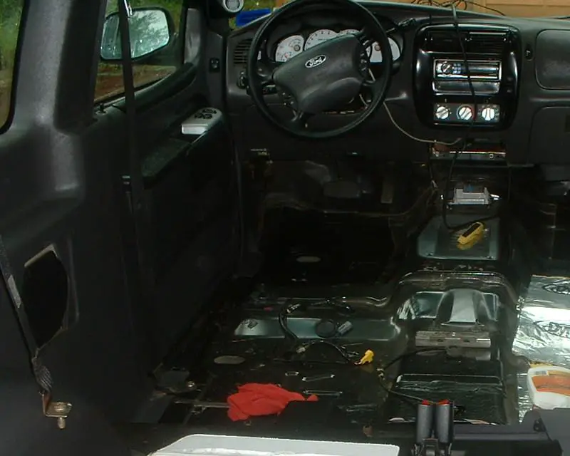

Oh, and I just finished the body mounts. I used the prothane kit for a 98 explorer. They fit good. I'm now installing dynomat and new carpet. I'll get's some pics.

Well, I've removed 120 pounds of seats and around 40 pounds of OEM carpet. THe center console is probably 30 pounds. That brings the total to 190 pounds lost. Then adding the dyno mat in brings it back down cuss that crap is heavy but I like a "smooth" sounding ride.
