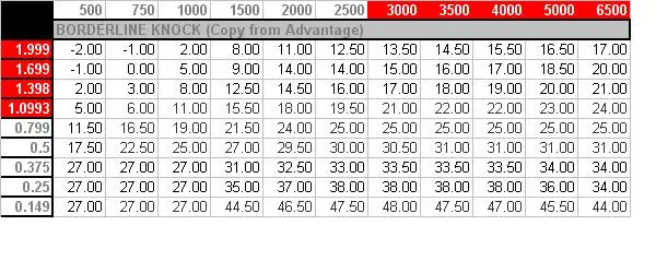

I'm still playing with timing and things and just recently figured out why, when renormalized the BK, I didn't idle right anymore. The load value down low was right at the load I idle at. When the PCM went to the next line (back and forth) the result was Idle surge. SO, I learned to make all the timing the same on the bottom two lines at 1000 RPMS or less.
