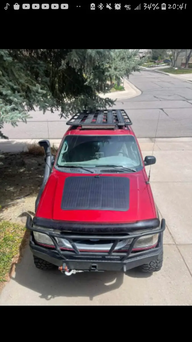

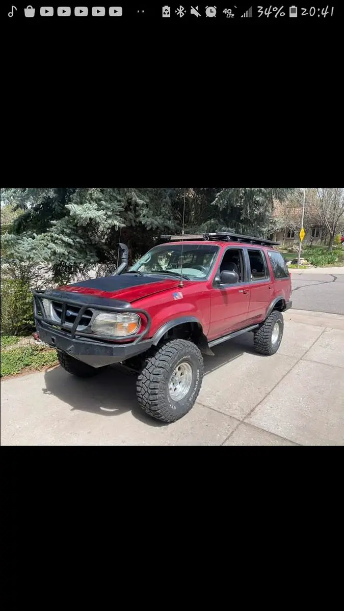

Okay, second try at this, since the link won't work. Finally found that original X I mentioned with the hood solar panel. it's a land cruiser 100 series, 100 watt panel according to the post
Screenshot_20220726-204119_Facebook.jpg Screenshot_20220726-204116_Facebook.jpg

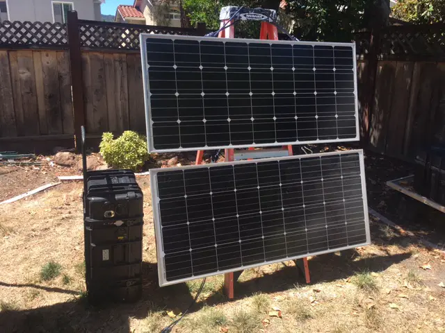

A burning man camp asked me to build up a system for them for use there. It is kind of an interesting group that goes to BM. I don't really fit in but it is a good environmental test of my power systems since they need to work in difficult conditions.
Not quite finished, but this is the current state of things. 2 more panels need to go on the back of the ladder and a few other details.
View attachment 432151 View attachment 432152
