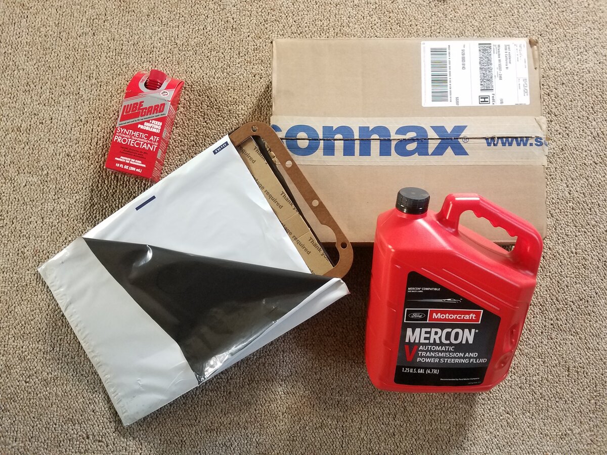

Today is the day! I am about to install the Sonnax VB, Motorcraft filter, and Duraprene gasket. Hoping this finally gets me back to five gears.
I'll let y'all know how it turns out this evening!

After an afternoon of installing the VB, realizing I was cross threading the manual valve detent spring bolt, removing the VB, chasing the threads (and cleaning out the hole), and reinstalling the VB, I got everything back together and filled.
Much to my dismay, I still have no 2nd or 5th and P0761 came back. The only things I know I messed up were installing the dirtier filter of the two I had (got them mixed up) and I overfilling the fluid a bit.
I'll probably drain out some fluid tomorrow, but I'm not expecting the overfill to have any impact on the issue I'm seeing.
Anyone have suggestions? I'm really at a loss here. With a new VB, new solenoids, new servo piston, and properly adjusted OD band, what am I missing that could be causing this ?
