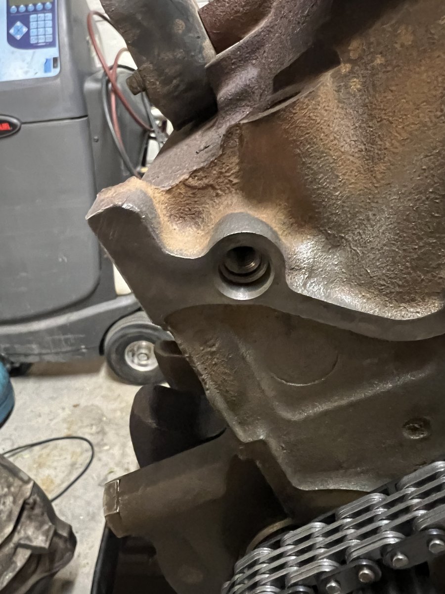

So far everything in this engine looks good. Just need to rule out an issue with the goop I saw last night.
Well shoot, where did my dowel go??

I bet you that ****tail was mixed just from the dis assembly. Did you look in the timing cover for the dowels
Yeah.. so I ordered a set of dowel pins from amazon, then noticed the dowel fell into the box for the new timing cover after I test fit it...whoops!
I hate those locating dowls
You could leave them out, they aren't critical. I'll be leaving out the dowels in the back of my block when I do the trans swap; those are more important.
I'll be putting on the timing cover and water pump before the oil pan since it's on the engine stand. I'll use the dowels just to keep it in place at this point.
I think that's the main purpose of the dowels, to line up the timing cover to the bottom edge of the block, so the oil pan seals right.
