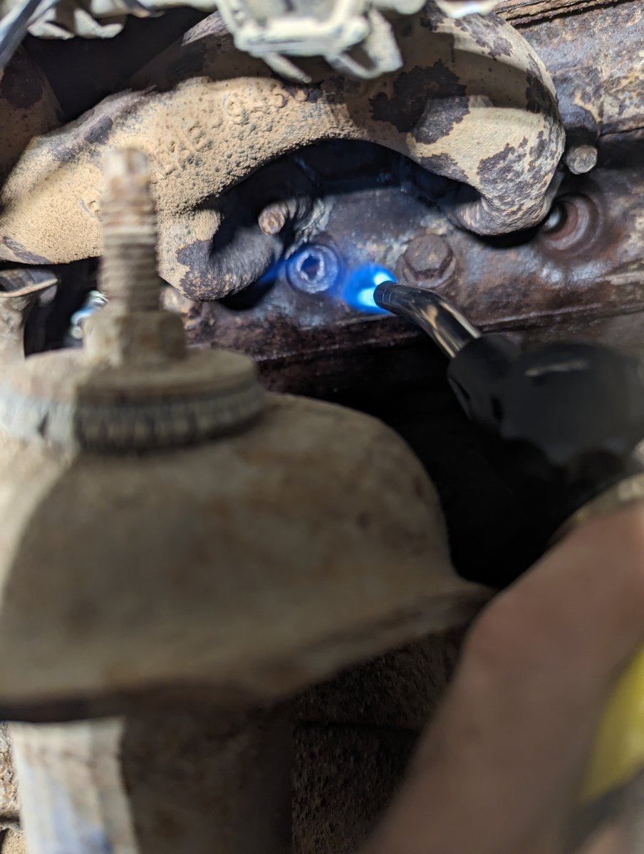

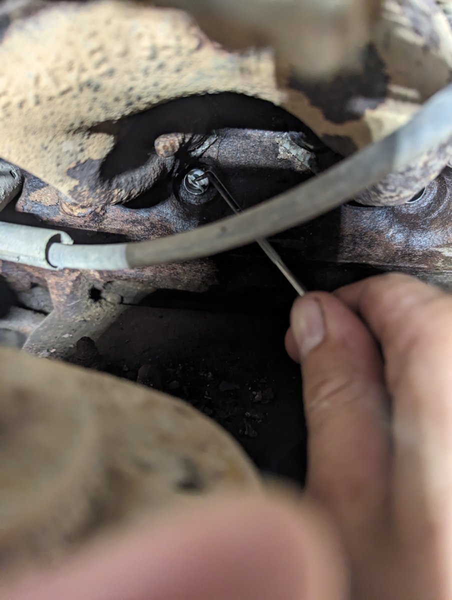

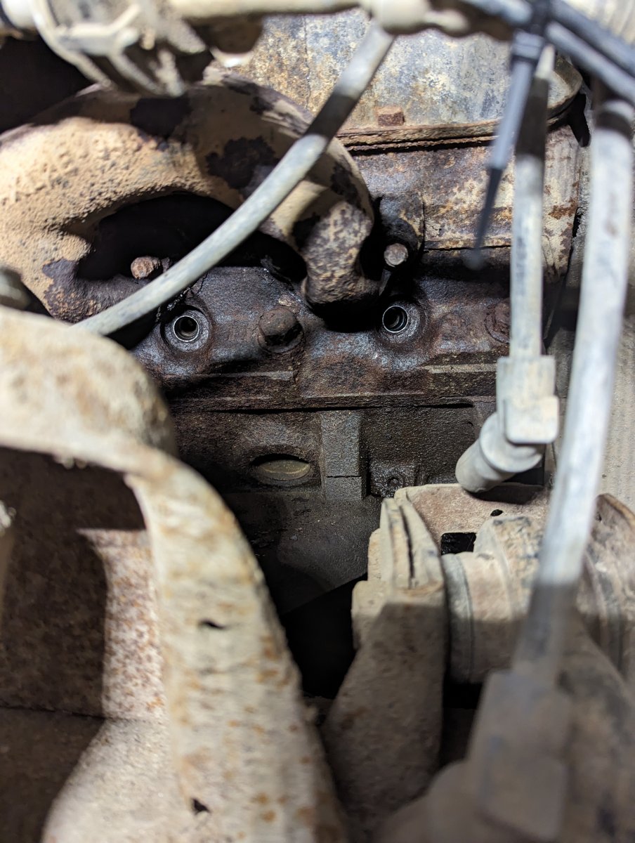

So how'd I do it? I could tell you all the things I tried first, but what finally worked is all that's important. Lucky for me (sarcasm), I had two plugs broken and for the first I had to experiment to find the right technique, then the second was validation that the method worked. Here we go!
Get the porcelain out first. One came out with the shop vac, the other had to be chipped at with a pick first
Now all that's left are steel shells
To help the penetrant creep in more and maybe break up some of the corrosion, use a small punch and hammer to mushroom the exposed edge of spark plug shell inward. The scrape away crud around the shell, vacuum said crud, and liberally apply penetrant where you just opened a slight gap around the shell.
As you guessed, next step is to heat it up. Let the penetrant wick in and get the metal bits all expanded. Heating the surrounding head is not a bad thing. Once it's all nice and hot, quickly shut off torch, grab can of freeze off and spray just the metal shell -- this will cause it to contract and hopefully separate from the head.
Now's time to stick in the extractor of your choice. I didn't feel like driving to HFT, so I bought a very similar kit to what 410 posted at Walmart (was omw to my son's daycare) for ~$13. I've seen DIY extractors made from ground down bolts work just as well. So whatever extractor you have, tap it in and find a socket that fits the back. Start turning.
If you're cranking so much you start to see the torsion (aka twist) building up in your socket extension, I suggest stopping, backing the extractor out, and doing another round of penetrant, heat, freeze. Eventually, you'll get that bugger free I swear. Patience is key.
Once it's out, vacuum out the combustion chamber as well as possible
I'm also leaving my new plugs out overnight so the penetrant and freeze spray residue can evaporate more.
But that's it! This honestly isn't a terrible job, just a bit trickier that the average broken bolt.

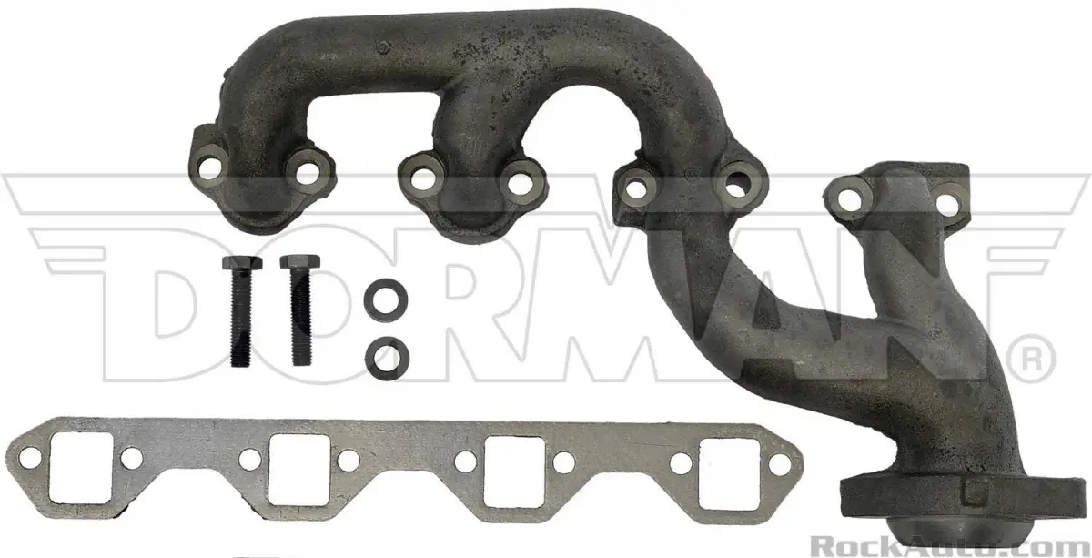

The exhaust (starting at the headers) is notoriously restrictive on these 2nd-gens as you know, and just sucks the life out of the motors... which is why you started there, I presume!
While I understand the strange tube routing due to the tight space, I was surprised to see how much the tubes are "pinched" right at the exhaust ports in order to get better access to the mounting bolts:
On the plus side, I'm guessing the stock manifolds are easy to take off.
Compare to cast LS manifolds though:
It makes you wonder what the Ford engineers were thinking when they made the bolt holes so close to the exhaust ports instead of spacing them out like GM.
It still baffles me that there aren't more header options given the popularity of Ranger 5.0 swaps. But these are the things we Explorer enthusiasts must contend with...

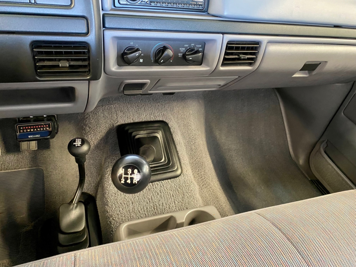

One item I passed on yesterday was the older style transfer case shift lever and I'm wondering if I'll regret that. The yard wanted $10 for it and I already have one for a '96, but I'm not sure what'll work best. To: anyone who has followed 4406M conversions, which lever fits better in a 2nd gen Ex?
'97 and up:
'96 and earlier:
Thanks!

I also looked more into the t case shift lever and realized the two lever styles aren't directly interchangeable. The older ones mount with two small bolts while the newer levers use one bigger bolt and a "forked" end that goes over a pin on one of the linkage arms. I may go ahead and grab an older lever anyway so I can mix and match/hybrid something that looks and works well.

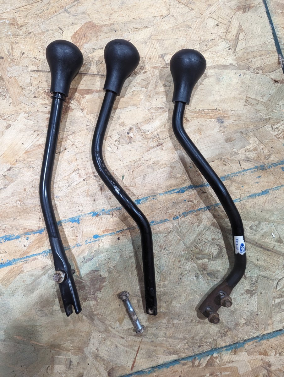

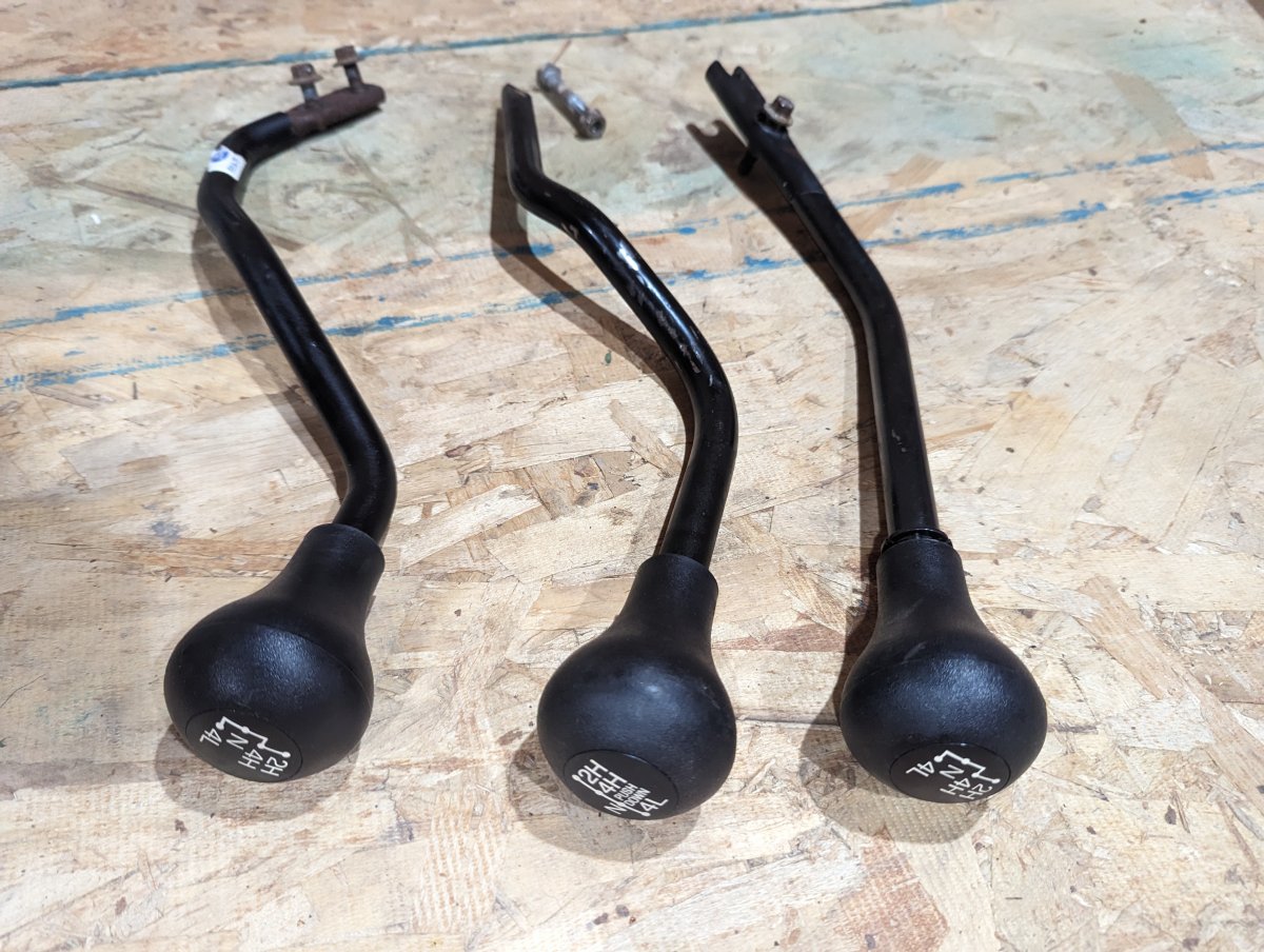

Picked up other odds and ends too including clutch master cylinder hardware and more transfer case shift levers. I got two more and both are different than the one I almost bought last weekend:
Left to right: '97 F150, aeronose F250, first gen super duty F250. I seem to remember the lever I pulled from the bricknose was a similar bend to the areonose lever, but the mounting configuration was totally different. It'll be good to have some options once the 4406 goes in.

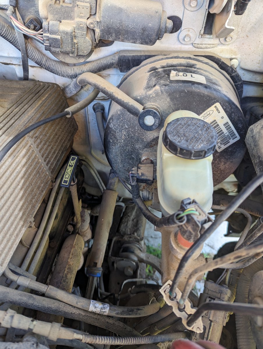

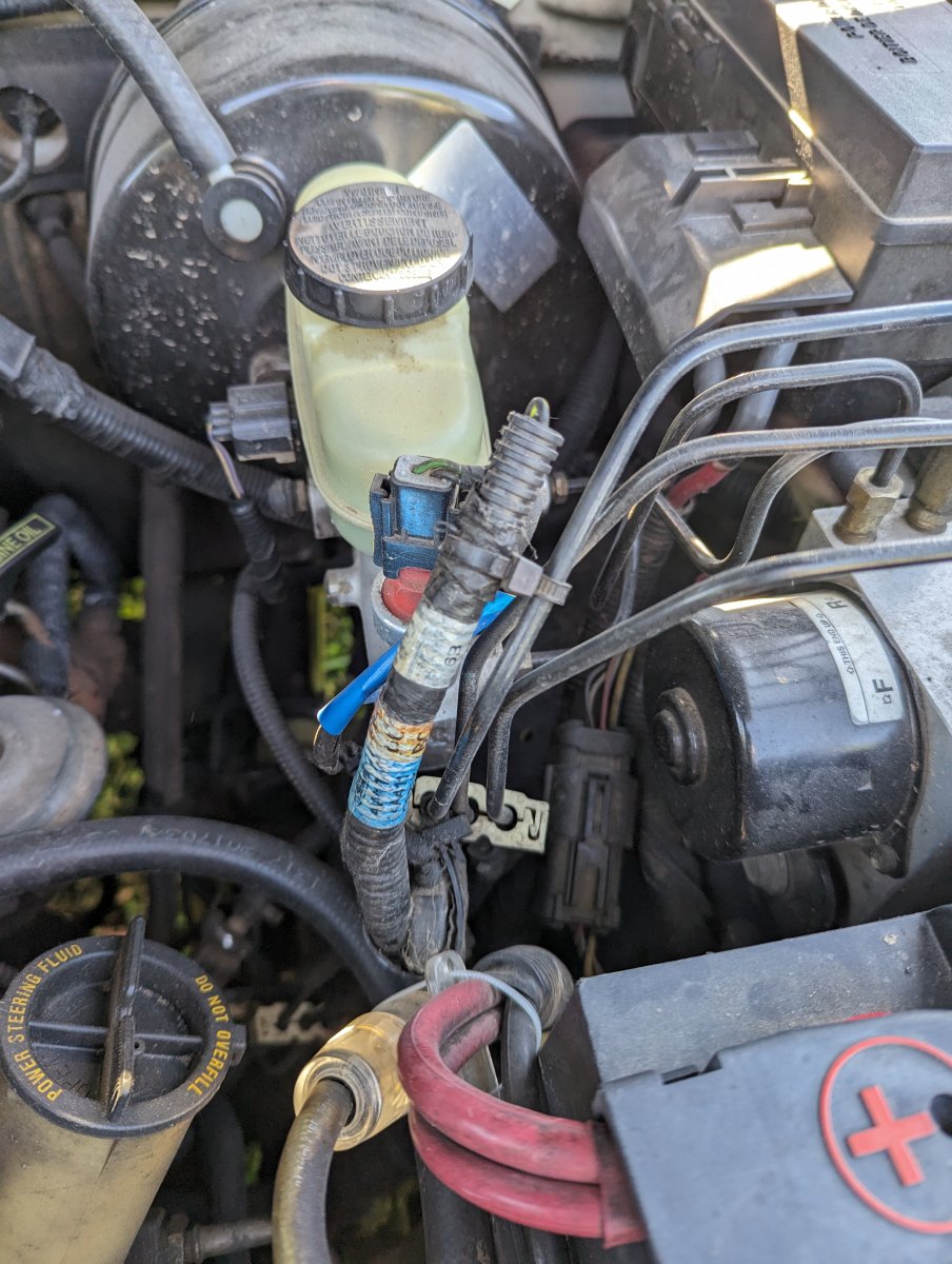

I also realized the Mounty never had the jumper harness fuse recall thingy installed so I grabbed one of those too.
Here's the jumper harness on my Sport (my 97 XLT had it too):
Missing from Mounty:
Good score, it's great to collect a lot of extra parts from the JY.
FYI, that brake recall harness, it is just an inline fuse, you can add your own to any brake sensor like that on a MC. That constant current there is dangerous if the sensor was to leak(the recall was because those OEM sensors began to leak, which caused the short, and possible fire).

4406 shift lever I’m using the 97 f250’style
They can also be heated up and bent if needed or chopped cut and welded, we have extended them a time or two and shortened them also, just depends on user preference and the vehicles it’s going in
The 97 lever I’m using is perfect with the 2” body lift
