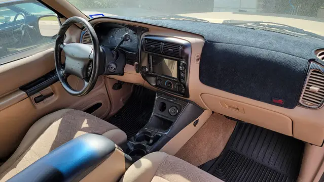

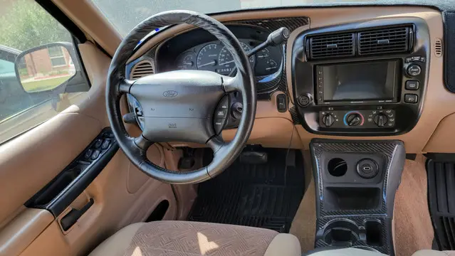

Got the bezel/radio back into the truck. Looks pretty good, everything snapped it and I don't think any of my repaired clips broke (yet.. maybe once removed again, lol). Overall improvement to the interior and my list of reasons to not get back working on the ac keeps shrinking, LOL..
Ignore the big hole in the lower center console.. it's for my new wideband that I need to wire up and install so I can maybe get an updated remote tune one day, lol. The hole next to it used to be for the boost gauge from the turbo glory days but I bought a gauge hole cap and then opened it up and added a usb port for the Android auto/Apple car play :D

Thank you! Yes.. turned out pretty good. Now I can't keep putting off the air conditioning and trans fluid work much longer, haha.
Yeah, my steering wheel is pretty beat up. Are you selling your wheel? You have a nice wheel just like the one I have already but in better shape? I do need to swap the cruise control buttons (again)... somehow the new ones cracked almost immediately when I let my wife's dad borrow the truck for a few weeks years ago. I have a new set of buttons laying around somewhere, lol.
