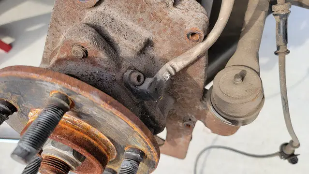

Wheel hubs are replaced... ABS light seems to be gone and brakes much improved :)
Looking at the old and new wheel hubs the wheel speed sensor DOES look to be replacement with a single allen screw. The sensor itself did not appear to be specially sealed or anything as I was able to remove the allen bolt and pull the sensor out of the hub that I removed and it looked kind of grimy but nothing crazy.
Old hub with view of the speed sensor:
Old hub prior to removal:
New wheel hub installed:
Cleared the codes and drove it around about 10 miles or so... all seemed good to go. Drove up to Buc-cee's gas station and fueled up with some fresh gas:
Re-ran codes after my drive to see if anything popped back up... ABS light still off but am still getting a P0500 Vehicle Speed Sensor "A" Circuit code (but no longer a front left wheel speed sensor code).
