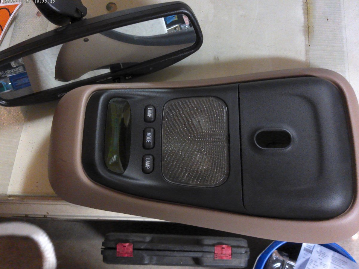

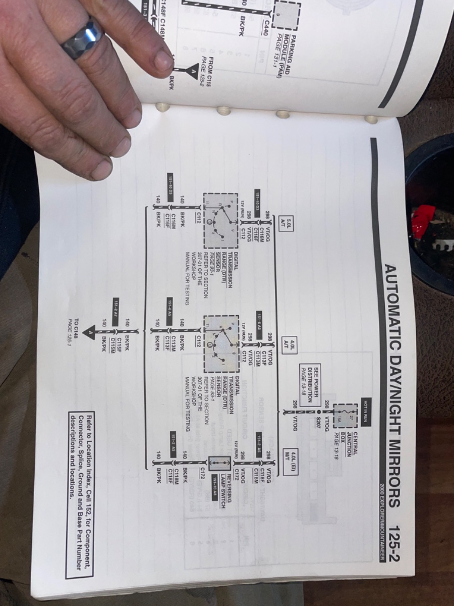

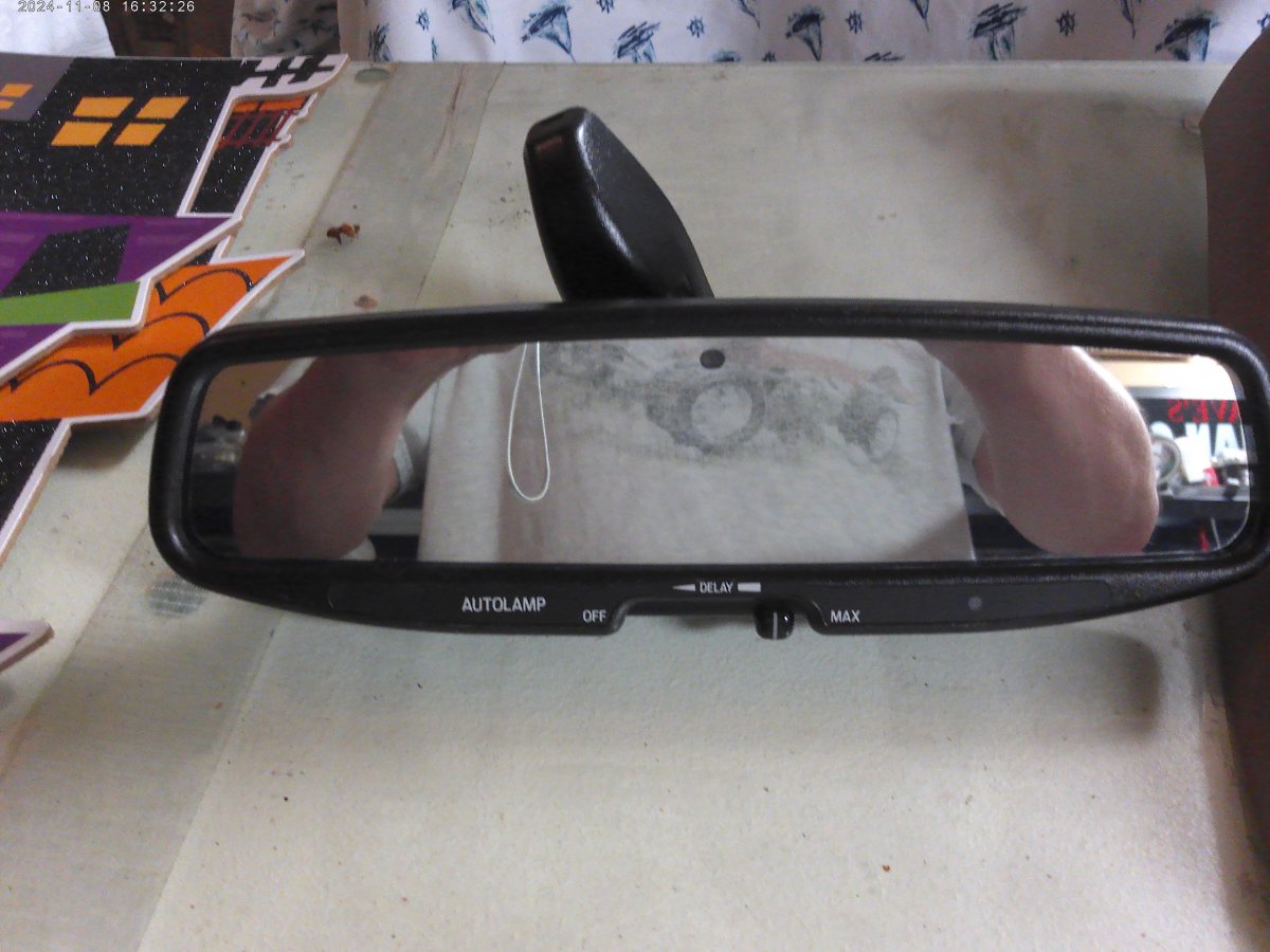

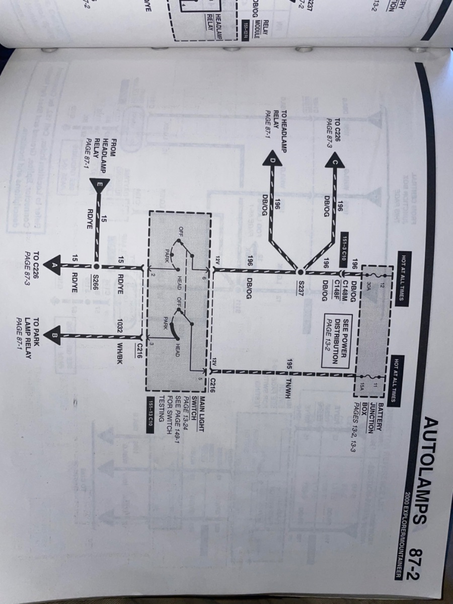

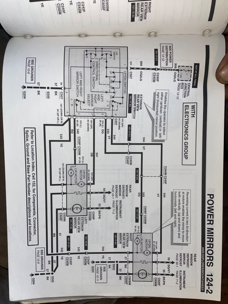

The overhead consoles… getting harder to find a good ones these days! I know some dudes repair them but I just go to the junk yard (out back) and replace with a good one. What I found is trucks with sunroofs often have overhead consoles that the display is burned out… non sunroof trucks, display works
You get really good at taking them apart and swapping bits
I’ll get the auto lamp
And mirror working posted
That’s like the 5th time this morning my phone has replaced the word wiring with working… trying to tell me something? Smart phone my ass!!!!
