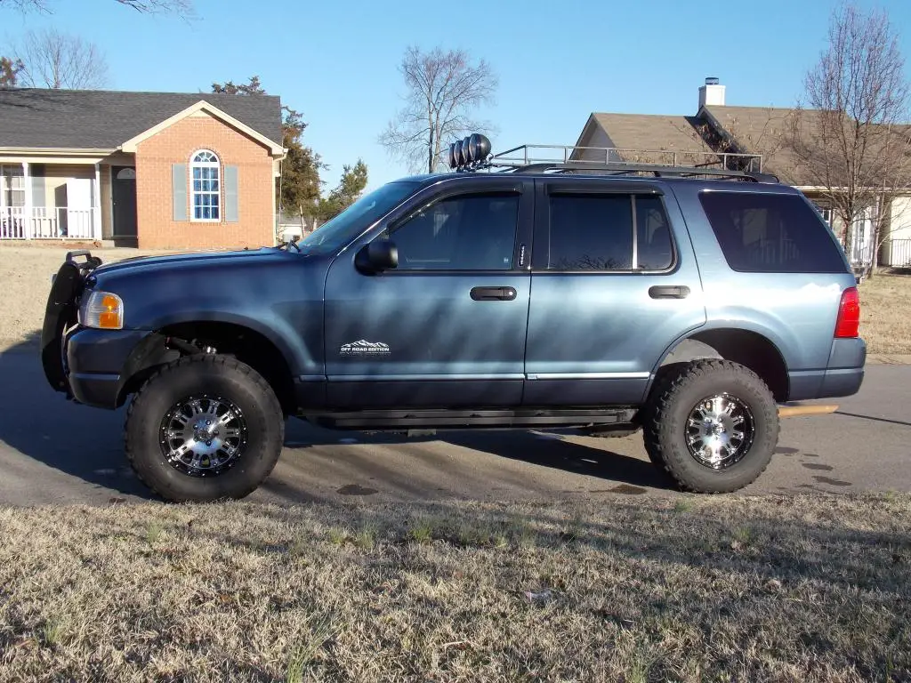

Day 3 after the install and I loving the coilovers. Way better ride, and better flex. I highly recommend this to any one who wants to do this. If anybody as questions, just let me know. Only thing I have left to do is a limit strap, and I am changing the coils to 750lbs.

Thanks Corkey. One week and still loving these! Waiting on my new springs and limiting straps to come in. Plan on going to Coal Creek(Windrock) to do some wheeling in Feb. to really test these out.

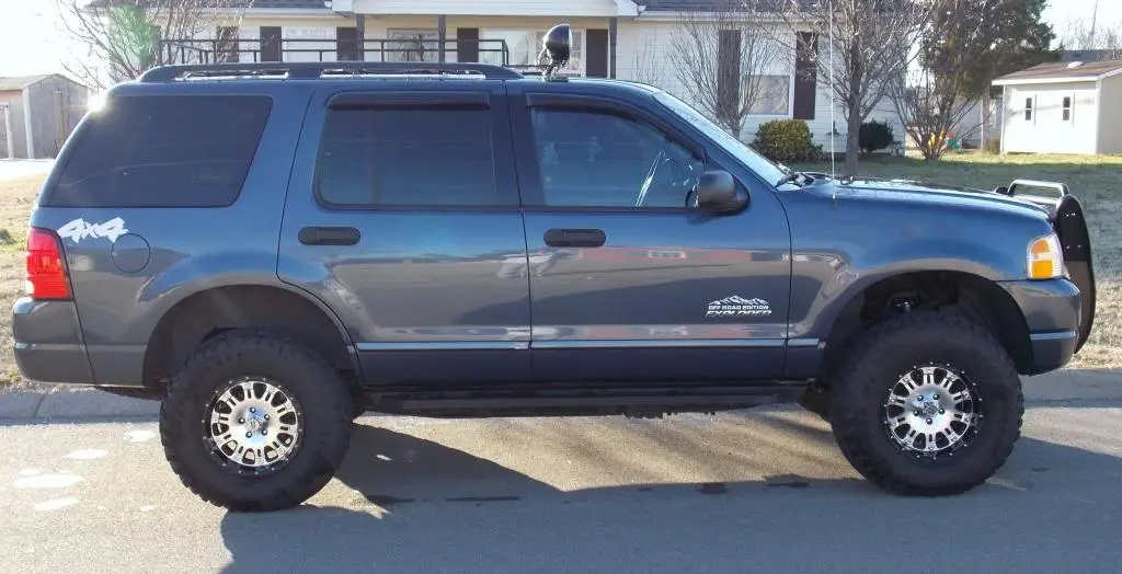

Alright got the 750lb springs today, much better. Need to drive some more and then adjust the preload. Right now I am at 38.75" Front, 39" Rear.

Yea I got the PAC racing springs only come in the orange. We always say we will not modify, but then before we know, we are doing mods and planning more.

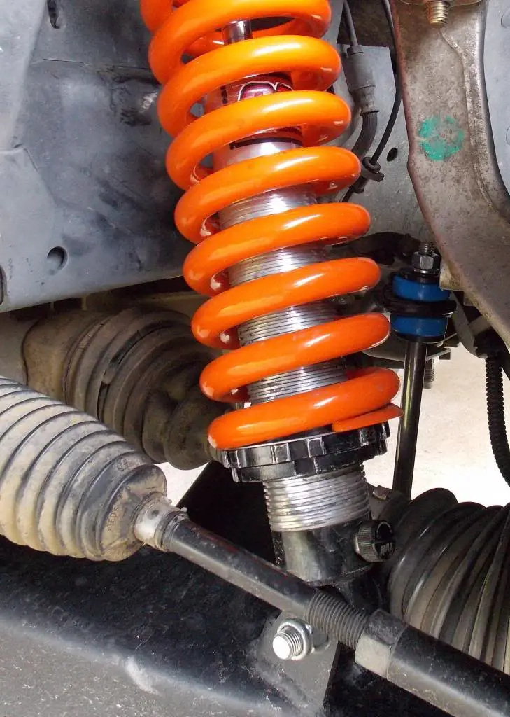

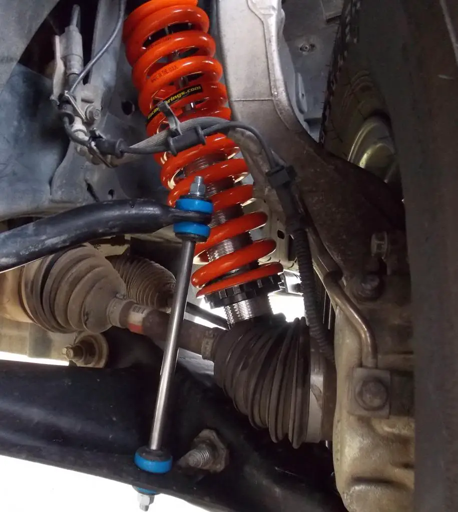

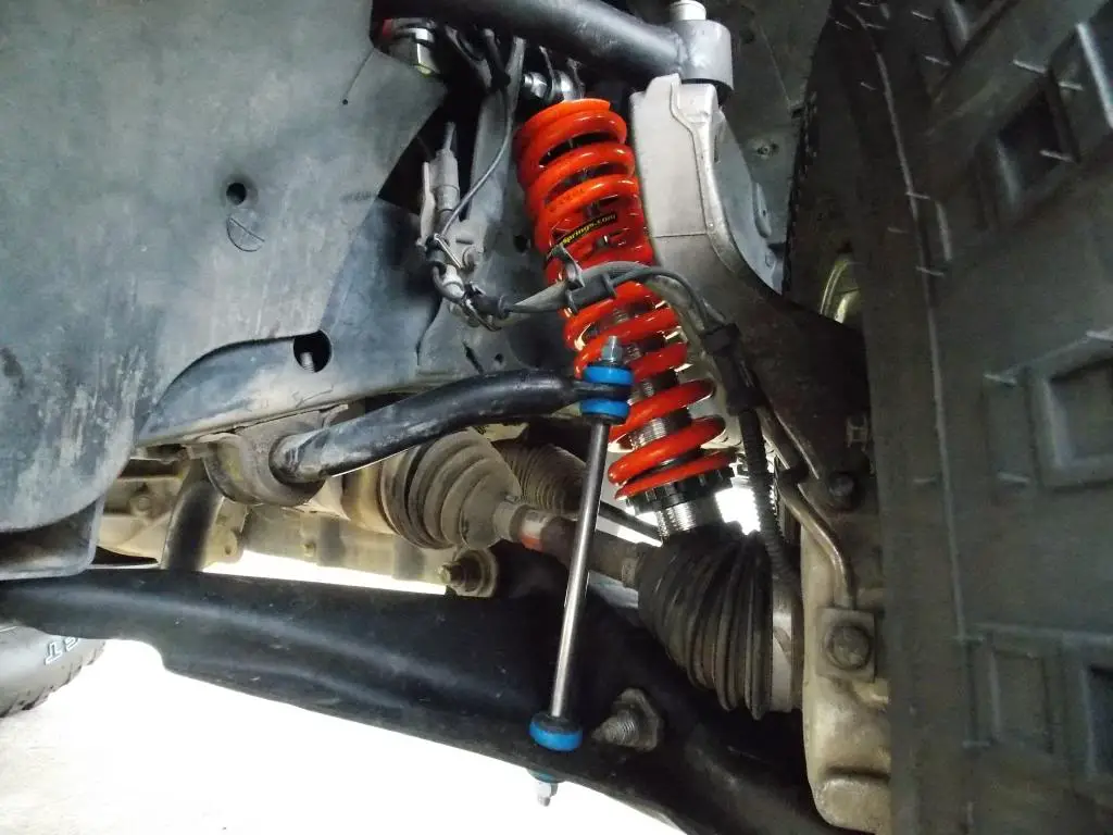

I made some extended sway bar links to today and installed them. I adjusted the preload on my drivers side to get both sides even. I am at 38.75 front and rear. I have 13" clearance front crossmember and 13" at the frame. Here's a couple pics.
