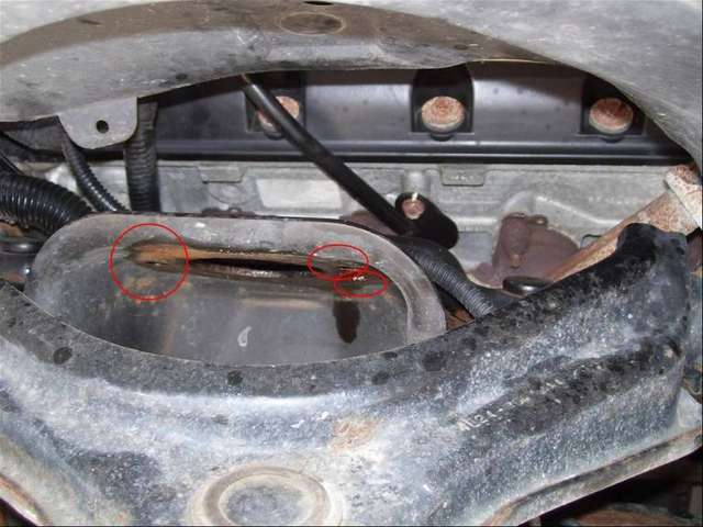

Well after long thought out process, I am going forward with this. Hopefully get started soon. What I am going to do is box in the the lowe control arm in the places I have marked.
