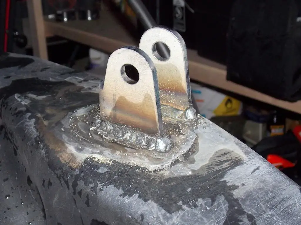

I changed my lower mounts, didn't feel comfortable with just the tabs. So I got the ones that are 1 piece. Here's a couple pics, should be installed next week.
Looks good so far rangermidtn... excited to see this project progress!
Good idea.

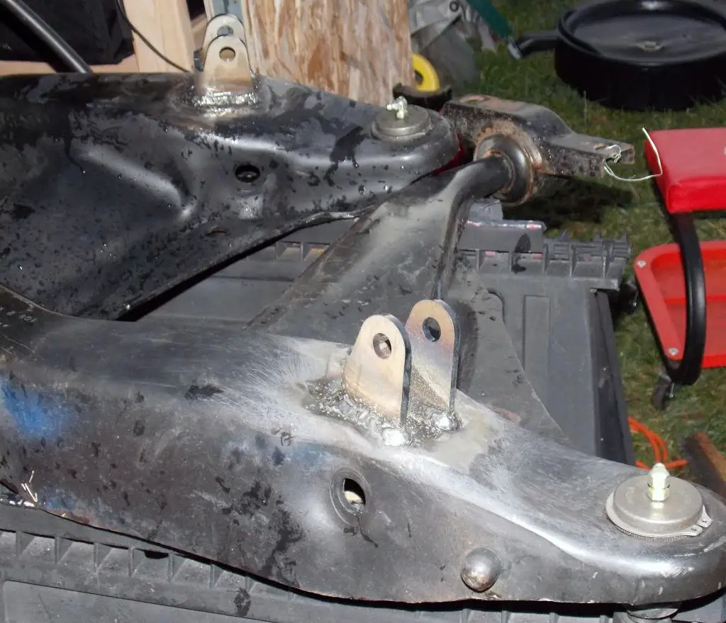

Bad news, due to the shape of control arms, I am having a lot of trouble with this. I was installing one side today, but just could not get it to align the coil over. I measured from the original holes for the new mounts, but still having trouble. Well back to the drawing board. May have to redo the arms, or get some one to make me a set for coilovers.

When you were designing did you take into account that the lower control arms will be angled downward from the stock position? Basically you can't go straight up from the hole (with the LCA laying flat) and put your tabs above it.
If you angle the control arms to where they will be at ride height with the coilovers, draw an imaginary line from the existing strut mount hole to where your upper coilover mount will be. Then position your lower coilover tabs on top of the arm so the holes are centered on that imaginary line. This will mean the tabs are further inboard on the control arm than the original lower strut mount holes.

Thats what I did. I measured up from the stock holes, made sure my tabs where they same measurement on each side. I used a little angle to get the right angle. I'll try again just need to think it over and see what I did wrong.

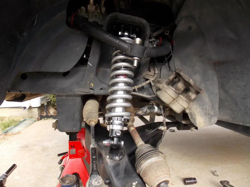

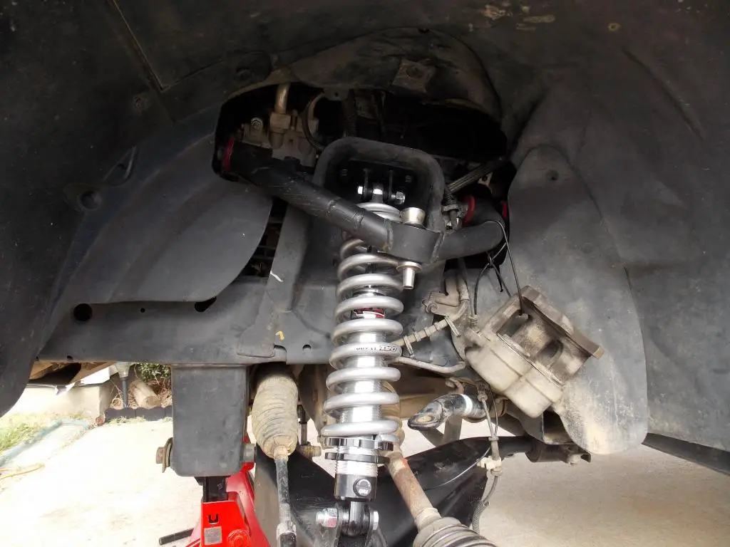

Alright I got these on today, everything fit great except one thing, the cv was rubbing against the new tabs. So back to the drawing board, I am not sure what I am going to try to do.Here's a couple pics of what I had done.
It looks awesome. How bad are they rubbing? Is it just a matter of slightly adjusting the tab location? Does it rub on both sides?
Boot is rubbing the new tab I welded pretty good, would tear the boot fairly easy. I think what I am going to do is move the tab out farther. This means it will run straight with the arm, I am not sure if I can do that, I know the coilover will turn easily to let me do this. You can tell by the pic how it would rub, the cv would run right ove top the lower ball joint.
