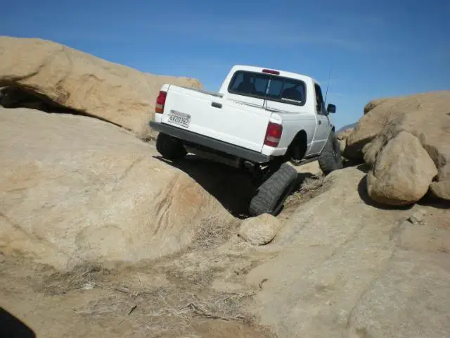

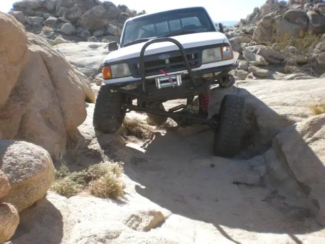

Moving the upper link to the lower link would be possible however the tabs on the axle might be welded at the wrong angle. To do the radius arm style you need to use bushings at the axle ( i think you said you were anyway). Radius arms will continue to eat bushings due to the bind in the setup. I think three link is better. Not sure how soon you plan to start but I bet you will be surprised how well 90ranajo setup is going to work. Here is my my three link flexed out. I still had about 1-2" of up travel and about 3" of down. My truck will fit in my garage that has a standard 7' door. I could also go to 37's and still fit.

Nice flex indeed. Where do you have your top link connected to?
Inside the driver frame rail between the fuel filter and tcase. If I remember right my upper is 34" long and my lowers are about 36". My upper is 1.75x .120 tubing. lowers are 2" square. I will try to get better pictures this weekend and post them up. Once figured it out it is not that hard. Not sure how it will clear your V8 though.
