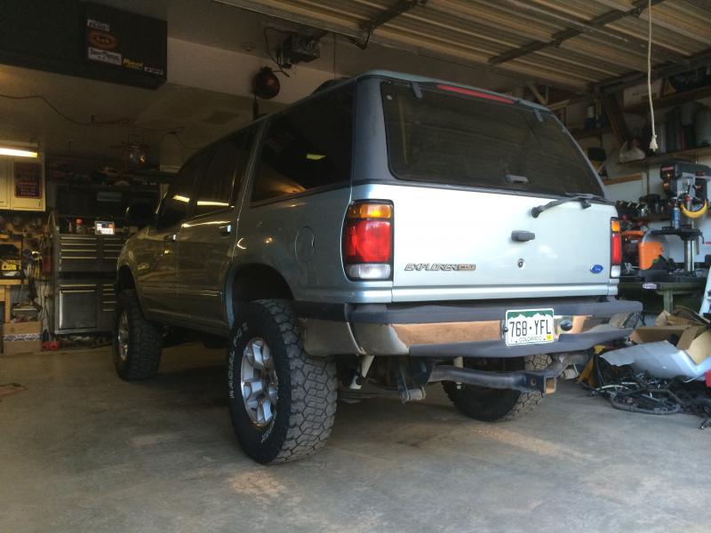

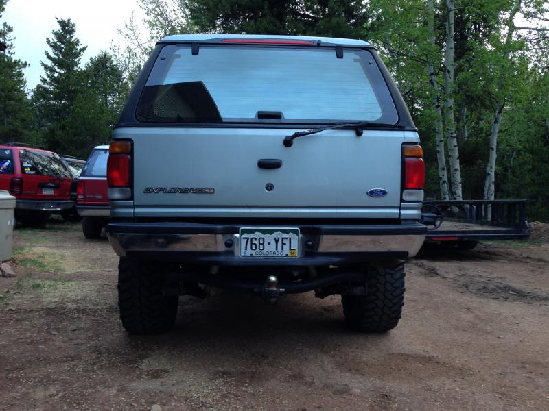

Here she was when I sold her, what a BEAST of a truck
96, 5.0, E303 cam, 1.6 RR, TMH, Intake/2.5" single out exhaust, 4.10 L/S, 4406m 4x4, torsion twist/shackles, 3" body lift, 16" Ranger wheels, 35" tires, Charcoal interior swap

I spy 3 Explorers in this pic. lol

Also in that pic is two explorers and a Mercury mountaineer LOL

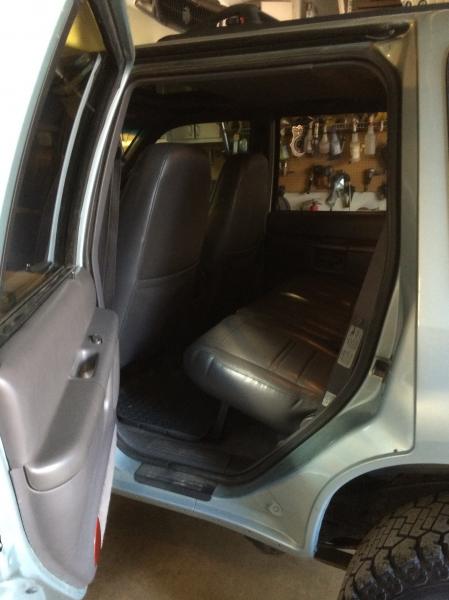

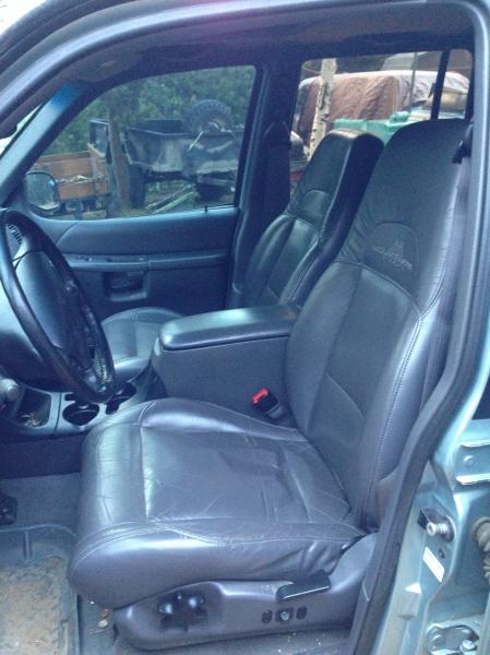

More pics of the old 96
No more "wedgewood blue leather"
They look “so-right” with 5-6” lift.
