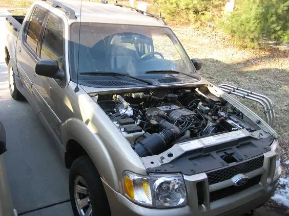

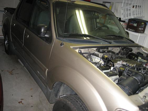

I will be building a web site to show what I did, in time. I just wanted to share a quick video and some pics to show that my ST is alive. Please forgive the bad pics and video. It was already dark when my battery finished charging on the camera. I wanted to at least get one shot showing it really was a Sport Trac though. ;) I still have to shorten a couple of wires, finish figuring out the vacuum lines and some other things, but it was nice to hear it run today.

All 5.0 parts came from a wrecked 96 Explorer that I purchased and parted. I am so glad I did it that way. You would be amazed at how many parts you need.

Also I can't believe how low that thing sits, they're much higher in the explorers.
hahahhaha... Part of that is due to the 4.0, trans, and the old transfer case being in the bed still. My garage is a little tight with all the stuff I have in it.

OH...Yes. The frame is the same up front and I am using the same motor mounts from the 96 Explorer. Plenty of room for a Kenne Bell, it looks like. :)

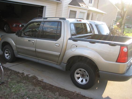

I didn't have much time to get it posed for pictures as I had to clean the garage to make room for the 4.0 stuff that came out of the bed. I am attaching two shots I managed to snap though.
