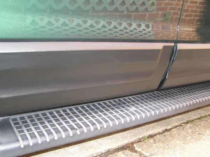

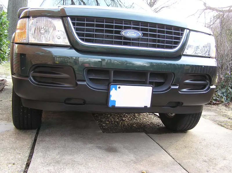

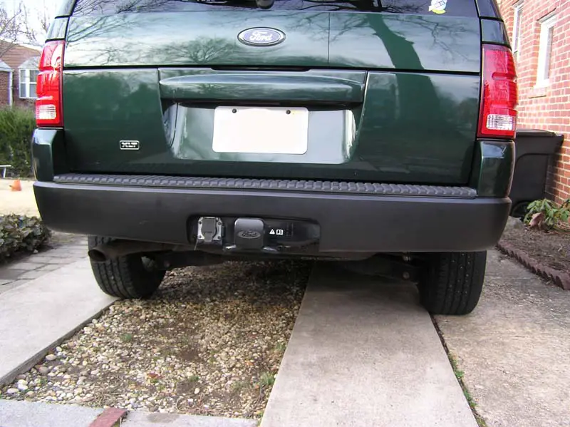

WARNING ....not so thrilled how this turned out.
I thought I would try this but had some reservations based on the packaging yet like a dolt pressed on. The package says last up to 6 months (Huh? I thought this was one and done) and oh by the way it is to RESTORE black, not turn grey to black. If they had something like Restore GREY I bet this would be a different story.
IF you elect to do this buy two bottles, also buy the foam brushes. I bought a couple of sizes (.50 each at walmart) and way better than the applicator. The applicator is huge and will drink up half of your bottle of product. My wife and I spent about 1.5 hrs putting this on the plastic; around and around we went. I did the bigger surfaces and she did the edge trim and crannies. It does dry fast but it needs to be dry or your next coat will remove some of the product.
The first coat was awful, grey was showing through and it looked like hell. As I applied coat after coat, things got better. I'm still not 100% satisfied with the job. I will buy another bottle and re-apply next time the weather permits.
I only put this on the grey trim, I didn't have enough to do the black running boards and flat surface on the back bumper. I did do the thin black deflection shield waaaay under the front bumper. It worked GREAT there as the thin shield is black (remember RESTORE black). With the second bottle I will do more coats on the grey and also do the black running boards and rear bumper.
I think this works fine on black, I am not thrilled I may have to re-apply at the 6 month point (suspect it will require less coats).
IF you can remove all your trim like on our '01 Sport then suggest you take everything off and use Krylon Fusion "Satin" in color of your choice as we had great results with that. http://www.explorerforum.com/forums/showthread.php?t=295131
In the 3rd photo you can see the variations in the black and note the dark black drop that dripped onto the running board. These photos were late in the day with little sun. Trust me it doesn't look this good in full up sun mid-day. My son did mention that it would look really good at night.....love that kid!:mad:
I will add photos of this after another treatment (couple more coats) and I do the actual black trim, and then maybe a few pics at the 2-3 month point.
If you want further details PM me.

Don't be fooled, the pics are from late in the day and look much better now than when the sun was full up on the work. I'm afraid next time I walk up to the truck in full sun in a parking lot I'll call the cops to catch the kids who vandalized my truck!
Let me get another coat on the trim, see how it wears. I will say this, this was cheaper and faster than the Krylon Fusion.
7 Days later, the areas where the Restore Black is sticking is fine, I waxed the truck the weekend prior and I must have gotten wax on the plastic trim, that peeled right away. My plan is next time the weather is good to wipe down the plastic with acetone or rubbing alcohol, remove all the wax and re-apply.
In the long term, I will just paint this on periodically and keep the trim black, it will look fine and way better than the washed out and streaked grey I had before.
If any are thinking of doing this, be sure your trim is clean(LOL) and know that it will take more than one coat if you are NOT starting with black. Also know that re-applying will be needed but suspect it is a 15 min job when you are just doing touch-up.

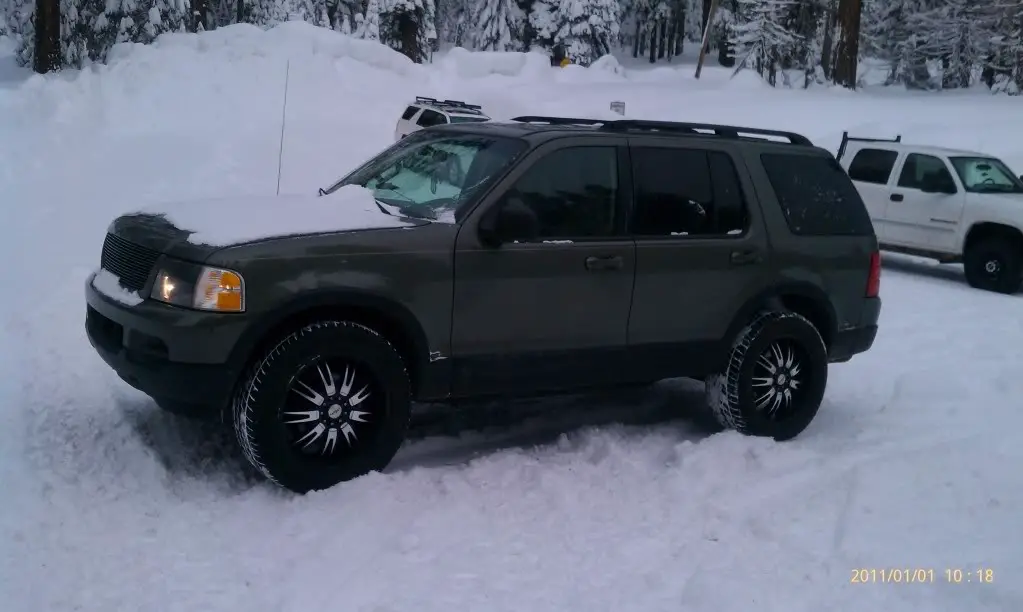

HOW ABOUT THAT TIRE SIZE?? I like the way this explorer sits!! BUT I went to town fair tire and they swore up and down that this would rub like hell so now i'm stuck on what to do. I really want to get the same tire setup. Do any of you guys have any input!? thanks!
Nice to see that this thread is still in action. I completely ripped the plastics off of my old 03 xlt sanded, primed with filler primer, and painted with plastic bumper trim paint. It held up well....
No rubs lock to lock I don't know what else to say
Any recent pics of your truck??! Man i like the way that thing came out lol
Standing by for pics....................................:popcorn:
working on getting more pics and hopefully some kind of video for the guys at town fair tire so they can swear up and down on somethiong else i have the day off tomorrow so i will be working on it first thing i am sorry to those that have been waiting for recent pics
That'd be great because I'm considering taking a little road trip to pick up a set of 275 55 20 tires.
