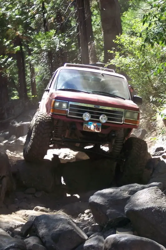

Great flex! You say 12" extended radius arms. Stock arms lengthened or other? Heim joiints at the frame and urethane C-bushings? what is the distance between the radius arm heim joints at the frame/crossmember?

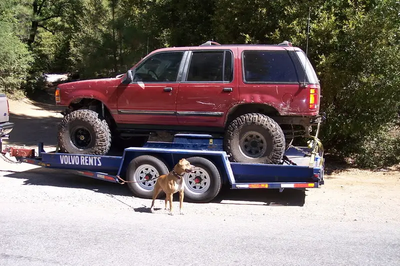

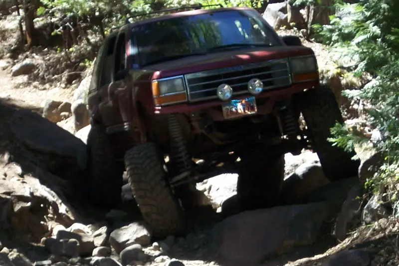

more recent pics. now locked front and rear with 4.88's and gettin the doubler in 2 weeks. also gonna re-do the front suspension with coilovers and high steer. gonna be making a new radius/tranny mounts

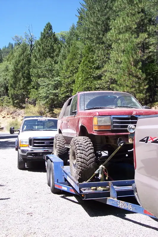

Hey thats an interesting trailer, who makes it? Or where did you get it from?
this thing looks so wide driving down the road.
lol, its a volvo rents trailor, i get them for 20$ through my work, ya its pretty wide. they are fullwidths. i saw your explorer a couple of weeks ago on rocky ridge turning on douglas. i live in roseville.
im out that way alot, my buddy lives right there.
If ya don't mind me askin' what`s the weight of that trailer with Explorer on it.
Guesstimate? -And what are you pulling it with and how do you like it? 1/2 ton, 3/4, 1?
What made you go with 4.88s instead of the 5.13 you talked about?
