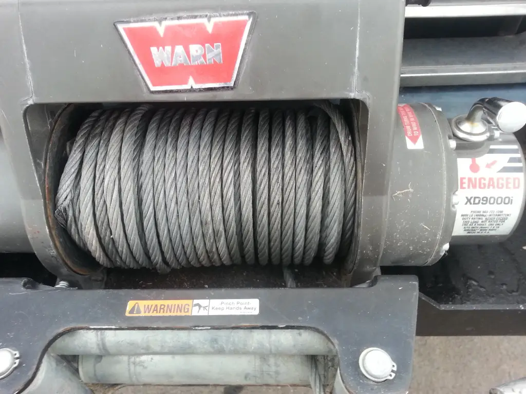

Yeah.... even if it wasn't pinched, that untwisted portion as well as the rust make me nervous.
So, thinking of replacing with more cable or some synthetic plus a winch cover?

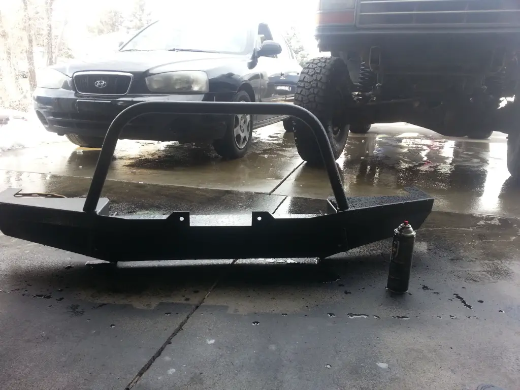

The bumper is Awesome man! As for the winch... would a lubricant of some sort help? Something to make the cable a slick enough to un-knot?

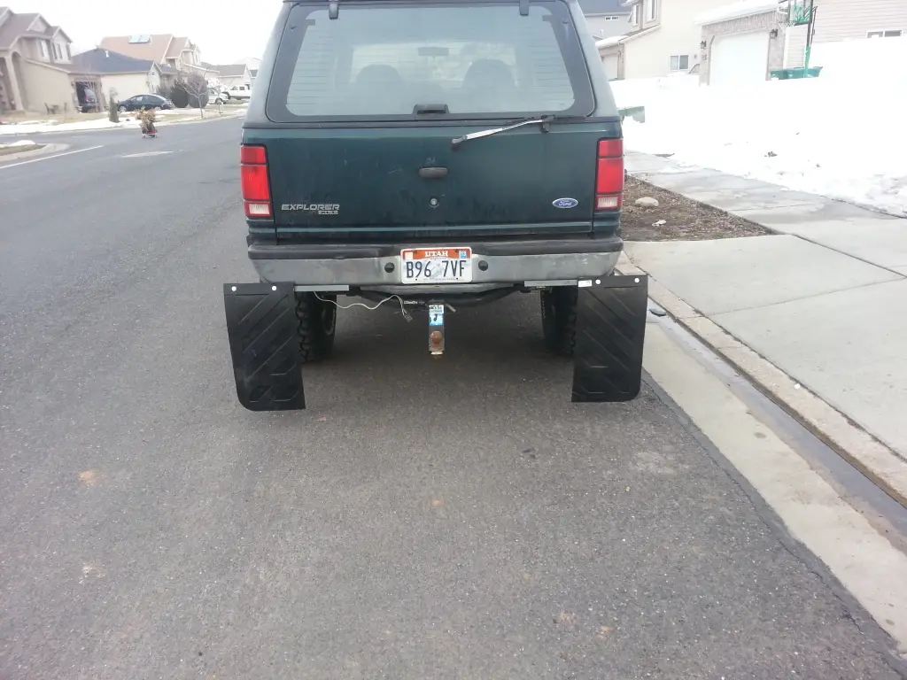

Ok..........I spent the day working on the truck and got a few things done. I was finally able to find a trailer connector harness so i installed that. I also had to do something for mudflaps cause i got pulled over STUPID LAWS........ So here is a pic of the Redneck Setup for mudflaps. Please dont critcize too much cause i know its not real pretty and i dont care cause if it was my choice they wouldn't be there at all.

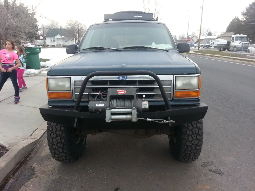

I was able to get the cable unbound from the winch by hooking it to another vehicle and pulling and it didn't take much i was actually quite surprised, and it looks alot better than it did and i feel confident it will be ok at least long enough for the moab trip. Here is a pic of it rolled back up on the winch.

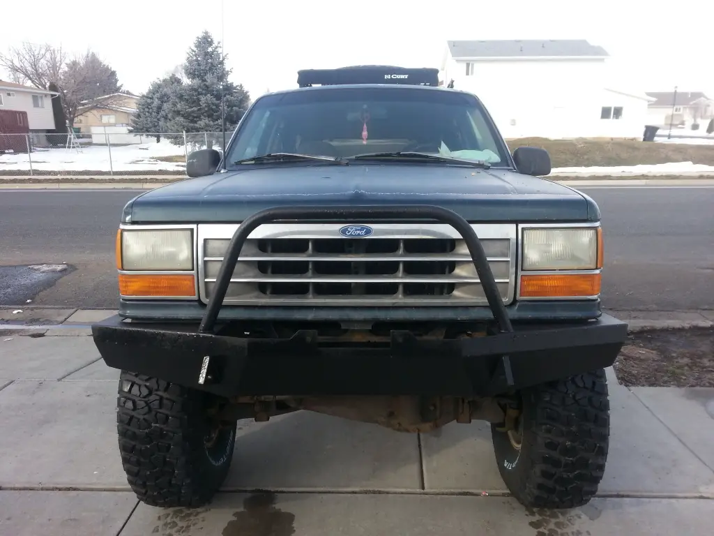

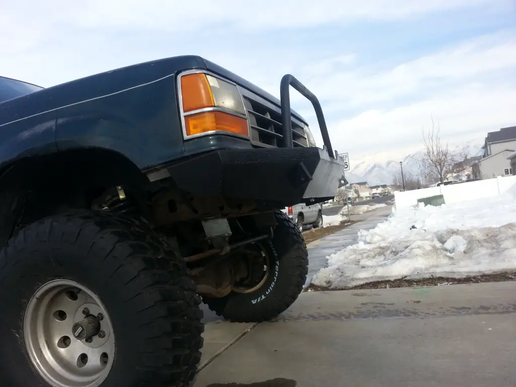

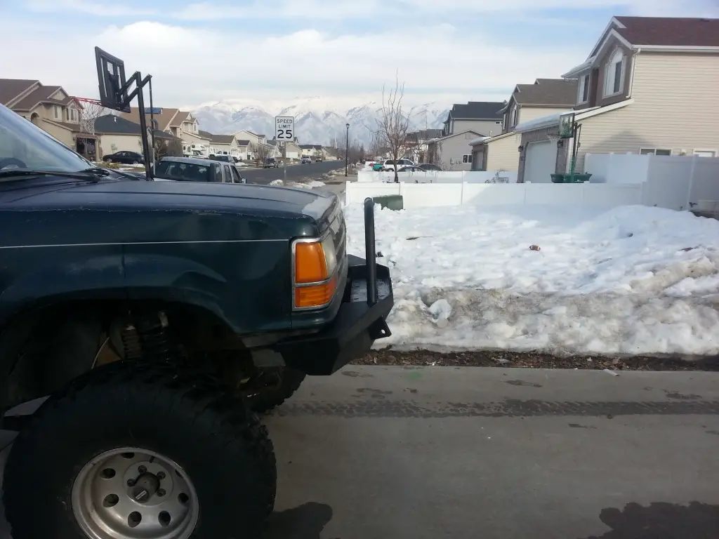

And here are some pics of the bumper going on and on with and without winch.

Looks good buddy. Nice job.

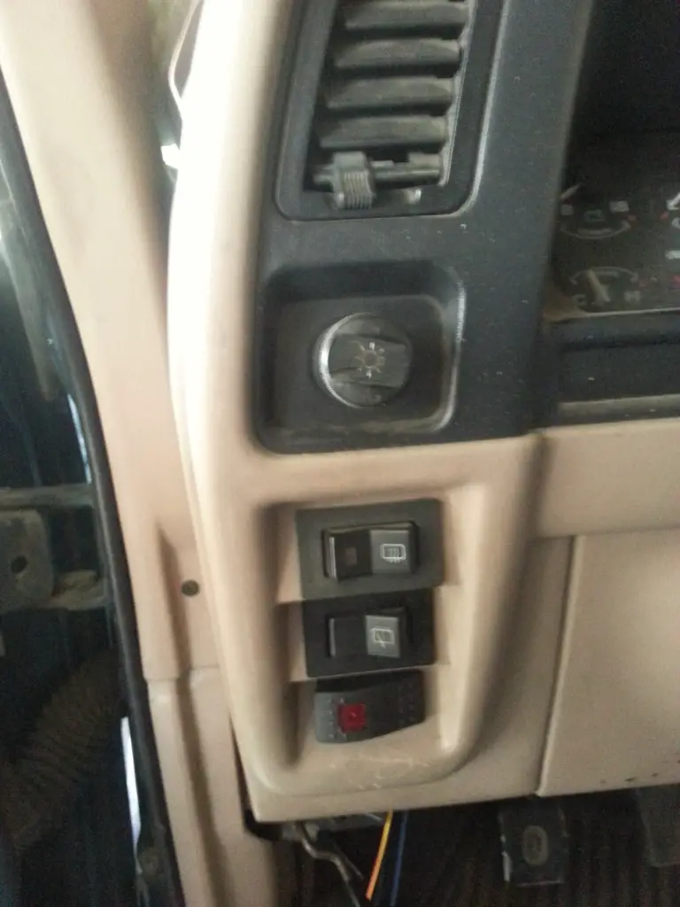

Ok so I haven't posted on here for awhile cause there havent been may changes..I did wheel bearings again...and now im installing my elocker in the rear so here are a few pics thus far........
Switch setup in the dash.....
Dash reinstalled with switch.....

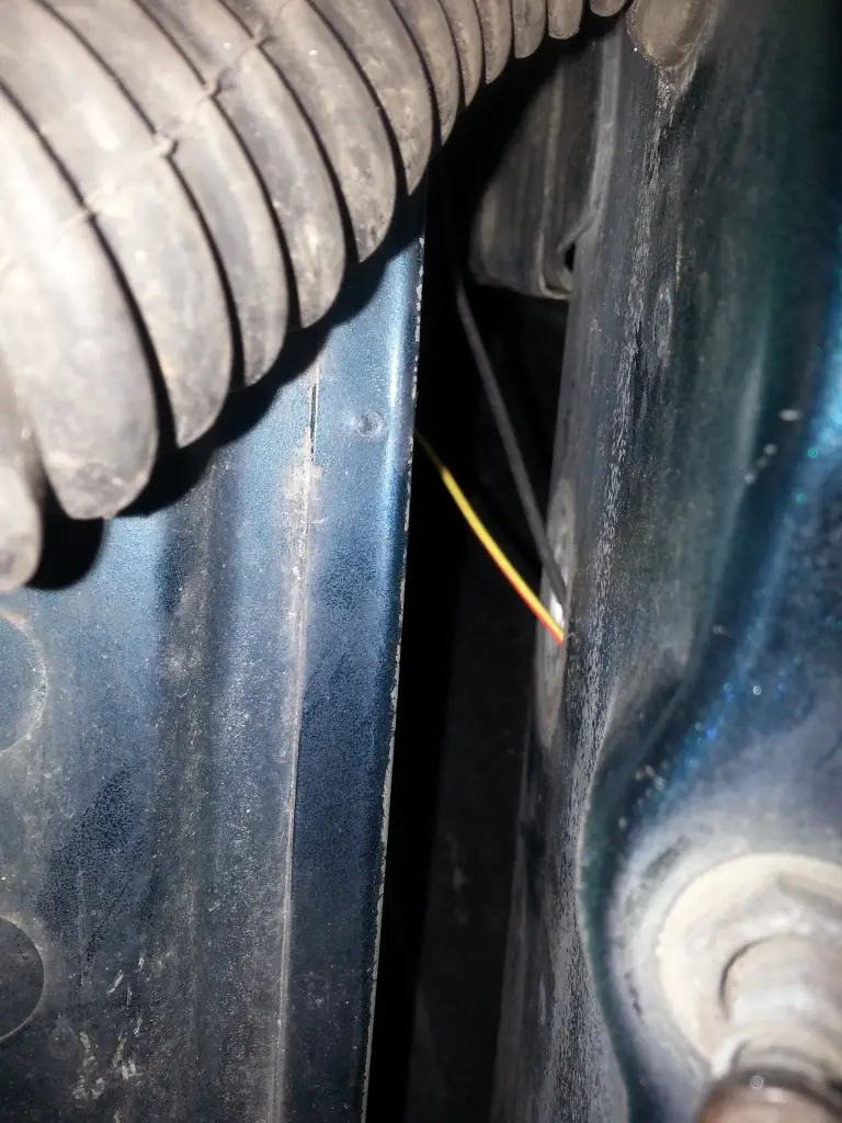

Wires from relay to switch going into fender under hood....
Wires going into cab by ebrake pedal through an unused grommet....

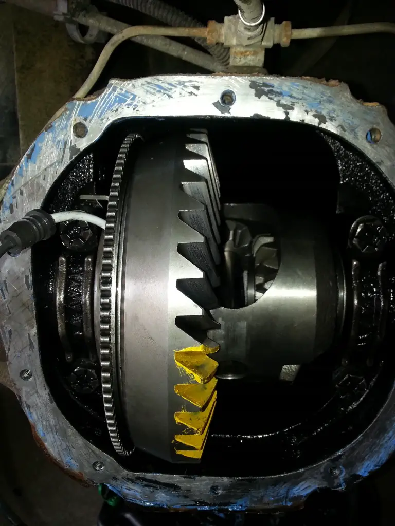

I got the old carrier out.. of the axle but thats as far as I felt like going tonight....more to come...

Well I finished it up heres the rest of the pics......
Heres the pattern after shimming it up and I had about .009 backlash.

Yes stayed with the 4.56s for now I plan to get a new 8.8 with discs and cut down a d44 for the front and at that time ill go higher...probably go ahead and go with 5.13s so I wont change my mind again lol. And as for the shimming I got really lucky and was able to use the same ones from when I regeared.

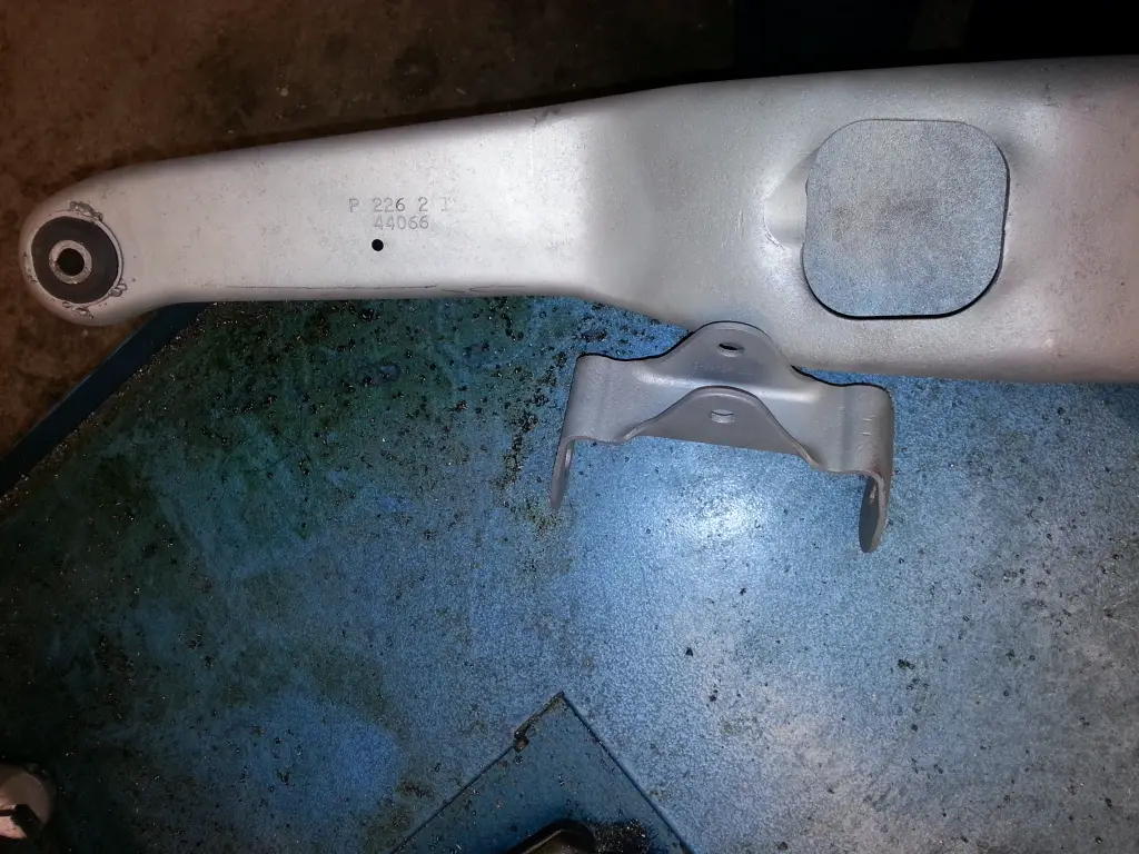

Well considering what happened on the moab trip the sas will be waiting....hit a rock and bent the drivers side ttb.....evilreapertwin (mike) happened to have one with him that had a detroit easy locker in it and he hooked me up....so since now the front will be locked also im going to shoot for an atlas transfer swap later this year.....but for the time being heres some shots showing the damage...and some of the new parts thus far.
As you can see since this is supposed to be centered and straight......
If you notice in this pic the left side on the darker one is flush with the ground...the green one is the way its supposed to be.
Here is a top comparison of the two...ya id say its bent..

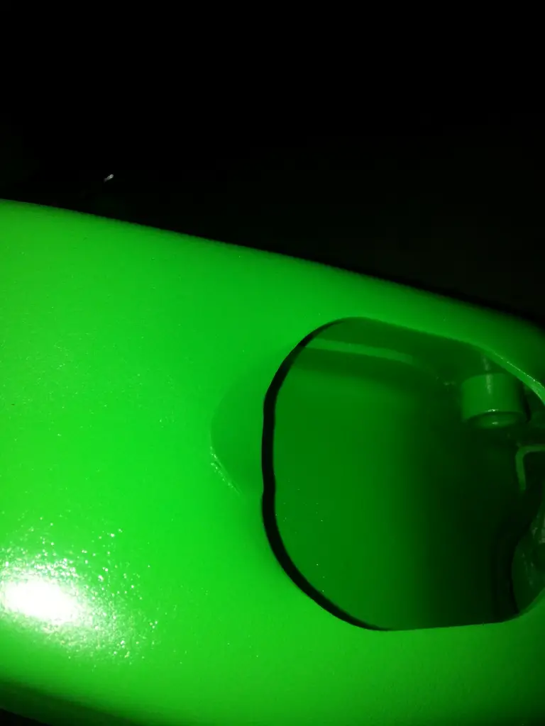

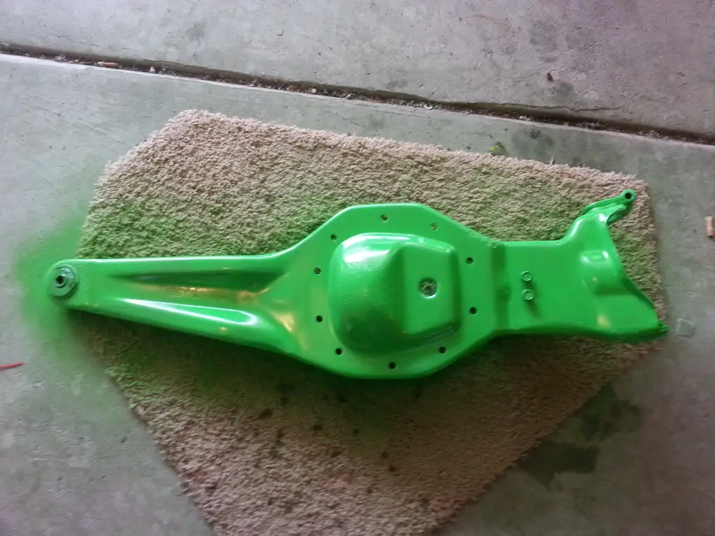

Now I took both beams and knuckles and backing plates and got them bead blasted again and have started painting...heres some shots....
Thats it for now.....I plan to take some more pics of the damage if I can and some more of the new parts going back on.
