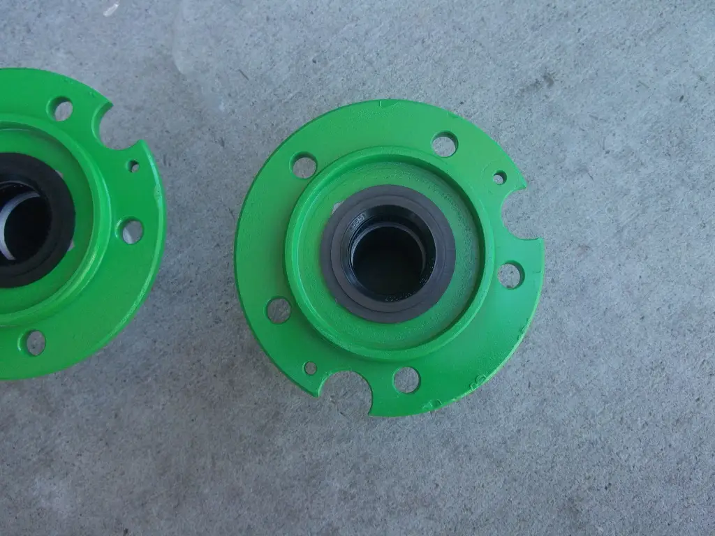

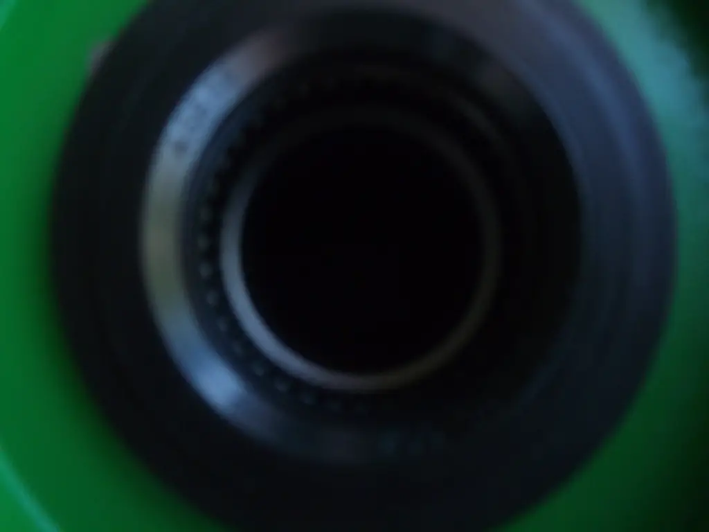

This is the Spindle Bearing and seal.

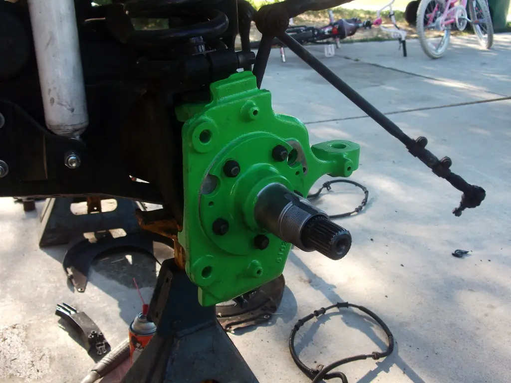

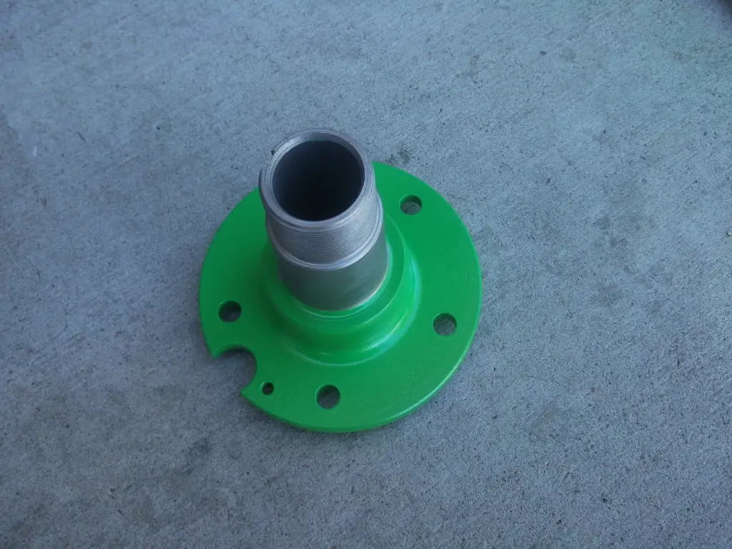

Couple views of the spindle before installation.

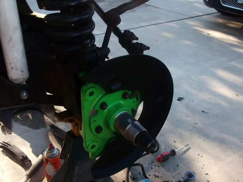

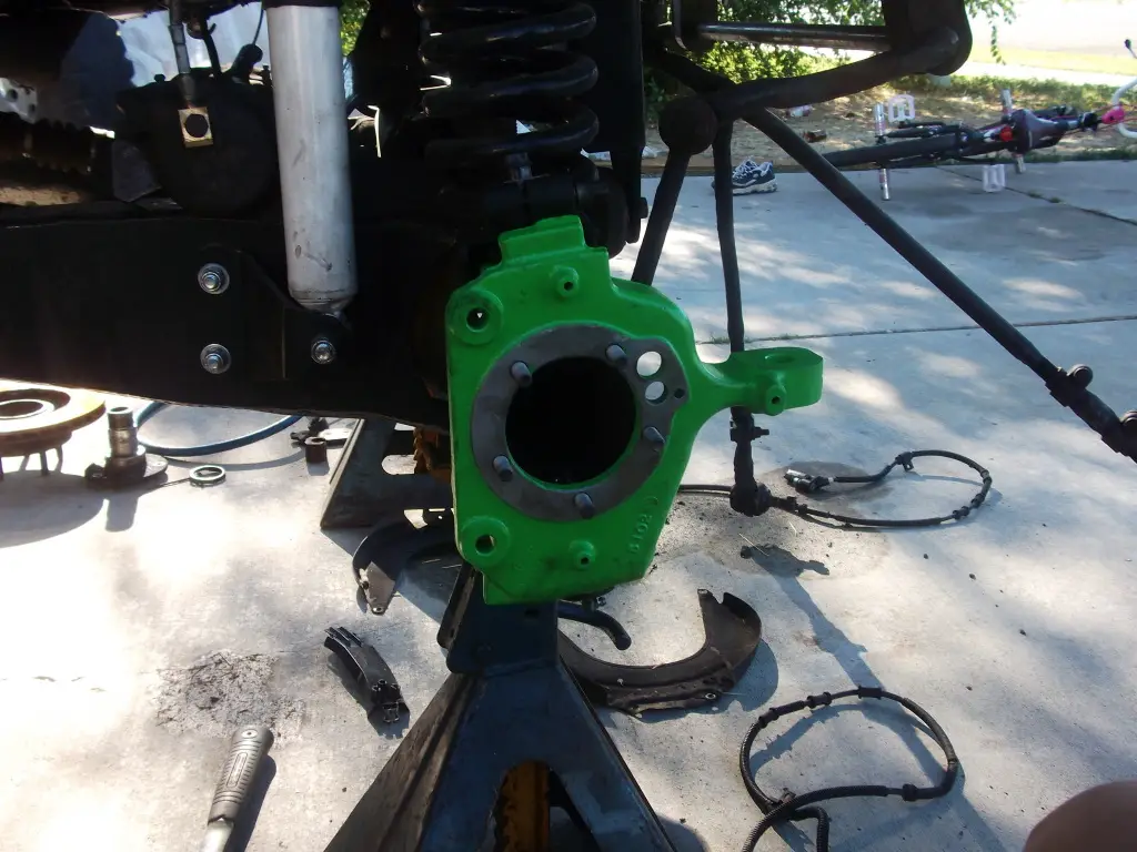

Here is the knuckle before installation.

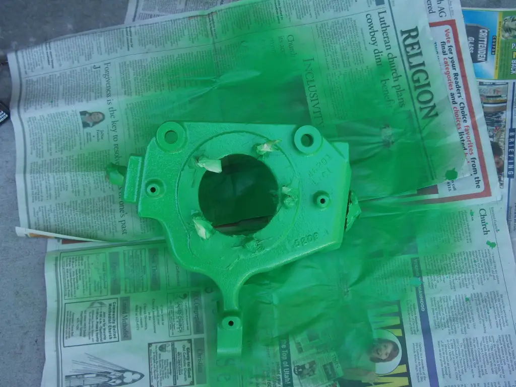

Backing plate before installation.

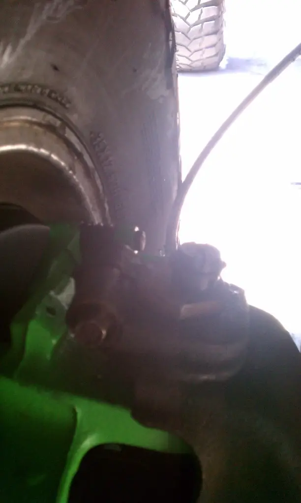

Knuckle Installed.
Spindle, and axle shaft installed.
Backing plate. I chose black just for this because of brake dust mainly.

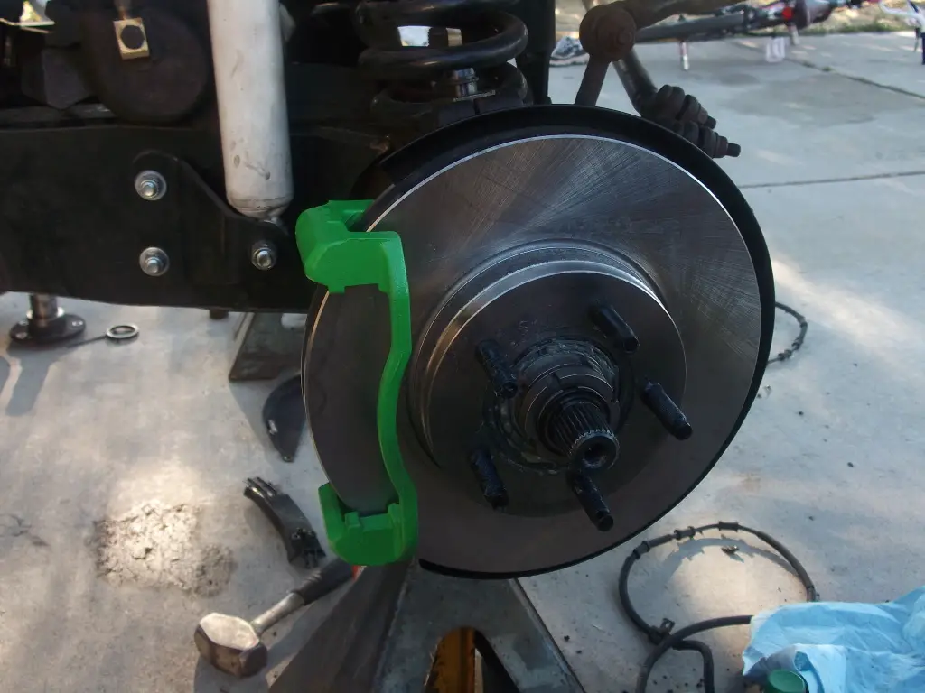

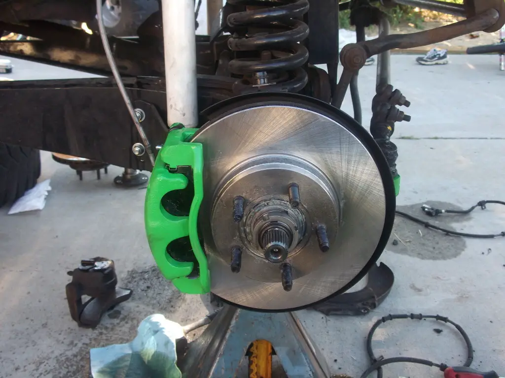

Wheel bearings, hub nuts, rotor, and caliper bracket.
Brake pads and caliper installed.
Couple views with the rim installed.
Overall i am very impressed with the ease of this upgrade. It does get a bit pricey if you do it properly and replace all the parts while your there and do it with good parts. I can definitely feel the improved braking. Alignment should be done tomorrow i hope. I can definitely say that i can now hear what is the tires but before i thought was tires but it wasn't it was mostly bearings. It is quieter now but definitely needs the alignment. Next mod is the Roof Basket which should be here by next week but its also a simple bolt on "for now".

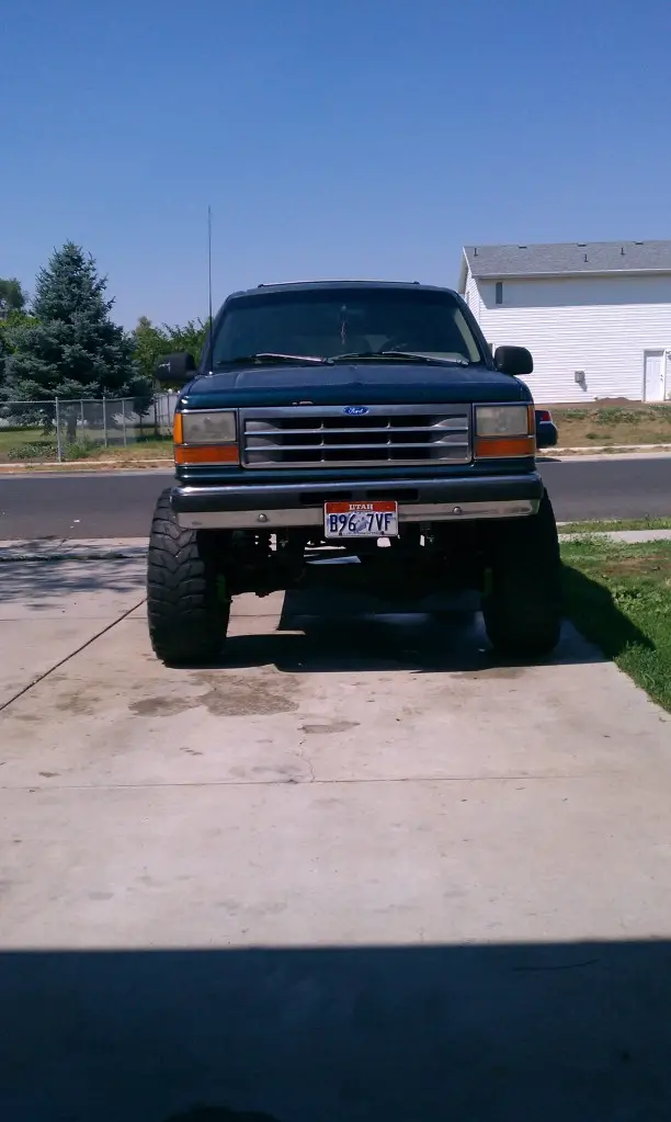

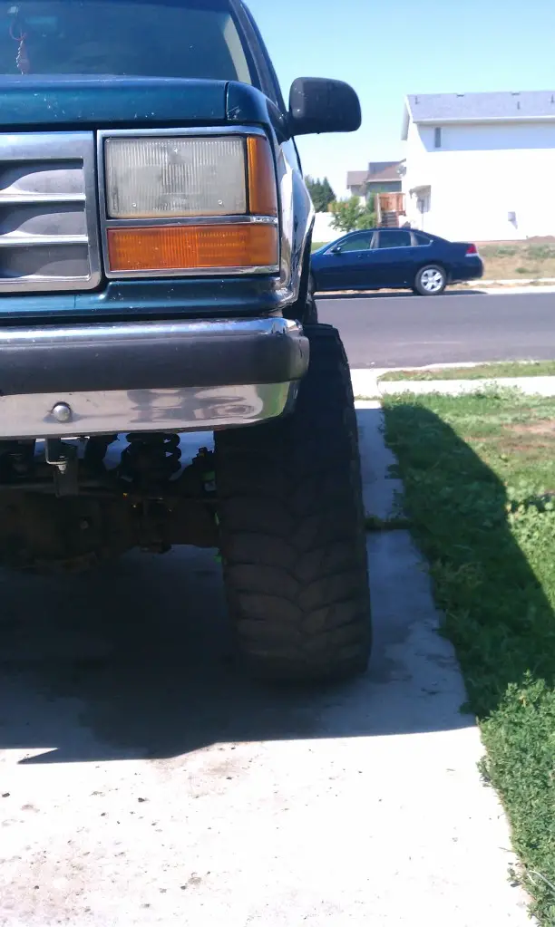

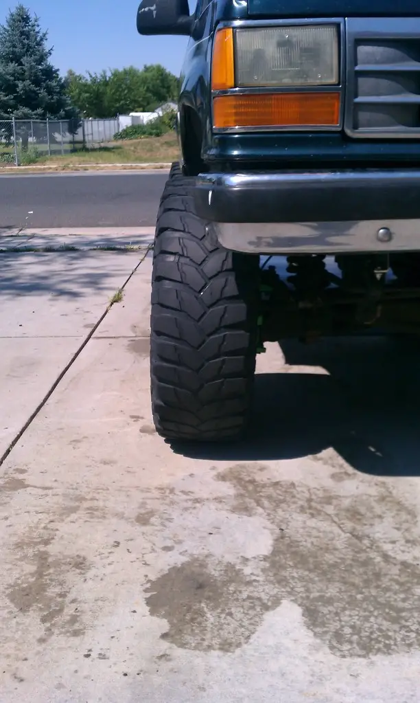

Ok so I took it in for the alignment yesterday and was told they got the left front dialed in but I needed a new bushing for the right front. While driving home I noticed it pulling to the right pretty hard then when turning my tires were squealing not just chirping, so I pulled in the driveway got out to take a look and this is what I found!
Either I'm retarded or that's not even close! So I climbed under to see how much room I had on the bushings to push the tops back out and found this!
Again call me stupid but THAT'S BACKWARDS stupid sobs. Anyway I decided I was better off doing this myself. So I got a torpedo level and placed it center of the time both front and back and adjusted til the passenger/right side was as close to perfect as it can be with a torpedo level alignment. The drivers/left side I turned all the way out and it still needs a little so gotta get a bushing. I was getting late for work so couldn't snap after photos sorry! When driving now there is very little pull, however when I got to work I found an inner axle seal leaking ugh drivers side too double ugh! But anyway the tires were now pointing out at the top a bit? WTF! It drives WAY better than after leaving firestone but I thought maybe the slight jarring from the slope into my driveway is throwing it off a bit so when I got home this morning I parked on the street and will check it out when I get up! Input on possible causes for the alignment ghost would be appreciated! My thoughts are grave digger is getting jealous so he thought he'd screw with the hulk!
So I still didn't snap pics but I pulled it in the driveway straight and slow so it didn't flex the suspension at all then drove it forward and backward a couple times and when I got out the tops of the tire are pointing out slightly now so I will have to make some further adjustments tomorrow but I font believe ill need any different bushings!

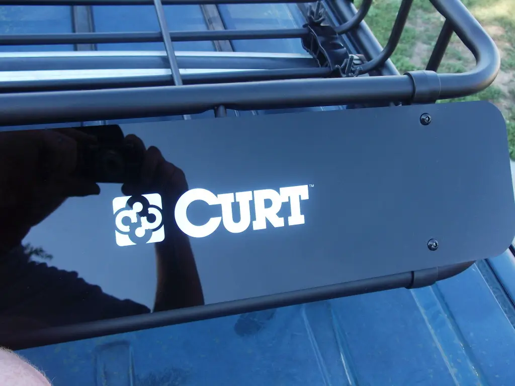

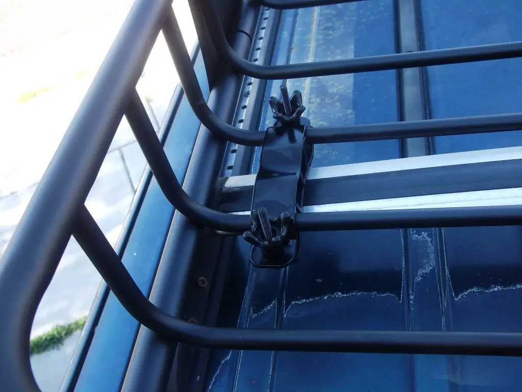

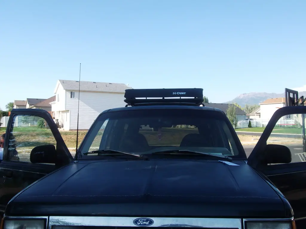

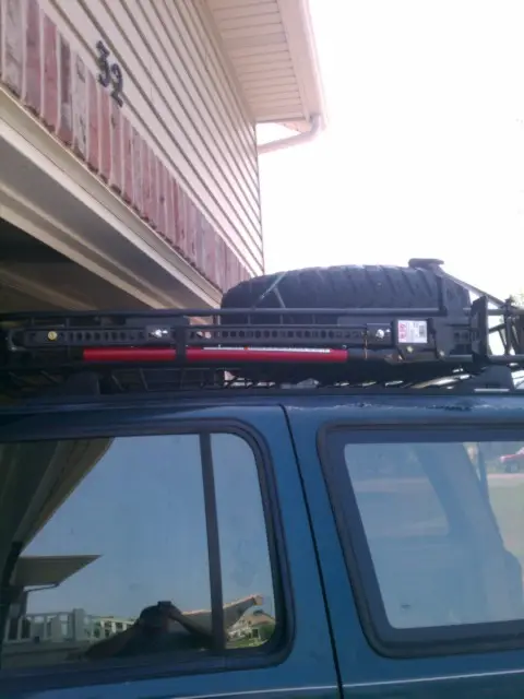

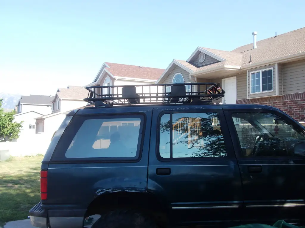

Put it together and installed it here are some pics. Not bad for $2.20 if ya ask me.
These are the mounting brackets as is now. I do plan to make some modifications eventually to mount it solid to the roof rather than to the luggage rack but this works for now.
Picture of the front decal/shield.

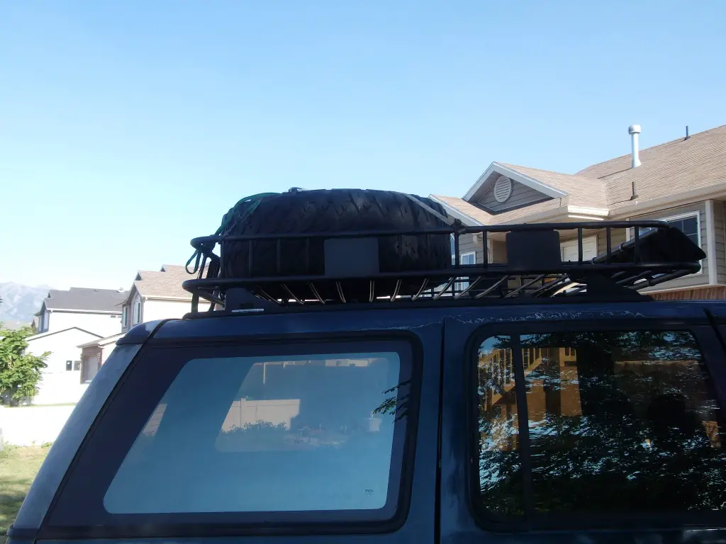

And a couple different views of the basket installed.
Now with the tire in the basket. and very soon there will be a high lift jack mounted and hopefully a shovel and hopefully some lights on the front of the rack.

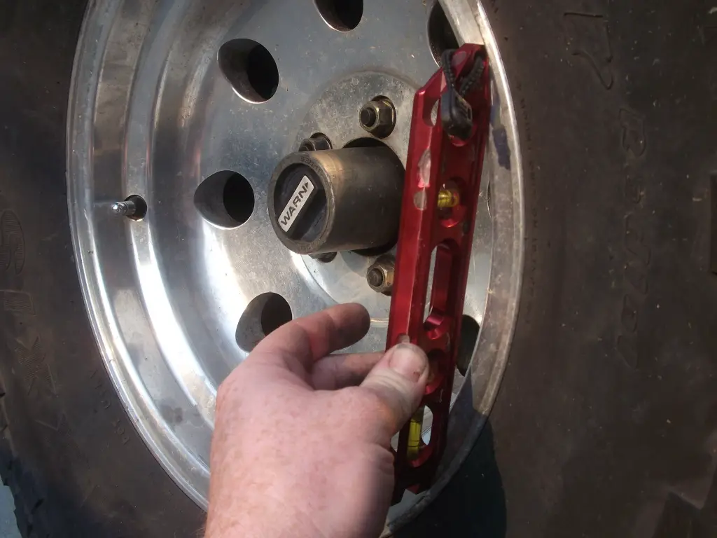

Ok so i played with the alignment a bit more and here are some pics. I still need to make a small adjustments to the passenger side but its close.
First up is a pic of the alignment when i first pulled it up onto the alignment plates. Which by the way i actually think this is a BAD ASS PIC!!!!

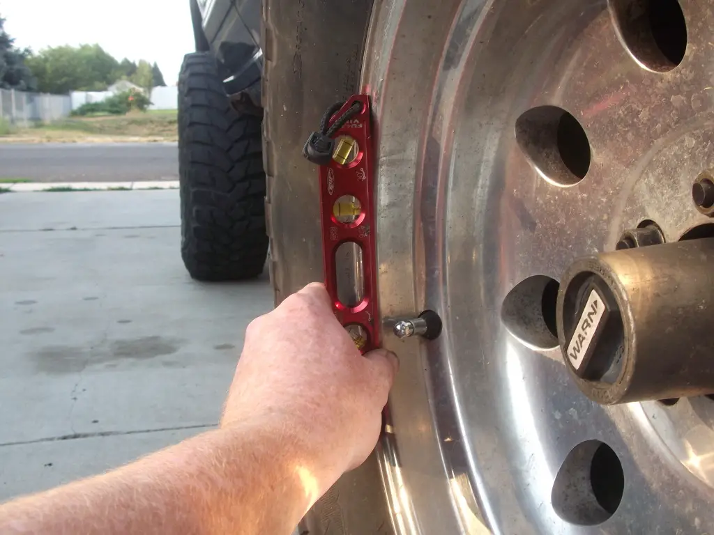

Couple of pics showing how i used the torpedo level and i verified this on both the front and rear side of both rims.
Break down is I hate aligning this front end lol. After using the alignment plates i got it close then drove it around the block and pulled it back in the driveway and looked at it and it was WAY out top of tires on both sides were sticking out ALOT. so then i just turned the shim all the way to the other side drove it a bit and when i pulled it back in it was kinda close but now the tops were leaning in a bit. So what i ended up doing is making an adjustment then drive, then adjust then drive, then adjust then drive, then adjust then drive, and so on i think you get the picture. I think i just need to do one more adjustment on the passenger side and it should be pretty close.
So next I went ahead and mounted the new hi lift jack on the roof basket.

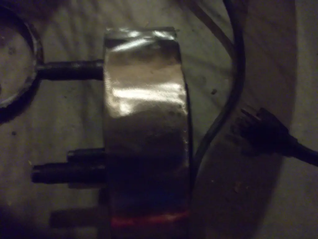

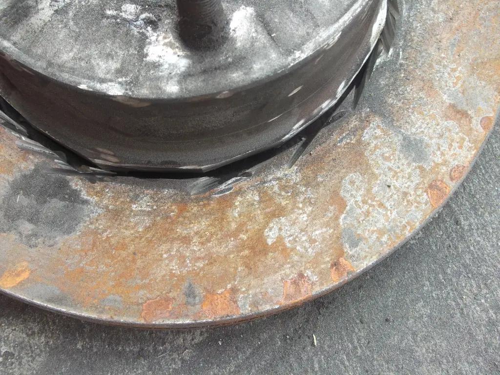

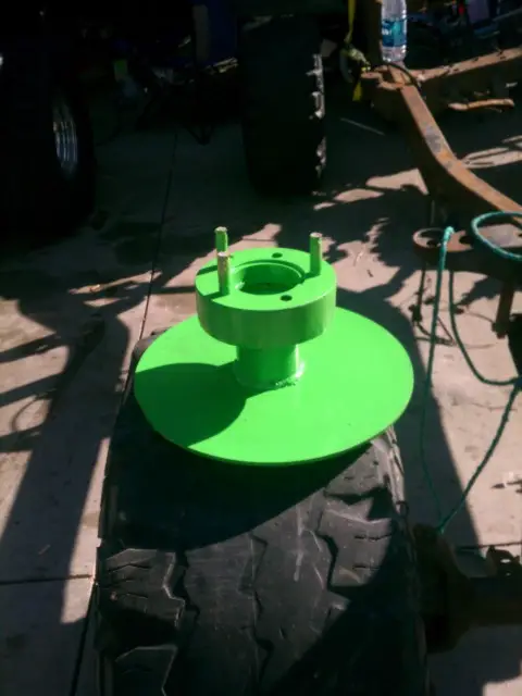

Then i decided i wanted to fab up something to hold the spare in the basket without strapping it down so i decided to start here.

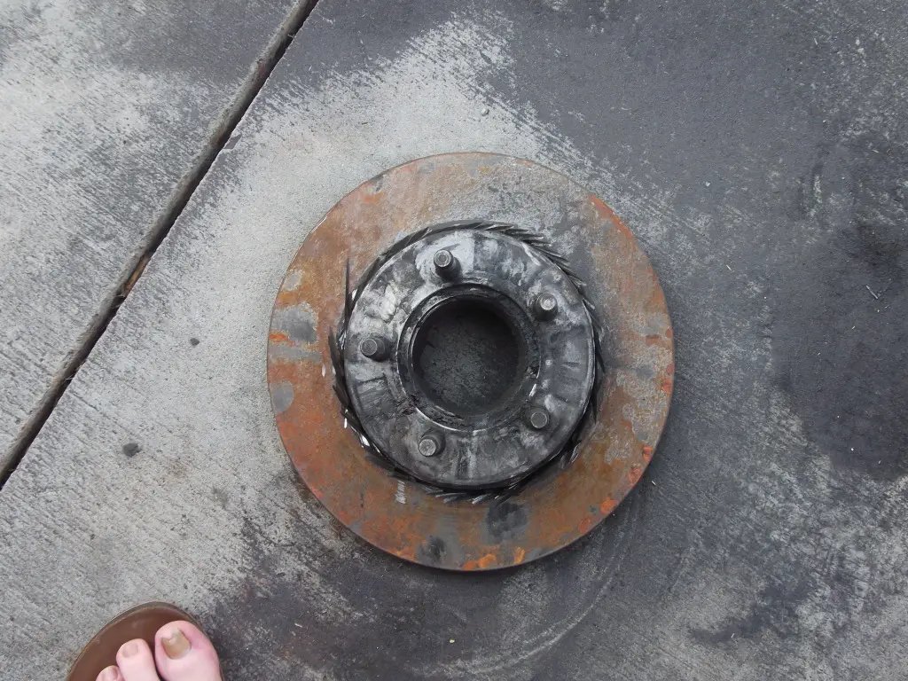

So as you can see i took an old rotor that was going to be trash and cut the center out of it. Then i smoothed out the edges and cleaned it up, knocked out 2 of the studs and knocked out the old races. The plan is to measure up a way to weld this to the basket so when the tire is up there it will rest on the rotor center and then i can just put a few lug nuts on to hold it tight and then i can have my straps back and it wont look quite so redneck cause its just a dead give away. Oh wait im driving the hulk and work at an oil refinery in the words of anthony aka Suicide77 i am a true american.
Anyway that is as far as ive gotten. I will post more as i go.
Ok so I finished the spare tire mount.

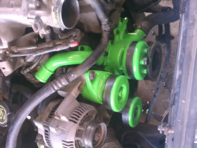

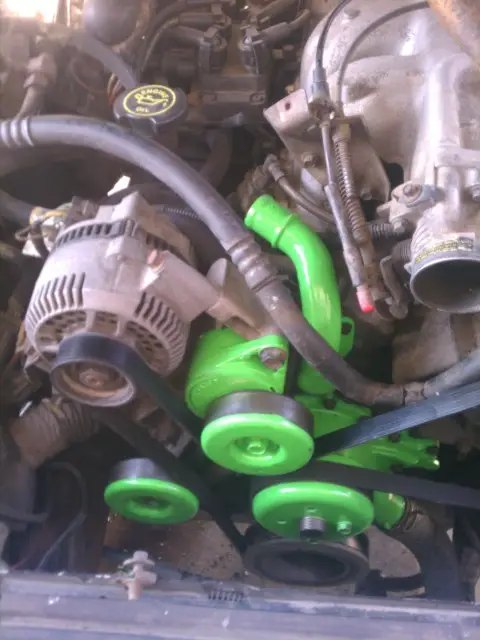

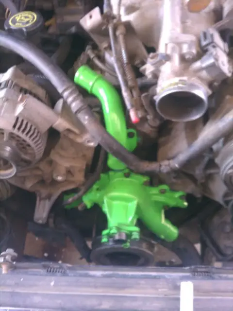

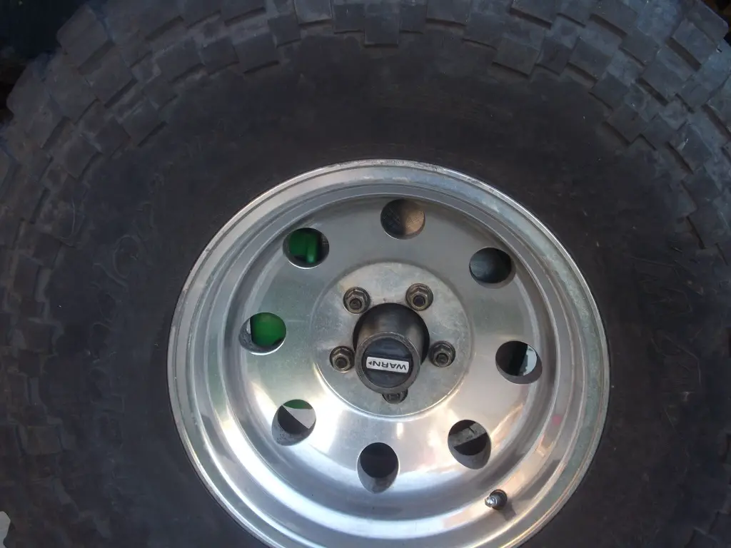

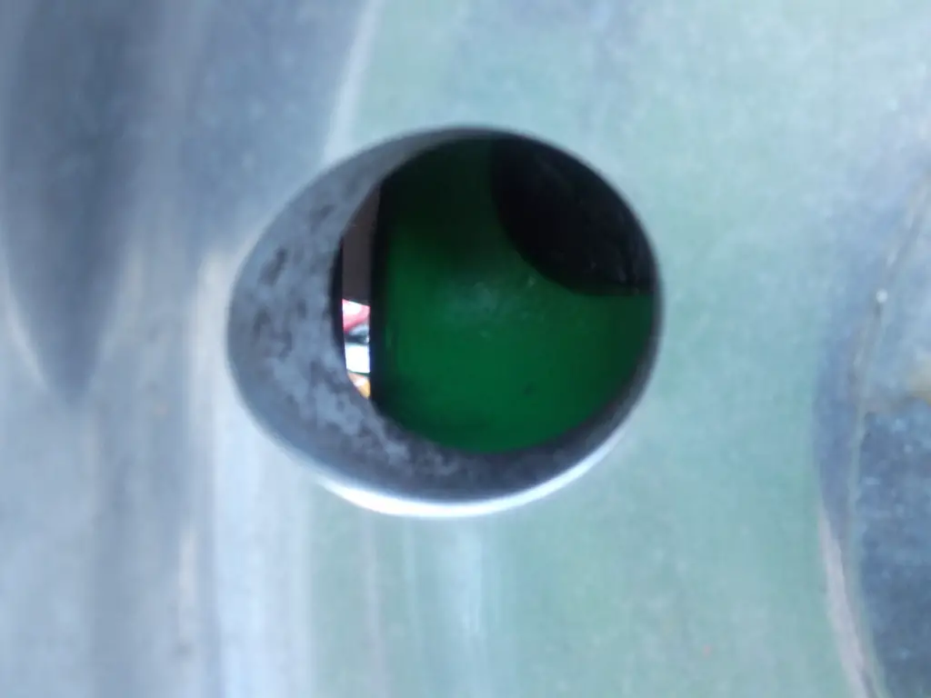

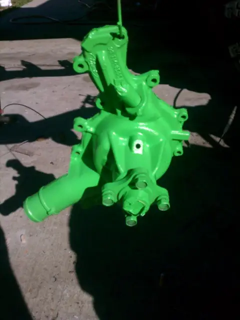

Then the thermostat went out and so I replaces the thermostat the water pump the serp belt and the fan clutch, and decided to dress them up a bit along with a couple pulleys and the belt tensioner hulk style!
Still trying to find a grinding noise that's intermittent and only at low speeds. I have gotten the alignment pretty close but I need a new bushing for the drivers side. But hopefully it will stay running without a problem for awhile cause the pocket book has been draining pretty quickly.
