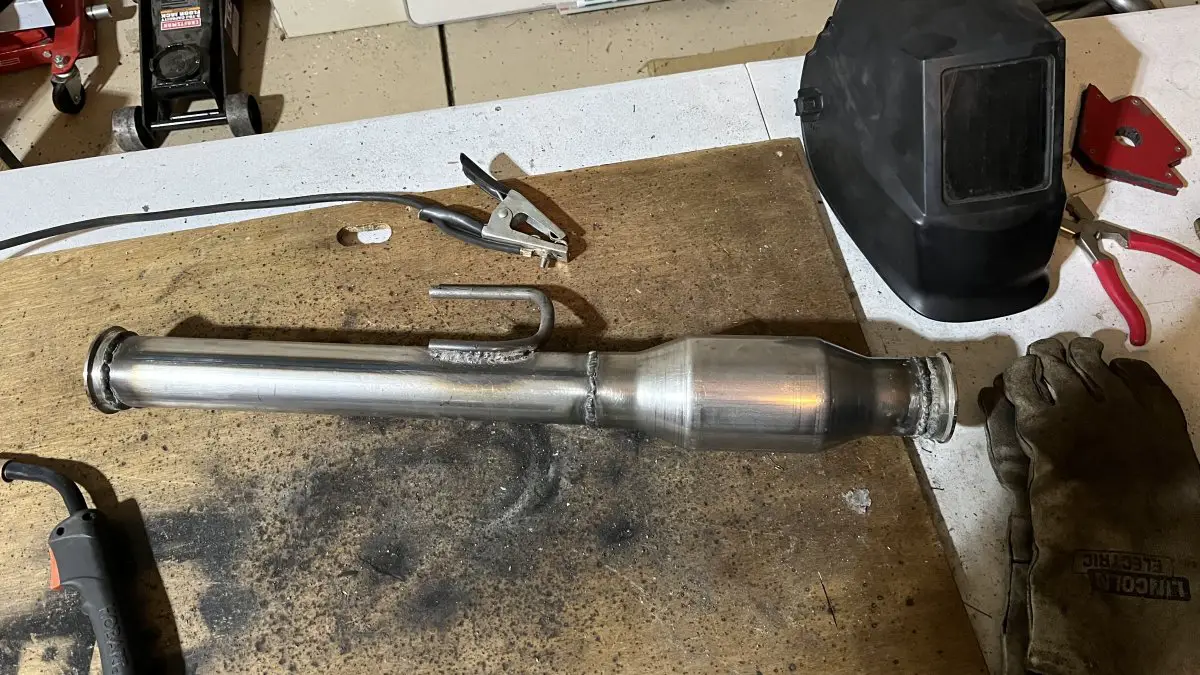

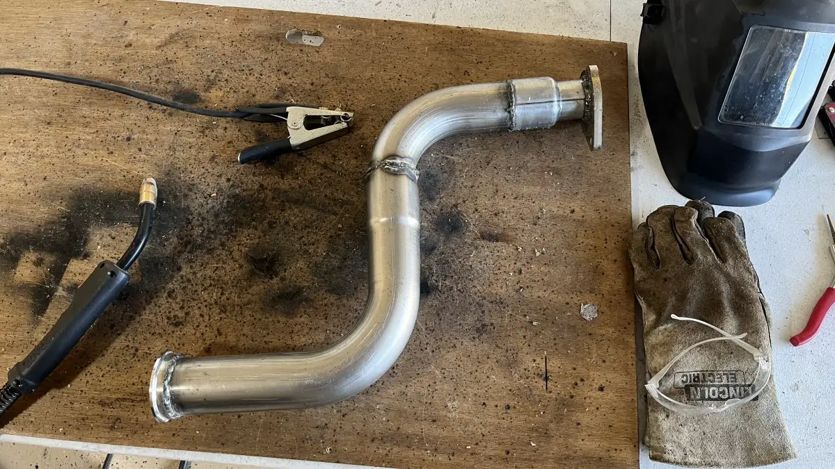

Got the first parts of the exhaust built today. Building the exhaust in sections so if I ever need to replace a catalytic converter or muffler I can just replace one section. Each section has v-band clamps on either end. Today was the downpipe and cat section.
Hopefully tomorrow I can get the muffler and tail pipe sections built.

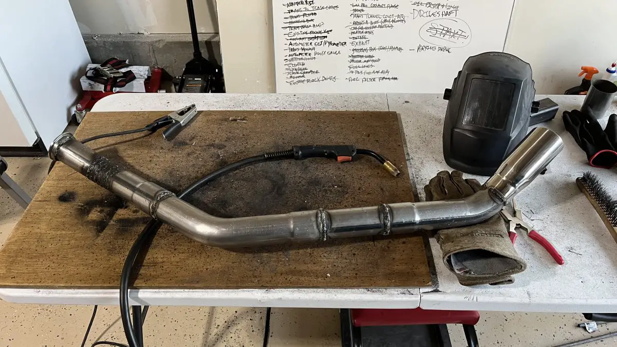

Finished up the exhaust today. Definitely quieted it down a bit, but not too much. And it’s got a fancy exhaust tip!
Muffler section
Tail pipe section. Had to do a few pie cuts to get the angle I needed just past the muffler.

Very nice! Cool muffler too
I'd love to ride in that explorer. Great job!
Thank you! It’s a Nexus muffler. I’ve never used one but have a friend that’s been running them on his vehicles for a while. Figured I’d give it a shot.
Thank you! I think we could arrange something!

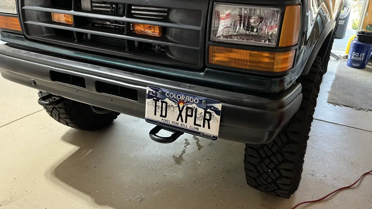

Well it’s official now… hood is back on! And a little finishing touch with new license plates.
Took it for a drive this evening and it feels so good! Drives really well and sounds cool.

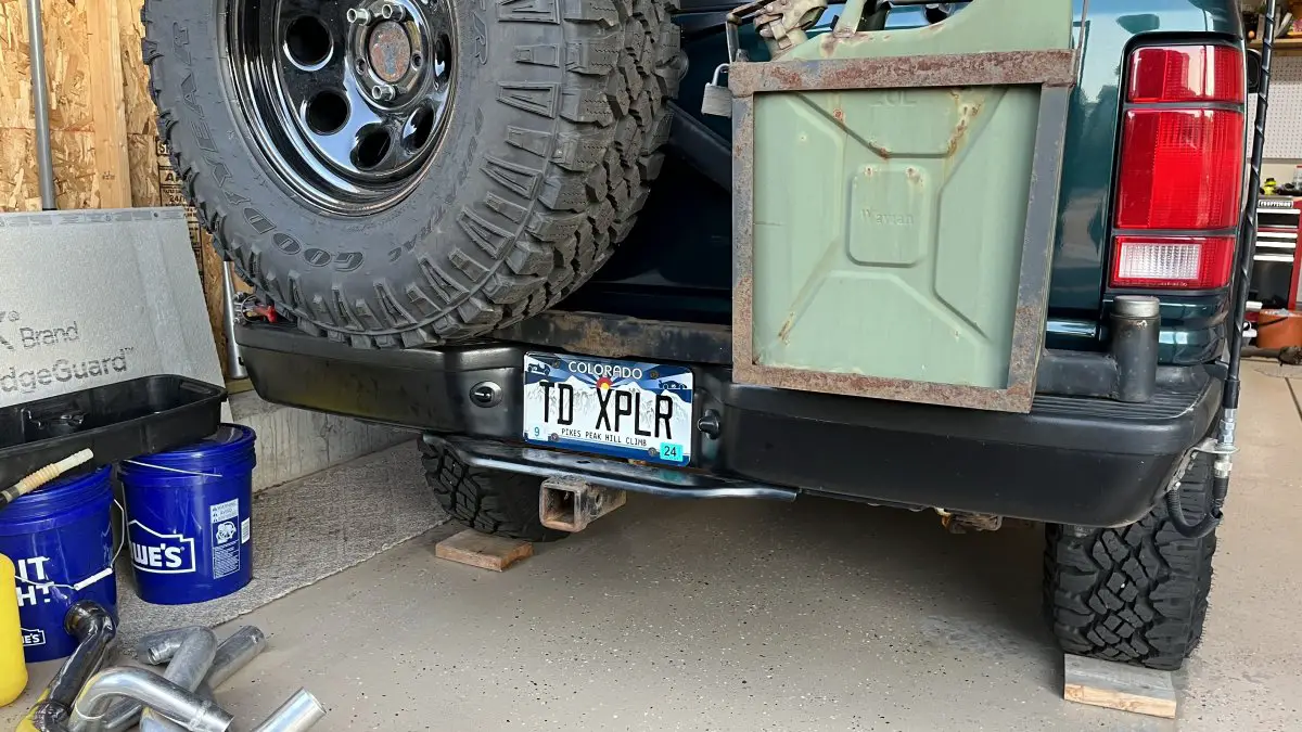

Still gotta do the driveshafts and fix the parking brake.
And put diesel in that green can!
On road diesel is $5.00 a gallon here right now! Sucky time to be a diesel driver hahahahaha
