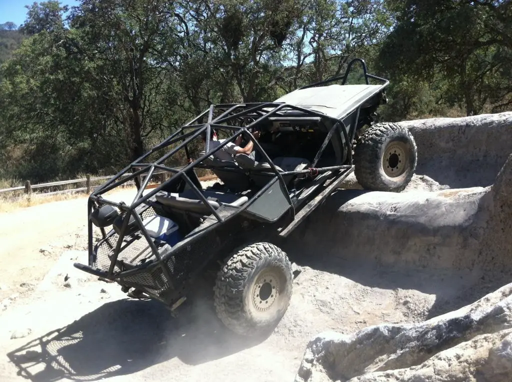

well went to hollister this past weekend, and did squeeze rock. broke the driverside window out on my girlfriend, but she was a trooper and cleaned the glass out on her own. we ran the jungle forwards with no issues(or maybe that is when mine started) running it in reverse i ended up blowing my front rive line out of the yoke, i think because my yoke hits the upper stubby link i have. not for sure though. gunna look at both y link and switching upper link to the passenger passenger side. also could be because my driveshaft hits the xmember a little, gunna take car of that in the next day or two. other then that i had todo some more trimming to the inner fender wells, which i already took care of and i need todo xfer shift linkage bad. tired of crawling on the ground to put it in 4 lo. oh! also gotta clearance my gas tank skid.

heres the xmember that i had made
all flexed out..
