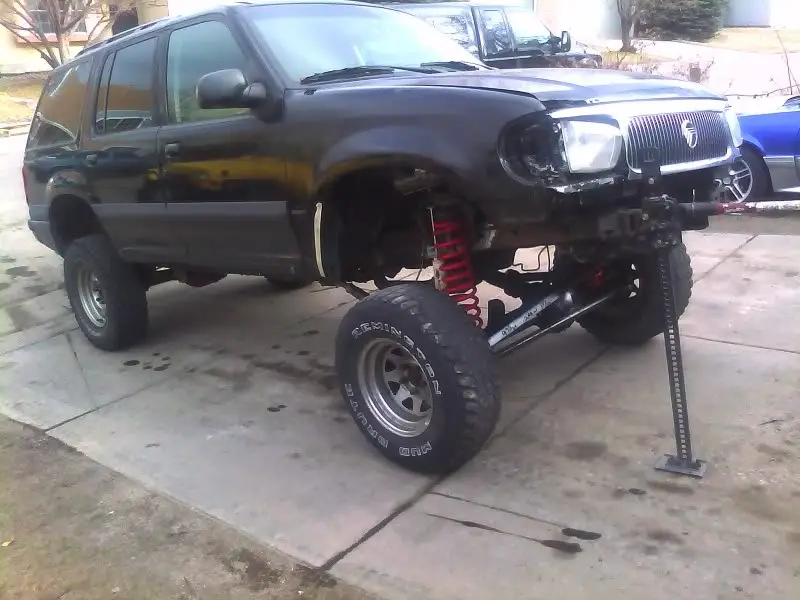

I was trying to see how much drop I had. I am 6'2" and you can see it is at my chin. I ran out of jack.
31s on it right now...
:eek: holly cow, looks like limit straps in your future
One other thing I sent these pics to my wife's step brother who has K5 and told me his Cheby would kick my Fords butt off road. His only response was fix your effing headlights... :D

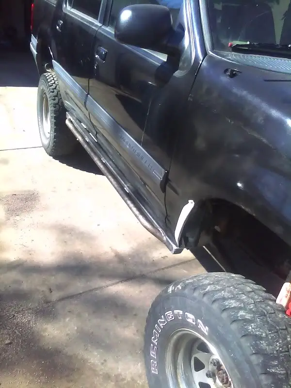

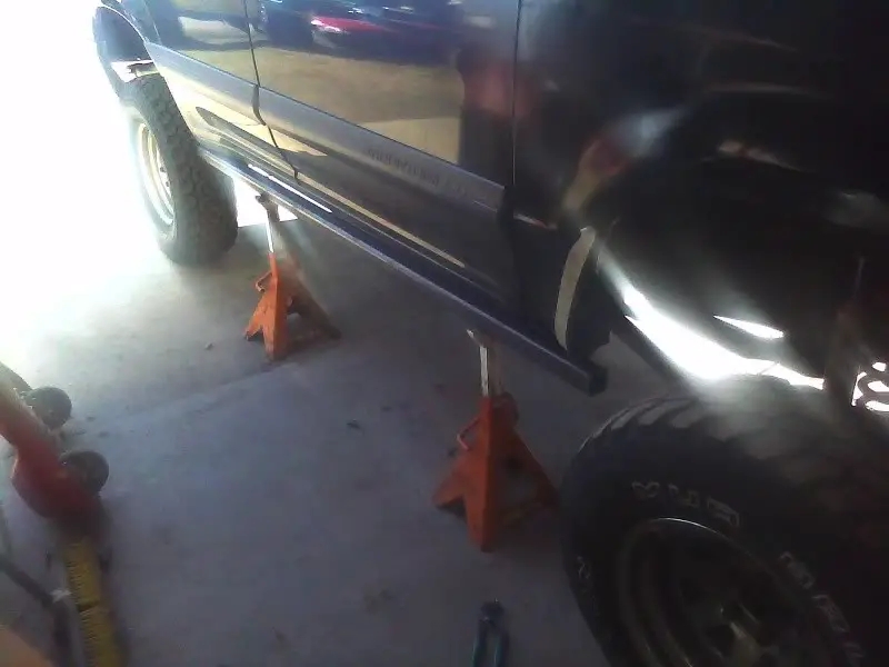

Welded or bolted to the frame on those sliders?

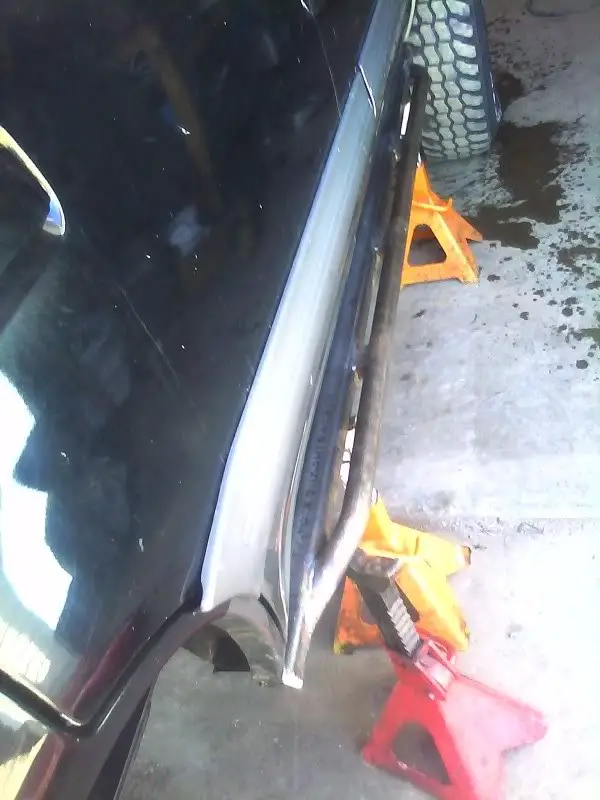

I welded mine but I made them so they could be bolted I would just have use bigger plate. I put couple tacks on the pinch seam and used 1"x1" angle to fit along the pinch. Just like I build them for Jeeps. I have built a crap load of these for Jeeps. This is my first Ford version.
Passes the hi-lift test...
So is it just hooked to the pinch weld or is it welded to the frame as well?
Gman asked me if I welded or bolted them to frame and I answered welded. I did also weld them to pinch seam using a piece of angle that is welded to the legs. I can cut the sliders loose with grinder easily if I ever need to remove them.

I know it was asked I was just curious if you tied it to both since the frame and body flex flex seperate from each other.
It will flex just fine trust me. I spot welded it to the pinch seam mostly to keep from having the sliders slam against my body. I used 1"x2" rectangle tube back to frame there are 3 legs. Then I pushed the rec tube tight against the pinch seam put a piece of angle up there and spot welded angle to the pinch and to the rec tube.
