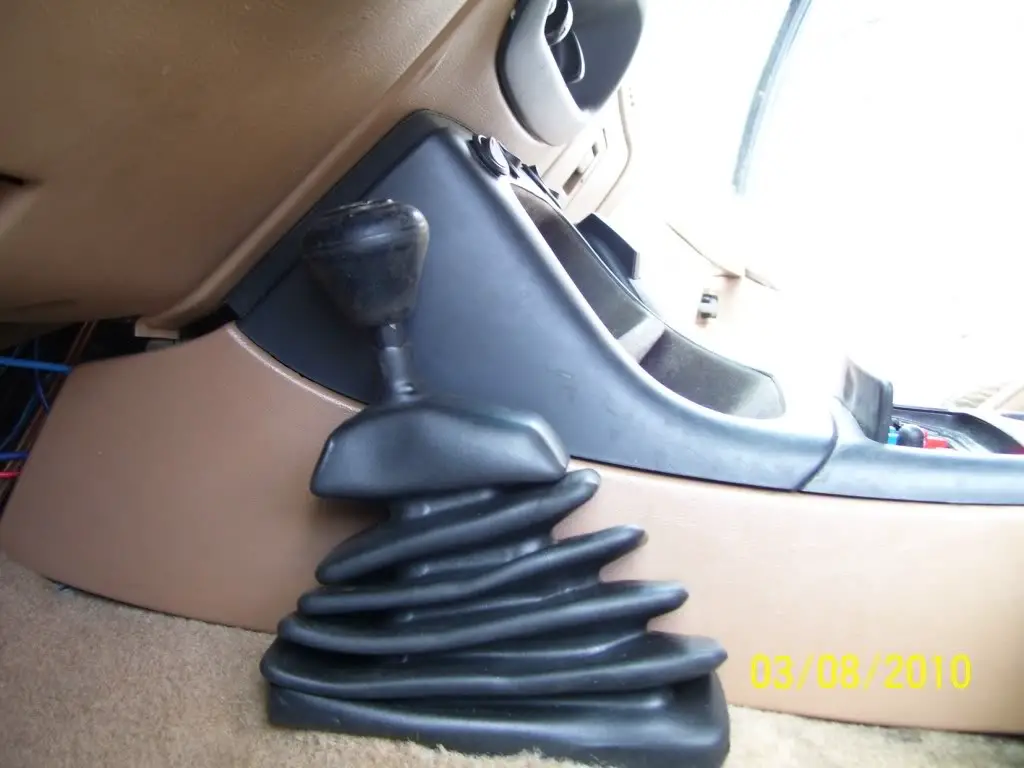

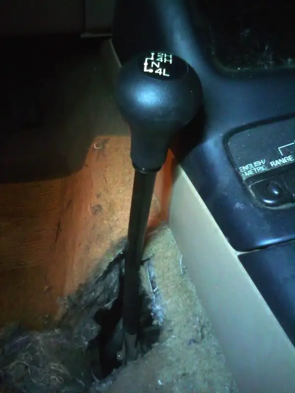

Shifter in just have to find boot now... :)

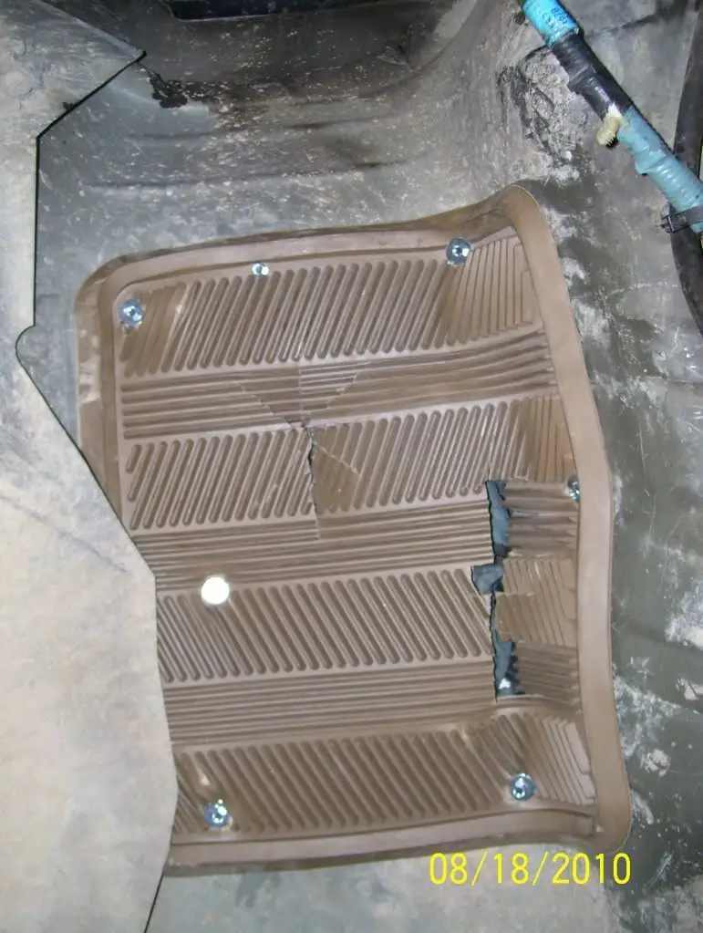

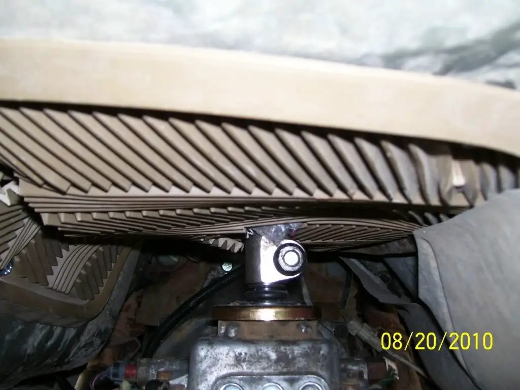

For the shifter hole I attached some sheet metal (old alum tag plate) to the underside to fill in where was cut too much, than used some self tappers and fender washers to attach a thick rubber floor mat to the trans tunnel to keep the air & water out. Also helps with the incredible amount of road noise that came thru the floor.
Sweet! I will see what I can come up with. I took all the boots off the F150 I got parts from so I might modify them to fit if I can.

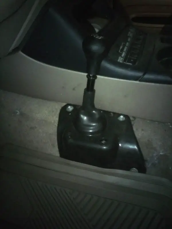

F150 inner boot works good. And looks nice enough for me. The rubber boot part is super thick so should be good to keep the noise down.

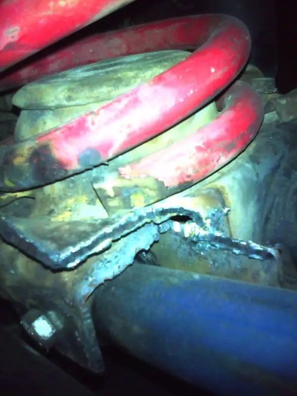

Thanks man. Closer I get to being ready for some action more excited I get. My oldest son (10 year old) is so excited keeps asking when we can go wheeling. LOL I cut the crossmember for now I still have to brace it some. I will post pics of it once I get the bracing in. Took it for little spin and I am getting some death wobble at 40 mph. I am sure the crap tires are not helping since they are low on air too. But I might have to beef up my axle track bar mount. I think I cut too much and weakened it enough to move. First time I hit 40 no death wobble this time it did so not sure. So I will be checking everything this week. I fix death wobble in Jeeps all the time. So this can't be too hard to solve.
And yes bench pressing that monster up there was not fun since I had to do like 6 times before I finally made enough room. But it is worth the effort.
I was right had the wife turn the steering while I watched. The everything frame side looked tight. Then I went down to axle side of track bar and it is moving like crazy. I guess some of crap I cut off was more important then I thought. LOL I just need this axle to last me until Summer so I can build 44. So I will have brace up this TB mount on the axle.
