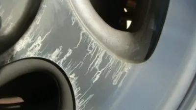

I have a 2013 ex limited with the aluminum polished wheels. The car has been babied since purchased new and I never use abrasive cleaners on the wheels. I've recently noticed several corrosion lines on them. It seems like three years old is too soon for this to be happening. Has anyone else had this issue?

I have a 2013 ex limited with the aluminum polished wheels. The car has been babied since purchased new and I never use abrasive cleaners on the wheels. I've recently noticed several corrosion lines on them. It seems like three years old is too soon for this to be happening...
Hi nitzer51,
Have you been to your dealer so they can check out the wheels? I'd recommend that as a next step. What's the current mileage on your Explorer?

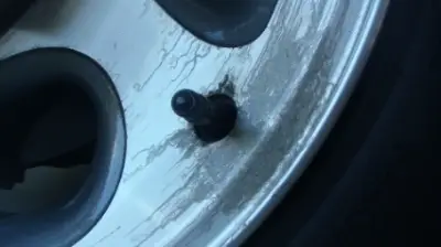

All 4 of my wheels have exactly what you are talking about. these have never seen snow /salt and look like hell. took to dealer and basically been told ford will not do anything about since it is normal use. what bs. have a 2014 fusion with black chrome wheels, clearcoat peeled on all 4, dealer tried to use line again that ford will not cover but car has only 9k miles hard to deny covering. dealer called me letting me know they will replace under warranty as such but told me the replacement wheel are on a 6 month back order ( must be having lot of issues) I asked for the sport wheel which they did get me but only after 7 trips to dealer since the techs damaged 4 replacement wheels because he did not know how to use machine plus got 3 new tires out of deal since those were damaged as well

I had the same issue on my 2013 Limited. Ford replaced all four wheels. The service guy at my dealership was surprised Ford did that. But I was happy.

I too am having corrosion on all four wheels of my 2013 Limited Explorer. Took it to the dealer who submitted pictures to Ford 3 weeks ago. Now Ford wants me to take it back to the dealer next week to clean the wheels and retake pictures. Problem is Ford "engineers" you did not clear coat the inside of the rims. Now corrosion is coming under the clearcoat from the back.

Not all true. If the corrosion goes under the bead your tires go flat. I've had that happen. Besides we paid thousands for those wheels now the donuts look better.

My '13 is starting to do the same on all the wheels and you can see it's starting from the back of the wheel. I'm gonna mention it at my next service appointment.

I went to the Dealer today for a second set of pictures for Ford, this time wheels off the Explorer and cleaned. Ford should clearly state that the rims will corrode in a year when we buy these $40000+ vehicles.
