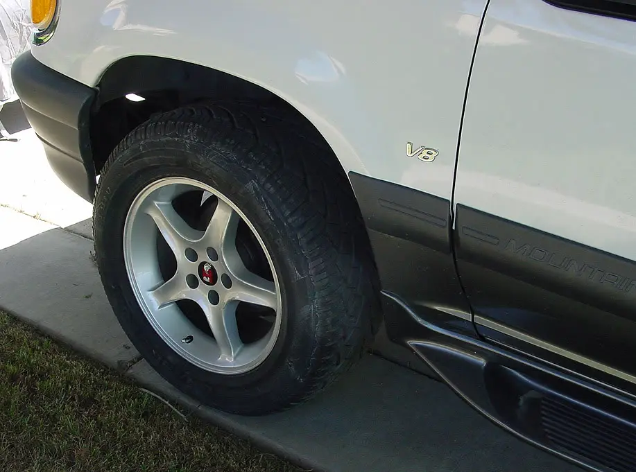

I did go with the 275/55/R17 General Grabber Tires (thanks briwayjones). I did a test fit and the tires did just touch the ball joint & turning the wheels all the way right and left rubbed the sway bar.
I had a couple of wheel spacers, one 1/2" the other 1/4". I first tested the 1/2". The ball joint was pretty far away from the tire and it didn't rub the sway bar much. The problem is, the studs on the hub are too short and I would need to install longer studs for the wheel to safely connect to the hub. Also the center hub is gone, the half inch spacer completely covers it.
I next tried the 1/4" spacer, frist thing I noticed was the Center Hub is not covered and the wheels will contact the center Hub fine with the stock wheel studs. I checked the space between the upper ball joint and the tire and its about 1/2 inch clearence, which should be ok. I next tried the turning and it does rub the sway bars, but not that bad. I took it for a test drive and did some U turns maxing out the turns and it was fine, only slight rubbing. I may install some turning limiters when I replace the Rack and Pinion Steering to fix this issue.

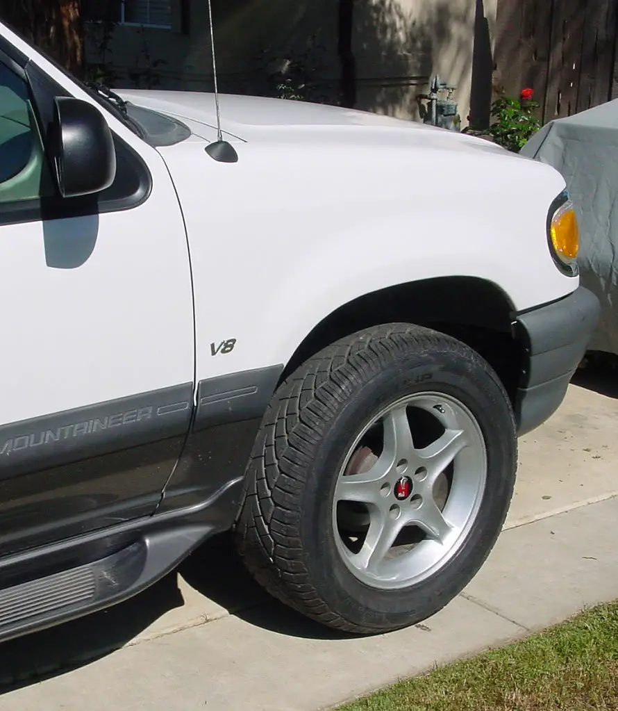

Here is a pick of the Mounty with the new Cobra wheels up front, it sits pretty high right now, I will lower it about 1.5 in when I replace the front suspension parts.
