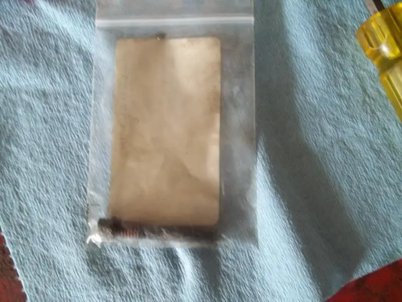

Pictures so we all know I tried to get that stubborn bolt-
The new bolt. It is very upset now, because I am putting it back on the shelf-

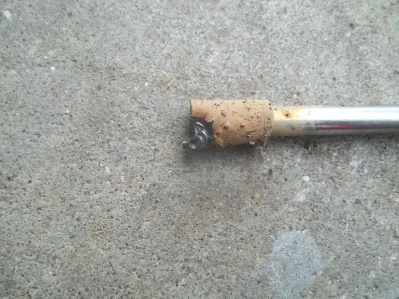

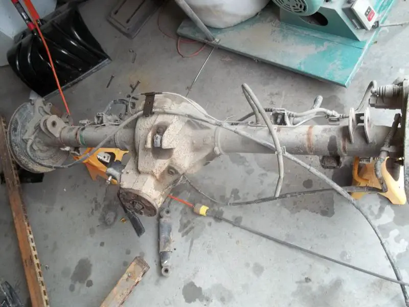

I took a chisel to the locked cross pin bolt to knock off the welded material, the bolt turned and It came out easily. I can now replace the bent axle. Well, not right now. But soon. Then this axle can go back under the Mounty.

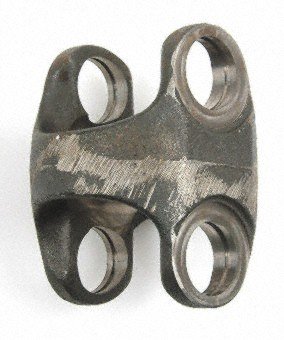

I am in the process of ordering driveline parts. I think I have the u joints figured out, however I need to verify this is the proper Double cardan ball replacement kit please!
Moog 617
http://www.amazon.com/Moog-617-Ball.../ref=lh_ni_t?ie=UTF8&psc=1&smid=ATVPDKIKX0DER
the ball goes into this thingy between the u joints
Yeppers, that's the one. O'Reilly's carries it too.
