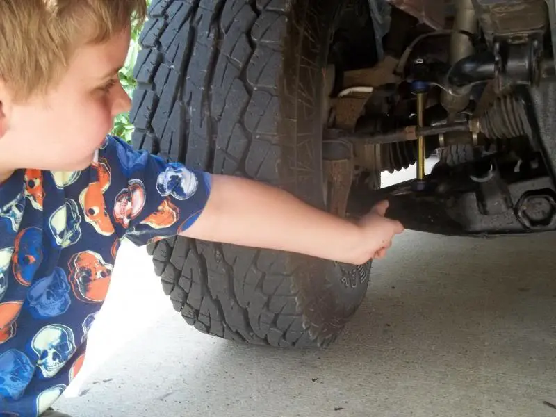

Here is set of what I am sure are factory front sway bar endlinks, with about 130k miles on them.
I'm 99% sure the previous owner would not have changed them, as she drove all Kansas flat miles.
They were not disconnected while we were in Colorado last summer, We drove on some pretty rugged stuff.
IMO they look good. The bolt is a bit rusty, they aint purty but they were functioning well.
However in previous trips out there, using energy suspension bushings, one day and they would be chewed up and fall off leaving only the steel parts rattling around.
So, I am going to try this set of MOOG with the softer blue rubber bushings.
My grandson was here, and wanted to work on the truck, so we got them swapped out pretty easy.
I asked him which set we should go with and of course he said "the blue ones." That's ok, he's still at a young impressionable age, if it is prettier it is better.
I have my doubts. We'll see. I still feel the factory links are the best all around option, and have never seen an aftermarket set last over 100k miles.

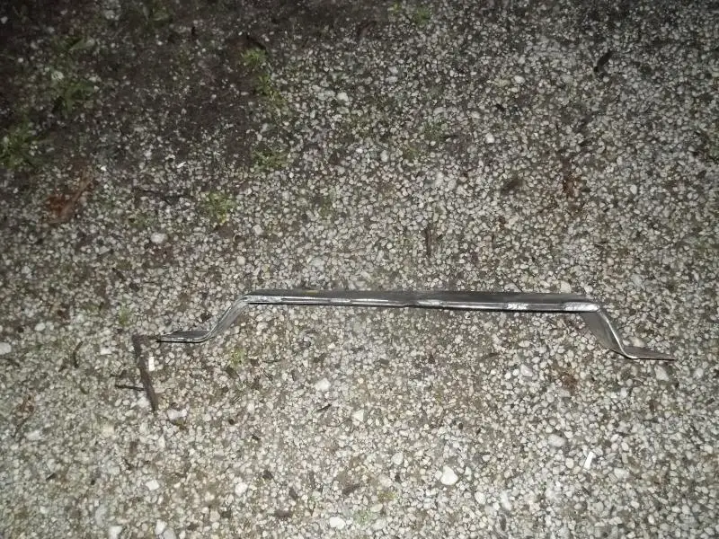

I think now we'll hook up these rear sway bar quick disconnect thingys
All of the sudden I am not feeling (the need for) the rear sway bar.
I am going to try to drive around here for a week and see how much it is actully missed. I think the coilover assist shocks should help . They don't seem to hurt stuff-:D

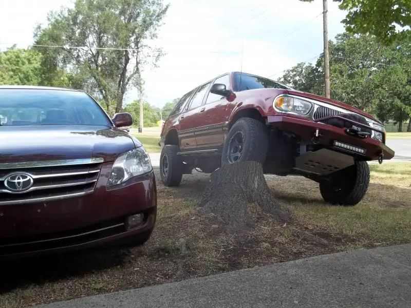

The slightly longer shackles seem to help, looky, 5th shock is still attached.

I'm curious to see how those rear sway bar discos work. I can't quite picture them.
I haven't installed them yet because I am getting new link bushings first, however, you basically "flip" the endlink over, Remove the top frame lock nut, install the threaded stud and nut removed from sway bar end to the frame, and then use this clevis dealio to lock the now open hole end of the endlink to the sway bar. Let me dig for a picture of an installed set-

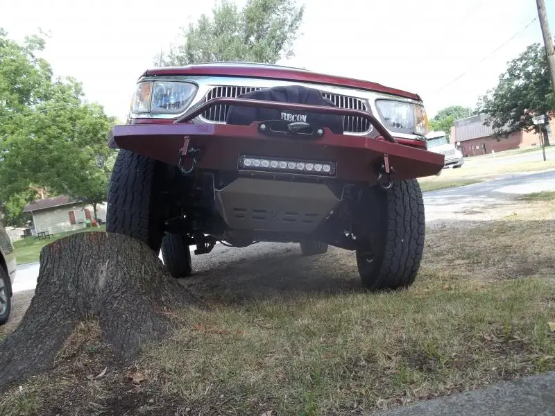

Two heads are better than one, and 2 wheels are better than one, so 2 transfer case skid plates welded together ought to be better than one.
Right?
Nice, will look even better powdercoated. Red Betty is looking great Jon! The front bumper with the light bar is a thing of beauty. And since the new name change I cant stop thinking Bam A Lam!! Whoa Red Betty
