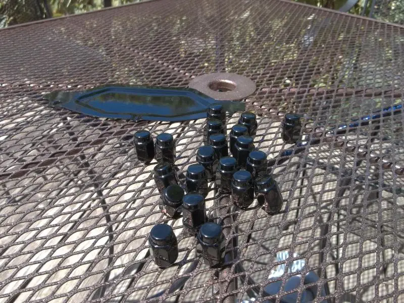

OK, I got the torque converter nuts off, separated the wiring harness from the block and got the 2 bolts holding engine to motor mount plate on passenger side. The transmission inspection plate was all icky so I just gotta sandblast it and make it shiny black.
I have been using zip lock baggies and a permanent marker to separate and label all hardware.
