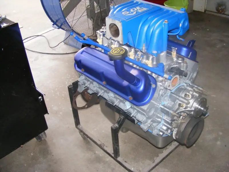

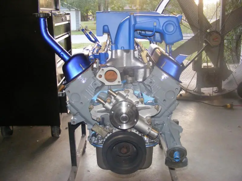

I submit samples 1 and 2 for the boards approval.

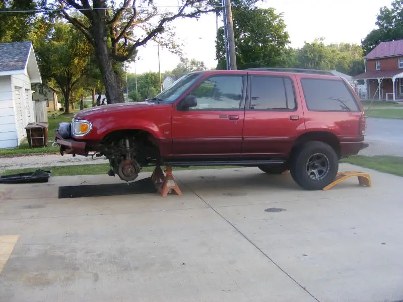

Poor ol gal. I got her jacked up to remove the front fender liners, been so long since I drove her she dropped wheel weights right on the ground when I backed her down the driveway a few feet. At least I know which wheel they fell from.
Looks really nice, Jon!
Thank you. :D

What kind of powder is on the valve covers? Looks like a nice color, with a sheen instead of a shine. Pretty cool.:chug:
Thanks. It was an experiment with 3 different coats.
Just so I don't have to type it over, post 553 in this thread ;)
Very cool. I would say the experiment worked:chug:
