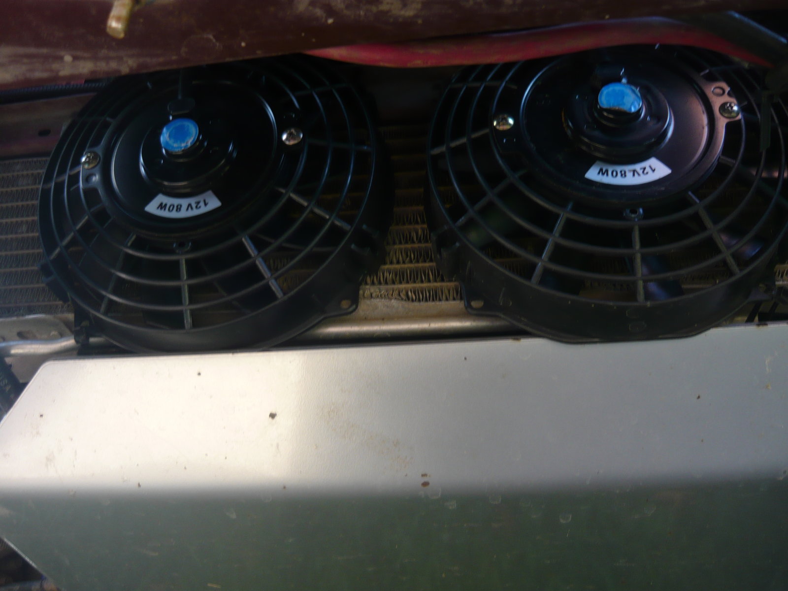

1- I got the 2nd trans cooler fan installed
While I was down there I was trying to use cigarette smoke to check airflow with only the engine fan. Sitting still, the smoke was dissipating to quickly so i flicked an ash. The belt driven fan sucked that ash clear through the trans cooler and ac condenser and it disappeared. Impressive air flow right there. This was without the electric fans running. I'm happy happy.
so, then the problem.
2-There is a big rubber hood bumper on the driver side, with an oval mount hole to allow water drainage. as luck would have it, I mounted my new cooling fans relay sideways, on the inner fender lining right under that hole. Then it rained real hard. Guess what happened?
thats a vaguely familiar setup! You shoulda used the red fans though.. ;)
I was going to but I didn't want to copy you. :D OK, Ok, I copied you.
Imitation is the sincerest form of flattery. :)

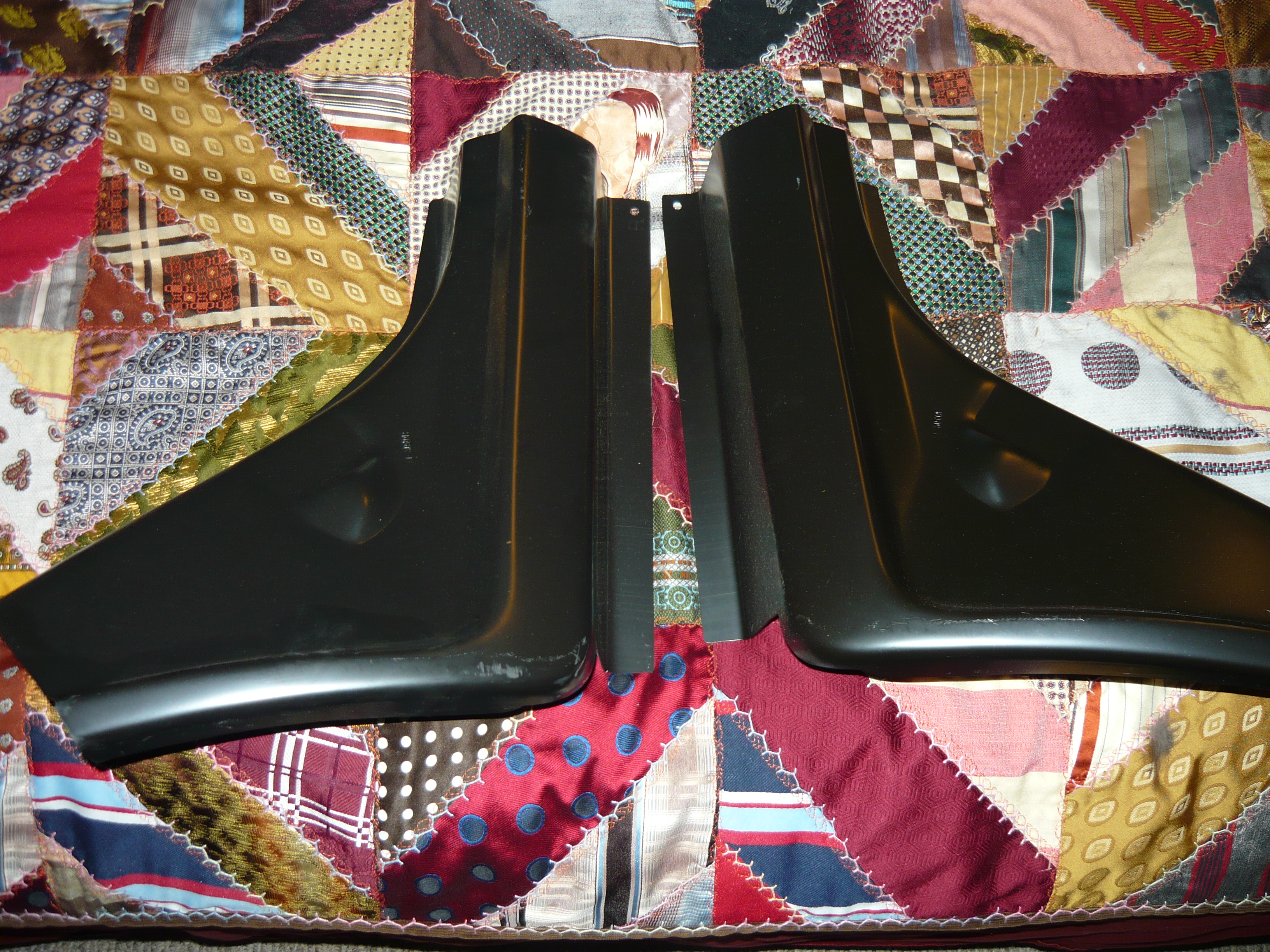

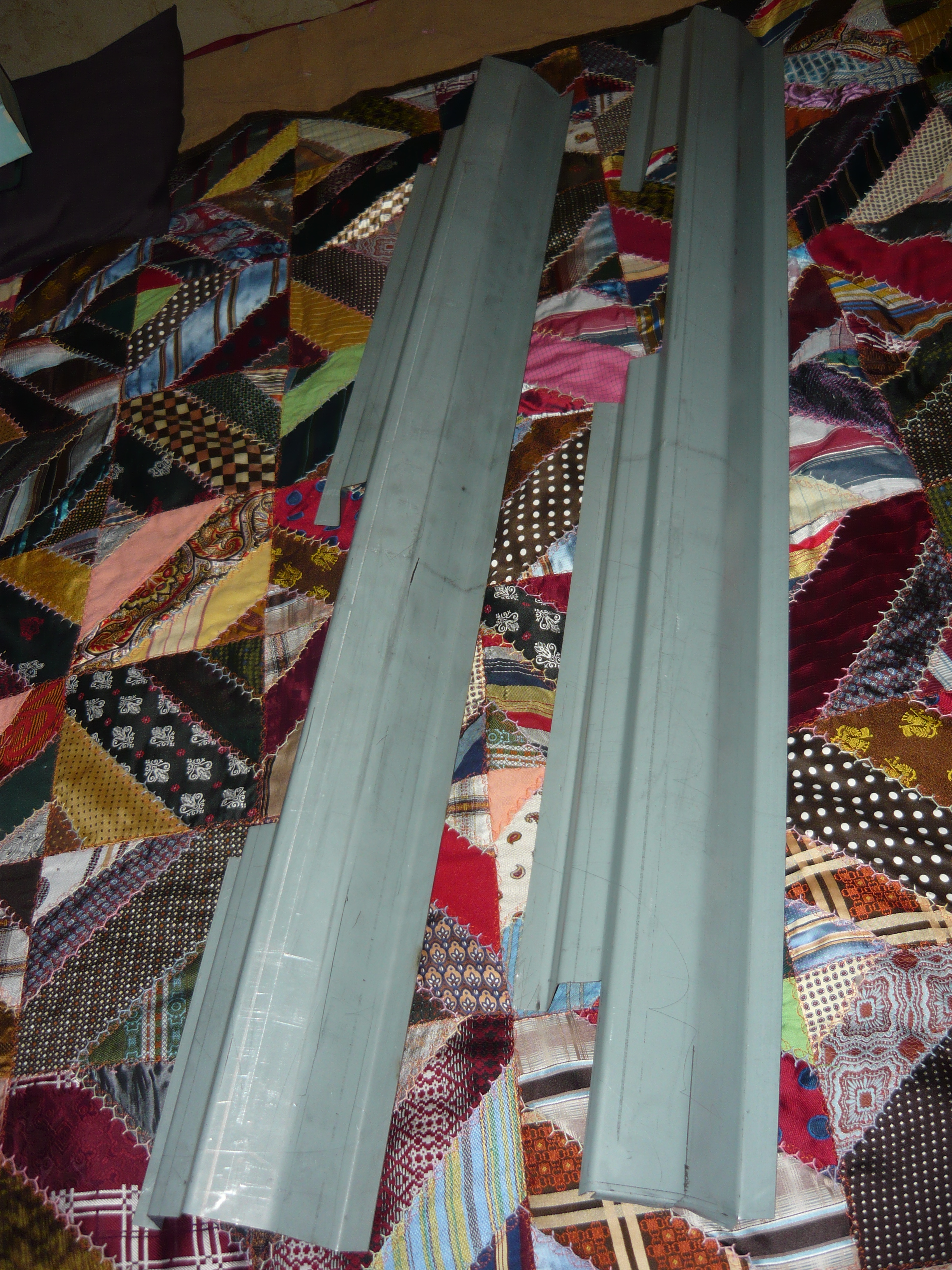

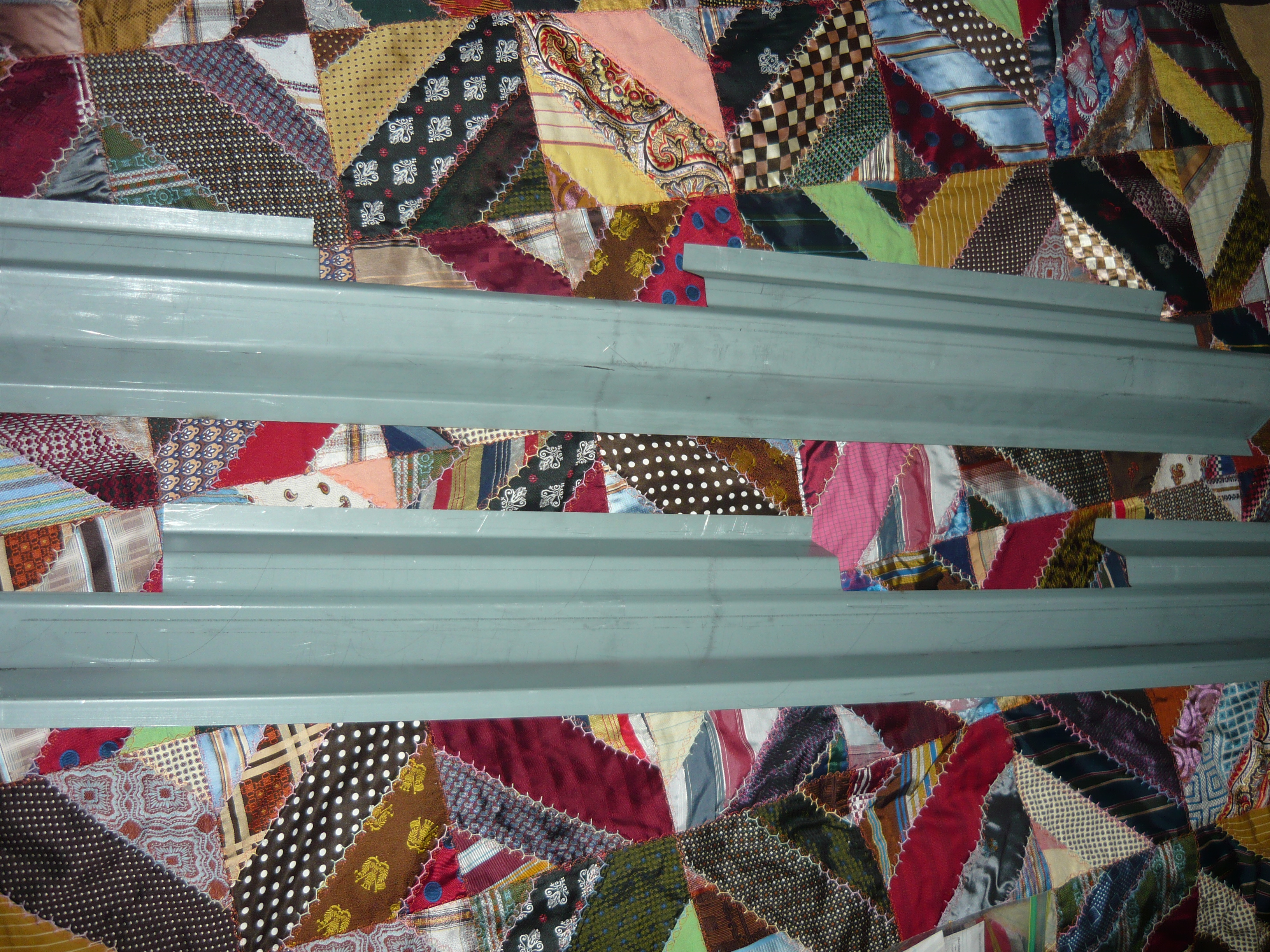

Finally, after months of waiting Betty is going on for rust repairs. I purchased lower dog legs and rocker panels late last year but one thing or another has put either $$ challenges or timing with the body shop hurdles,
Monday is her day. I have the interior gutted , she's been a 2 seater for quite a while now.
Where did you find dog legs for it? Been looking for them for a while now.
For the record, Betty isn’t as bad (from what I remember) as you think. Take a trip up here. Most of them need to be repaired from the door handles down
can you take a picture of the ones you have? both side view, and bottom view if you dont mind.....i mean after your done barfing up the taccos's *bluch* :fart:
Habanero sauce makes anything go down.
Do you want pictures of my rust or pictures of the stuff in boxes?
