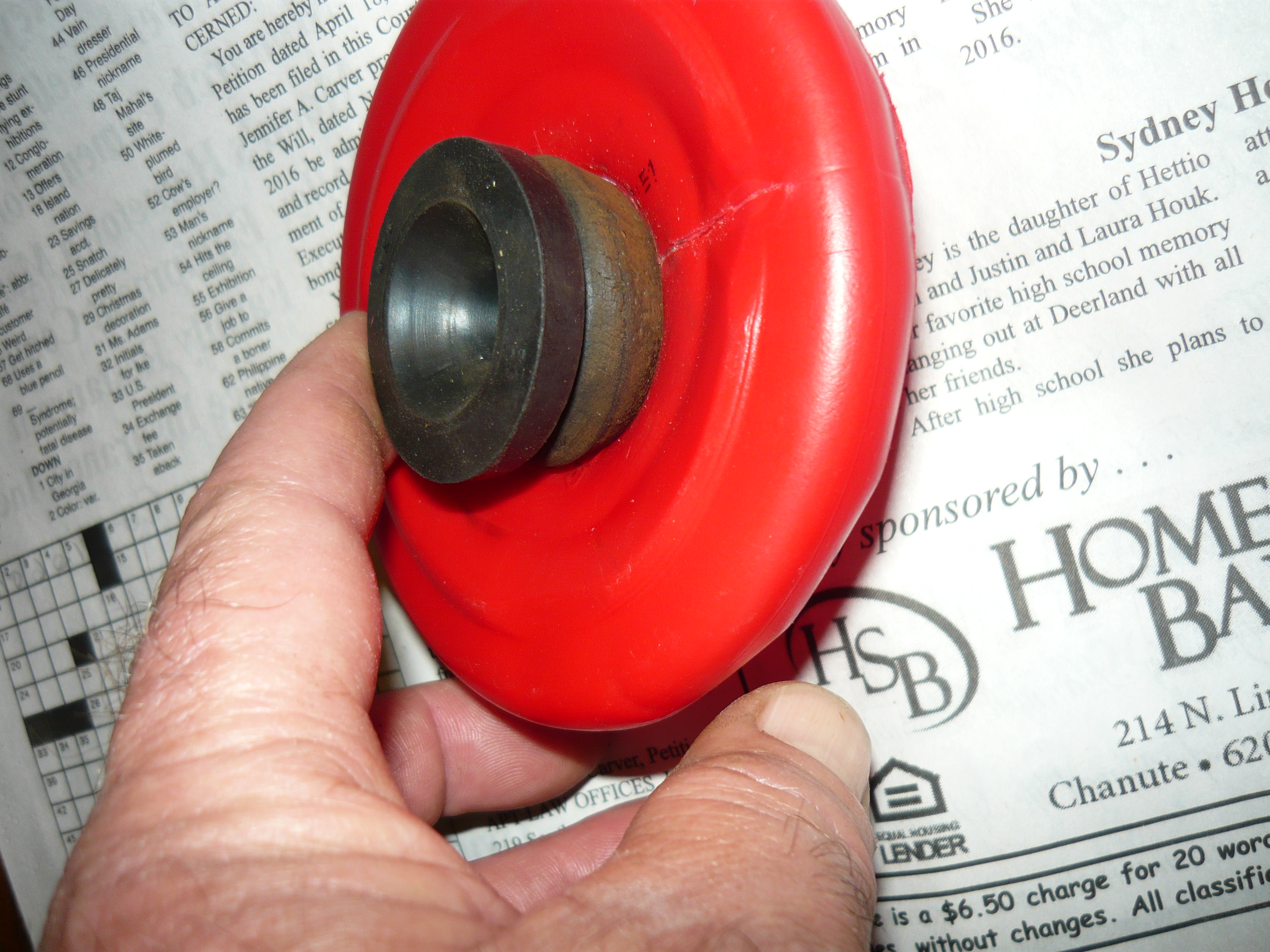

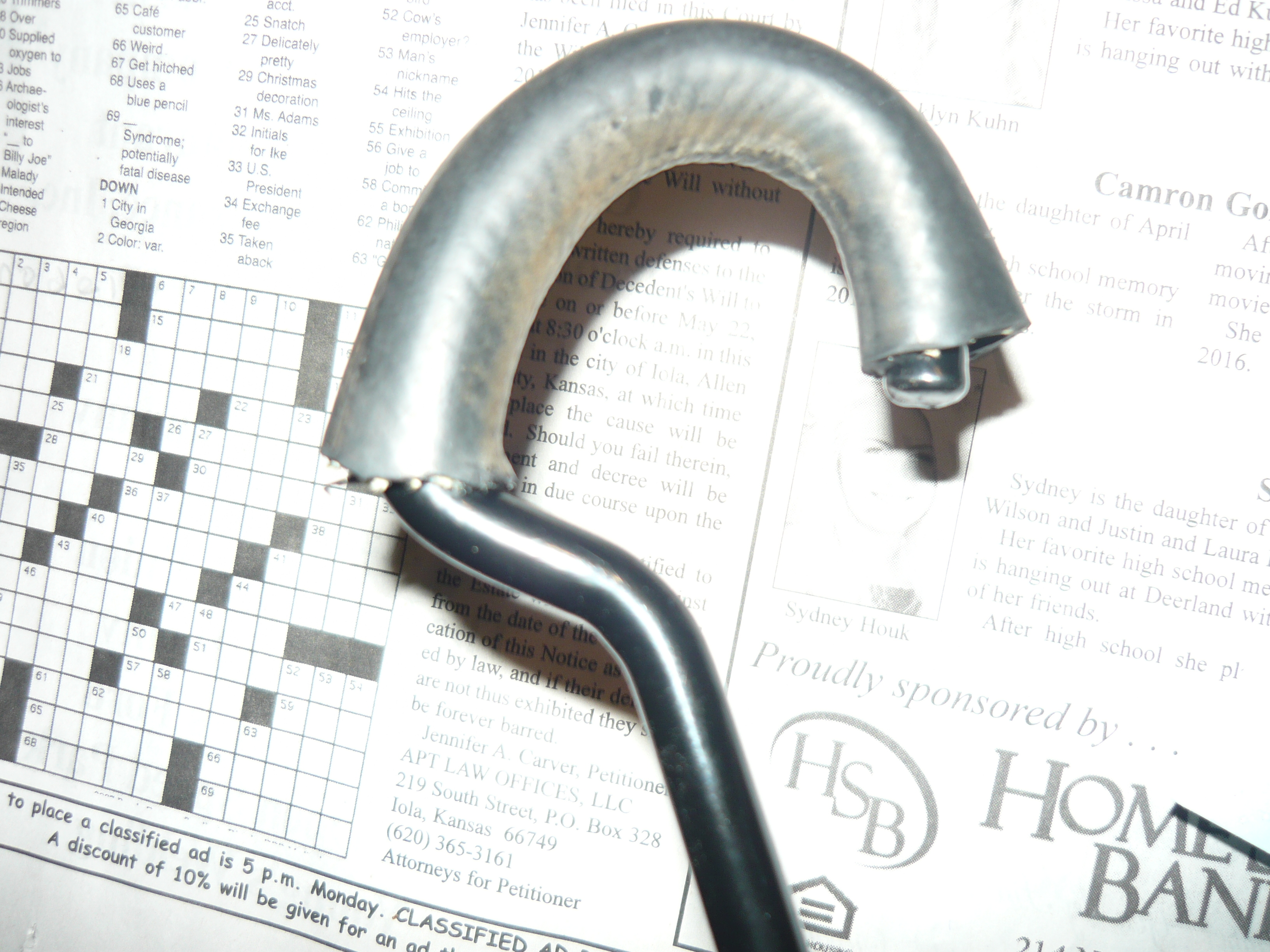

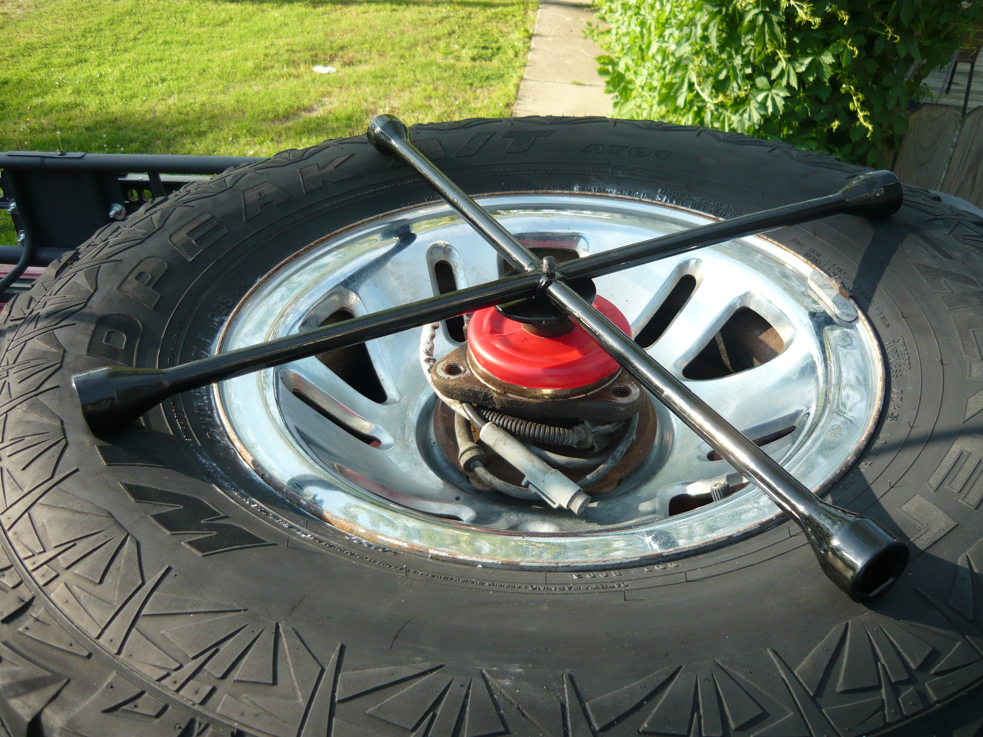

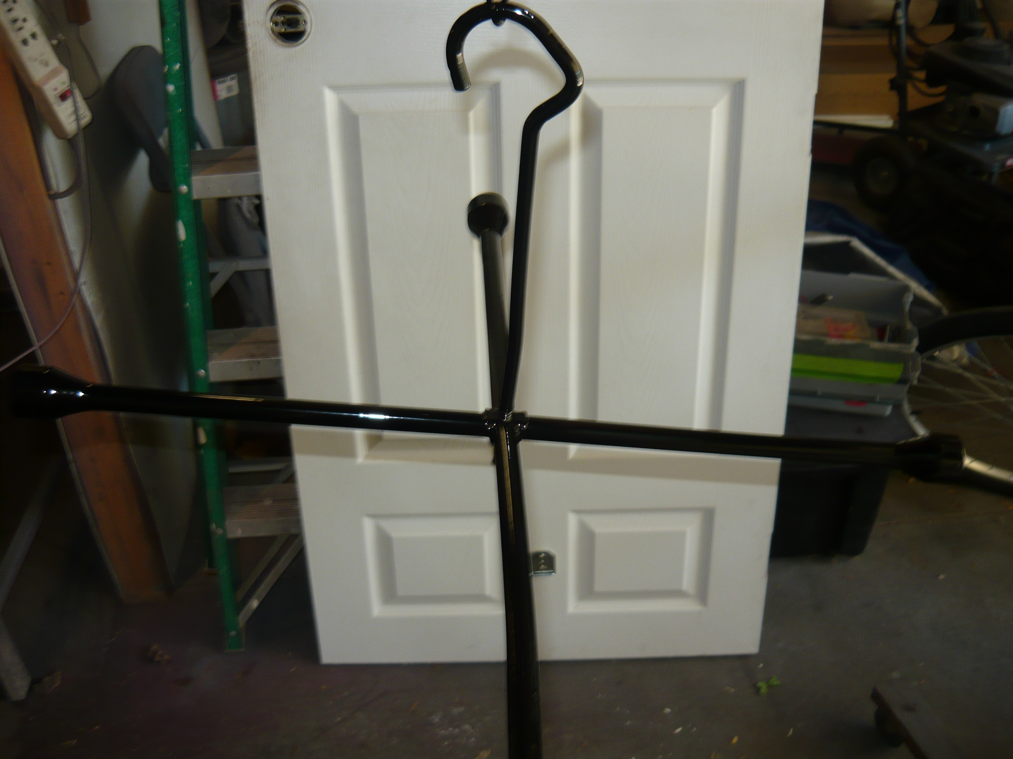

Today I did this out of stuff I had laying around. If it looks interesting to you guys I
will do a write up.

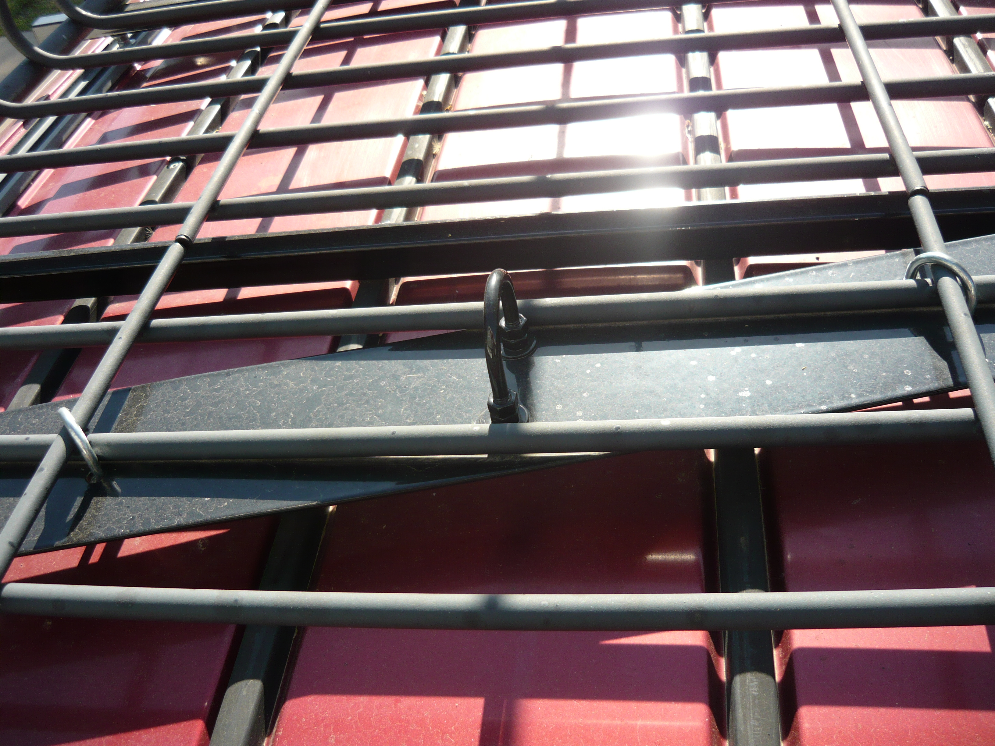

Store trail repair hub, 4 way tire tool and spare tire with one assembly
Cool! Any thought to security, ya know In case someone dishonest wants the spare?
Was thinking of a lock lug like folks use on fancy wheels...
I was thinking a fence charger
Weld a couple of loops to the 4 way, run a bike cable/chain lock thru the tire to the basket.
Now to help you muscle it down. .
You can get a set of locking 500 lb drawer sliders, weld pivot points in the middle, and slide off the back, then let it pivot downward far enough, to grab it while standing on the ground. Could use 3" angle iron on both sides for the sliders to bolt too. That's the set up used for heavy large 12v overland fridges.
Thinking of a telescoping ( articulating?) boom with swivel base.
But then you have to fabricate a mount strong enough to handle the forces in one spot, and most likely have to go thru the roof down a pillar.

Full extension 500 lb slides go up to 60" in closed length, and extend to double the length out. Say you used a 36" slider....the tire will sit within the closed 36", and extend outward 36". Basically this allows you to slide the tire effortlessly 3 feet back, off the back of the rig. Add the swivel hing bolt at the outside end of the mounted sliders, and it will angle downward when the tire is moved back 18". That's half the tire and wheel below the roof line.
Those 36" 500 lb sliders are extremely strong, and are also expensive at $125 set. These have the thumb locks built in them tho. 250 lb 36" sliders (max L ) are only $50 set, but have no locks. Well, might be able to find some made in AUS, but yeah.... Heck with that.

drawer slides sound good, but what gets the tire up and over the side rails of roof rack?

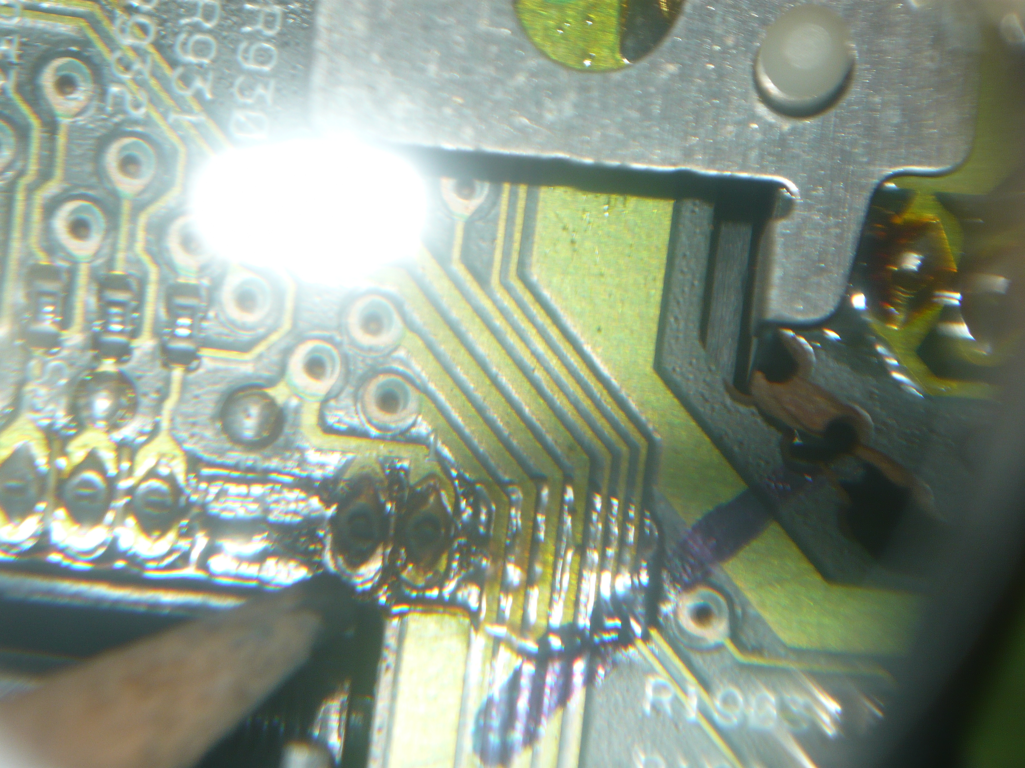

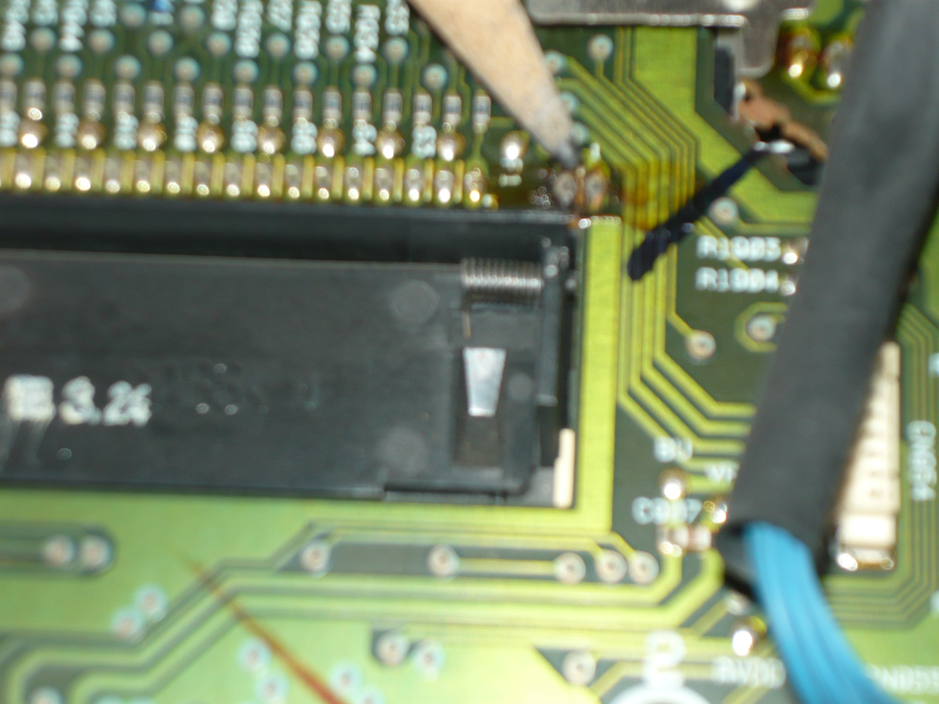

For those with " non working display mach radio RDS button compact disc changer "
I finally found a vendor on ebay who had "certified repaired by ford service" display power supplies for Mach head units with the RDS button. I bought the last one.
It arrived today to my great joy. I have been living with a dead display for quite a while now. Tried repairing it myself and it didn't work .
So, I excitedly tore into the radio and got the new board in , back together, stuck it in the hole and no dice. No display. Bummed, I sent a note to the ebayer telling them the part did not work. The response was "read description"
In the wording it stated if this did not bring the display back something else was wrong. Ok,
Opened it back up, and decided to look the face plate display board itself over real good. Look what I found. I mean just look at it.
Hope you can tell by these pics where the 2 bad solder joints are. I resoldered them with the result of bliss, and joy. All is right with the world now.

Excellent, good save on the radio. Do you have one of the Dorman display boards, that you might compare it to the Mach board? I have one but haven't had time to open up my spare Mach to dig into it.
View attachment 158701 View attachment 158702

great ideas here. I like the tire carrier and handle assembly. you could drill the hold down bolt and run a small master lock through it (If im seeing it correctly)
