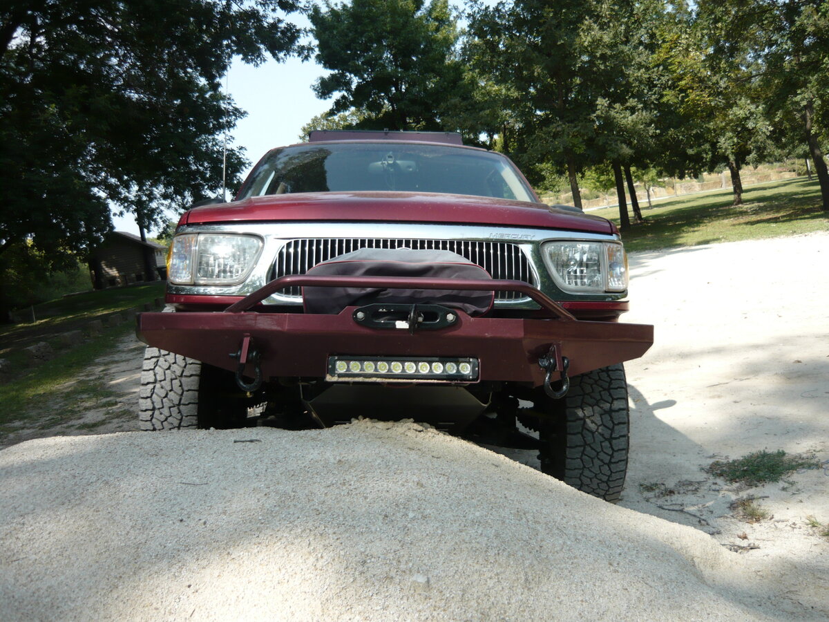

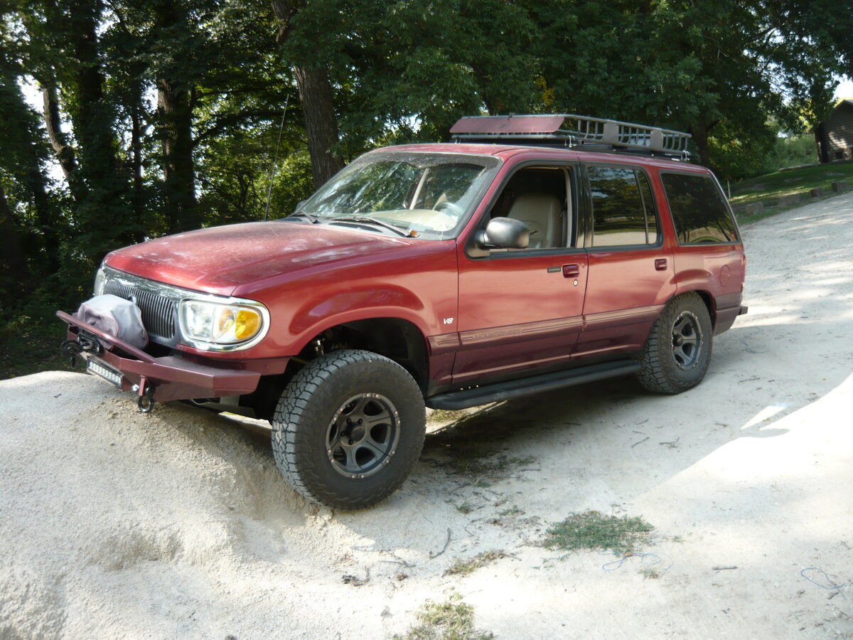

Well. I think I have enough to build a "how to" for the coilover install but it really turned to sheetshow with buick brake lines requiring adapters because my factory lines were not fitted with deep enough fittings, weird noises in the suspension bushings even though they are all new,
-city wide garage sale, broken dishwasher,forum goes down, grandkids requires a birthday party, Highway patrol officer using betty for a driver test, you know, normal stuff.
but here ya go for now.
she does want to be a mule
