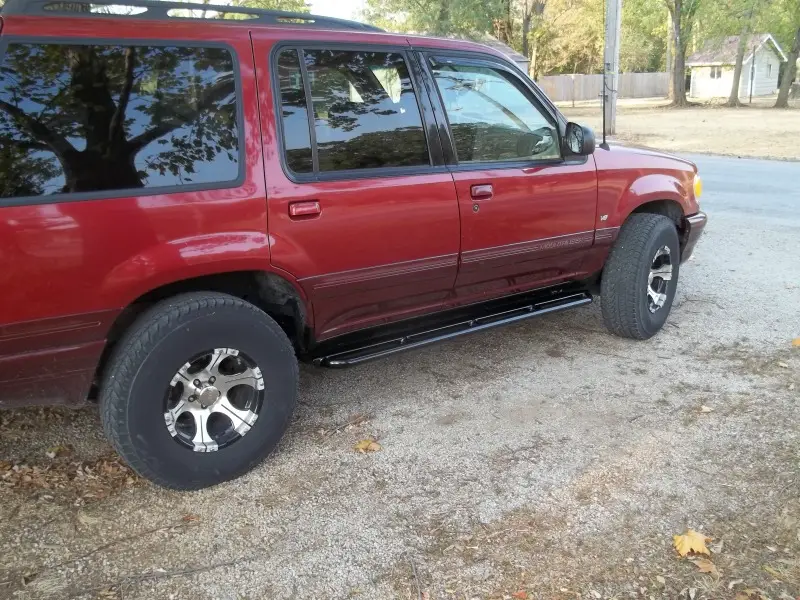

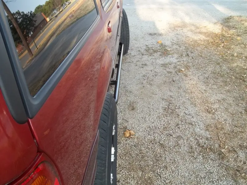

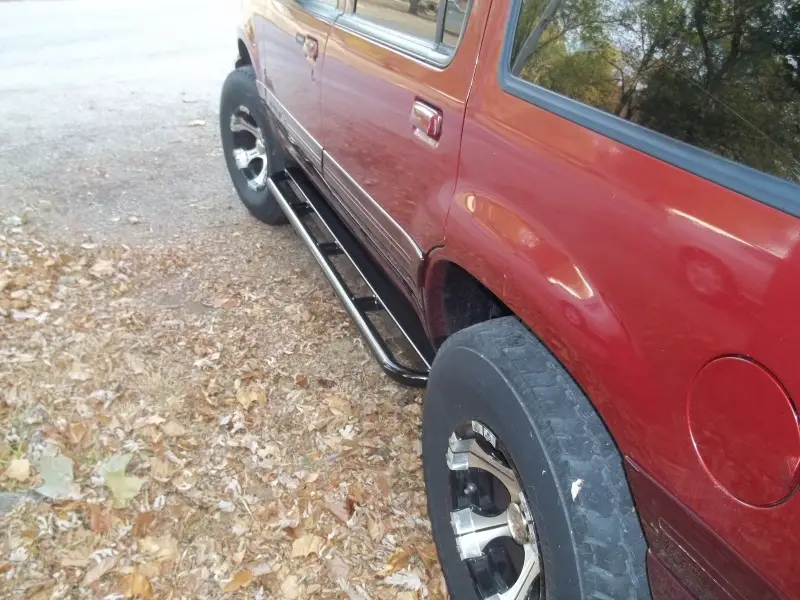

Rock Sliders, installed with a fresh coat of shiny back
:thumbsup: Awesome match Jon! Man I miss coming down there. We might have to sometime soon! Truck is looking Killer!! I'm digging those wheels too. I may have to do that next year at some point!

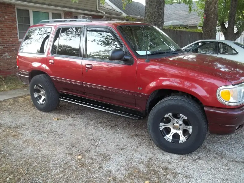

Hey Jon is that the stock roof rack? I like that alot better than the one on either of mine it looks more like a second Gen.
Hey Rick. The Mountaineer roof racks are unique, and, I do think the mounting studs are different than explorers.
How did that do to powder coat the other Mountaineer rack? I've looked at mine and noted some plastic and rubber. Did it come apart easily to powder coat? I'd like to get mine done.
I think if i can get mine back on the road I wanna try to use one it kinda looks like the tremor concept
Hi Don. We actually painted the green rack. There is a toxic green paint available on the internet.
Ah, shoot, I was hoping you had "fixed it" permanently.:(
Oh, I forgot to mention that in this thread.
Thanks Pete! How do they look?
Folks, these are Mountaineergreen's sliders, AKA corkey's sliders which were shipped to me. They have been sitting in my garage. I asked Pete if I could use them, and he said ok, since he is all the way in Canada, and they don't have real rocks up there to worry aboot anyway---
Yeah, I'll have to pay him for these some day, I reckon. :) Right now they are in storage. :D
Unless he gets here to grab them first. :p:
In that case we might have to just build a set for him.
My poor old Mountaineer's parts get around. Those are off my old Mounty that I sold a about a year & a half ago to another member (now ex member).
The set of wheels I had on it before that I sold to Jon which he sold to gmanpaint which I think ended up on Corkeys Explorer:confused::confused:
Actually, Dan, they went on Bryan's truck, then to Gmanpaint.
