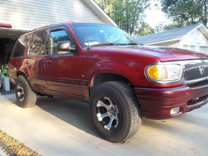

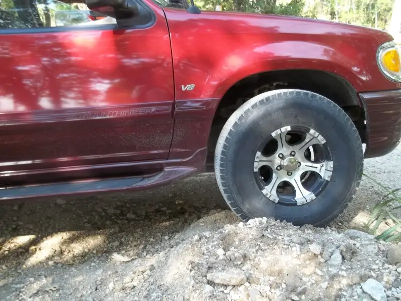

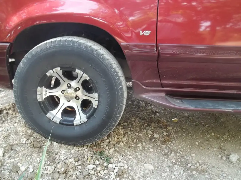

We needed larger tires if we go to Colorado. My lovely bride said no, but Gmanpaint and Twiztid said ok.
So, I accidentally allowed Puff to bolt on a new set of shoes.
I'll probably re coat the wheels later, but for now they will do the intended job.
Those look awfully familiar. They wouldn't have happen to come off a certain '97 Mountaineer would they? :D
Wanted to check for tire rub.
coilover helper shocks in rear, all swaybars connected. I realize disconnecting will allow more flex, but it also allows more cv breaking. We'll live with this, it will be great for where we are going.
Trying to stay low.
Yup!
There's plenty of trails in Moab for that much (little) flex
I think a little more lift in the rear may be in order, check to see if the tires bottom out on the tubs, mine did with 32's and 2" of lift, so with just coil helpers you may have the same issue. With the limited flex in the front you need all you can get out of the rear.

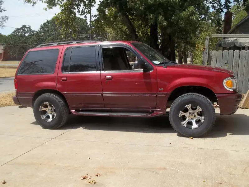

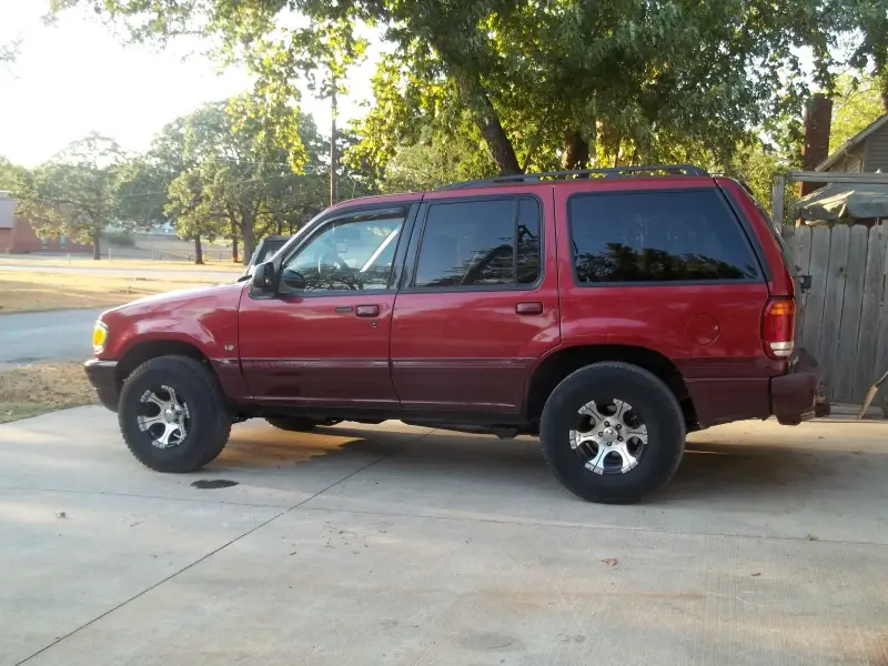

Removed the running boards, and applied herculiner to the rockers. Holes filled with cloth tape.
Looks like it was lifted about 3" compared to this
That looks good, and I'm glad to see that color without the boards on it. I'm wondering if I can find the Saleen side skirts, and then swap my running boards for those. I never use the running boards to get in or out really. I'm on the fence, ...plus very slow.
