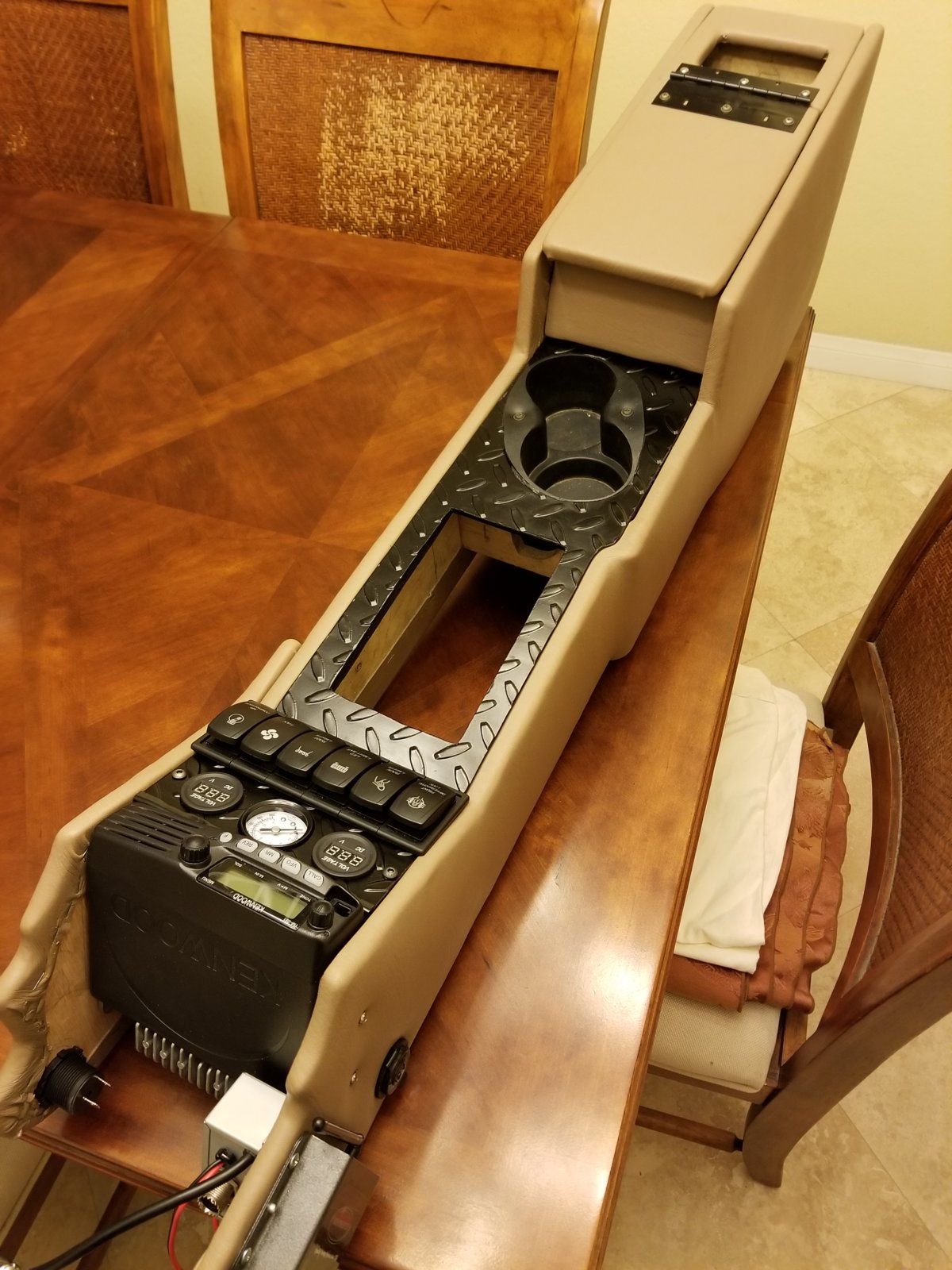

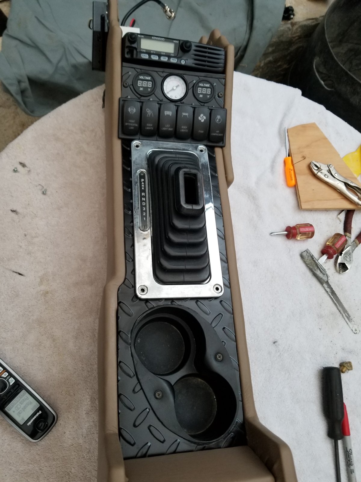

Everything is finally coming together. I got the latest version of the console finished. Behold....
Also spent a bunch of time figuring out something I should have already known about relays. Thanks @Maniac. Also diagramed out all the wiring for the rest of the redo now that I am sure of the placement of all the stuff that needs wiring. I can run all the wiring off one harness with a plug that has 8 wires on one side and 12 on the other I salvaged off the old wiring harness. It will really make things easier when I start wiring. Should get started on that tomorrow.

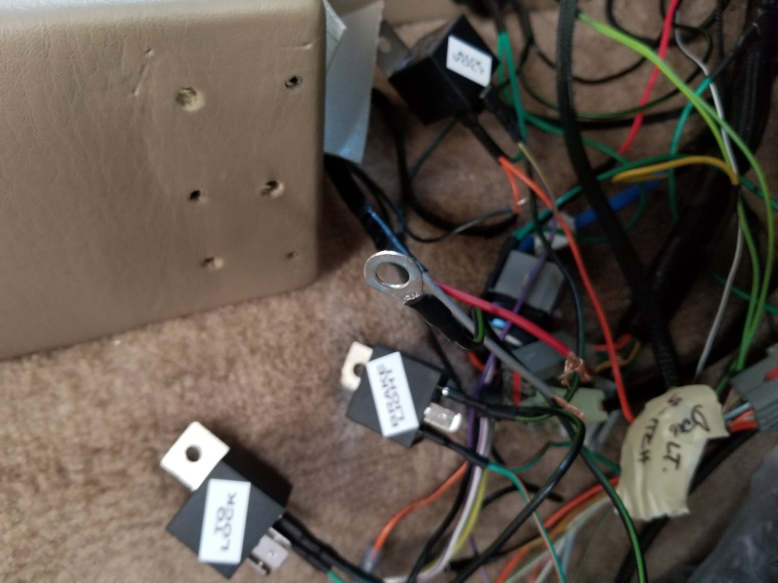

Yesterday and today I worked on wiring, and more wiring, and wiring. Very tedious but I actually don't mind. It requires a lot of thought, and a lot of pencil erasers, to get it all right with the least amount of cutting into the factory wiring. So far, I have only cut into the factory wiring at the power seat wire, the dash illumination wire at the ash tray, the radio on in acc/run wire for a couple of relays, and the radio ground wire for the transmission gauges. I am not using the factory radio power wires for the radio, instead running separate wiring through the auxiliary fuse panel to the auxiliary battery. I like to run the radio/CB/ham without the need for the ignition key.
If anyone is interested, I will post up the wiring diagrams after I am finished. The only wiring I am not willing to post on this public forum is for the anti-theft devices.

And more wiring.....
I had planned on making the console removable without cutting any wires and got to a point where I realized I needed a few plugs to make that happen. Ordered them on-line and moved on to the engine compartment. Worked on cleaning up the wiring, added the transmission cooler fan to ground and to relay wiring, and cleaned up the main battery wiring by adding new terminals. Also fab'd a new mount for one of the two, 200 amp breakers for the auxiliary battery wiring. This one is for the main battery to the auxiliary battery solenoid and sits directly on top of the main battery box clamp. I forgot to take a picture before I took it all apart to work on......more wiring. I cut the wire for fuse #1 (interior lighting) so I could route a on/off switch, and run a wire up to the transmission temp gauge memory. Used the exact same wiring to run the switch salvaged from the old wiring harness.
It got dark so early today that I went inside and typed up all of my notes on the wiring so it was easier to reference. It looks a lot cleaner before its cut and pasted.

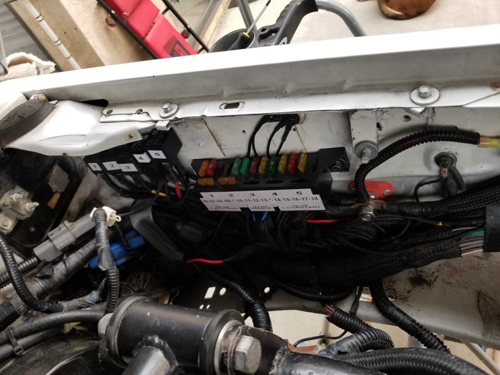

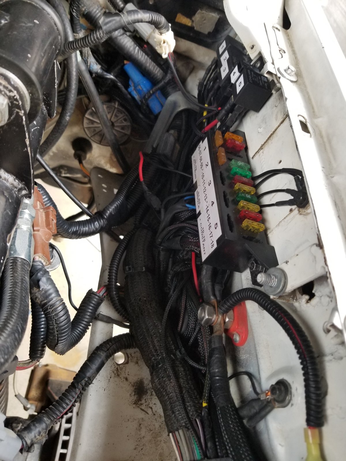

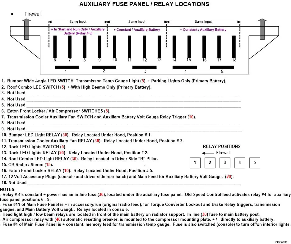

Also redid the auxiliary fuse panel and relay diagram. I actually have three more empty fuse positions than before. It could change at anytime.

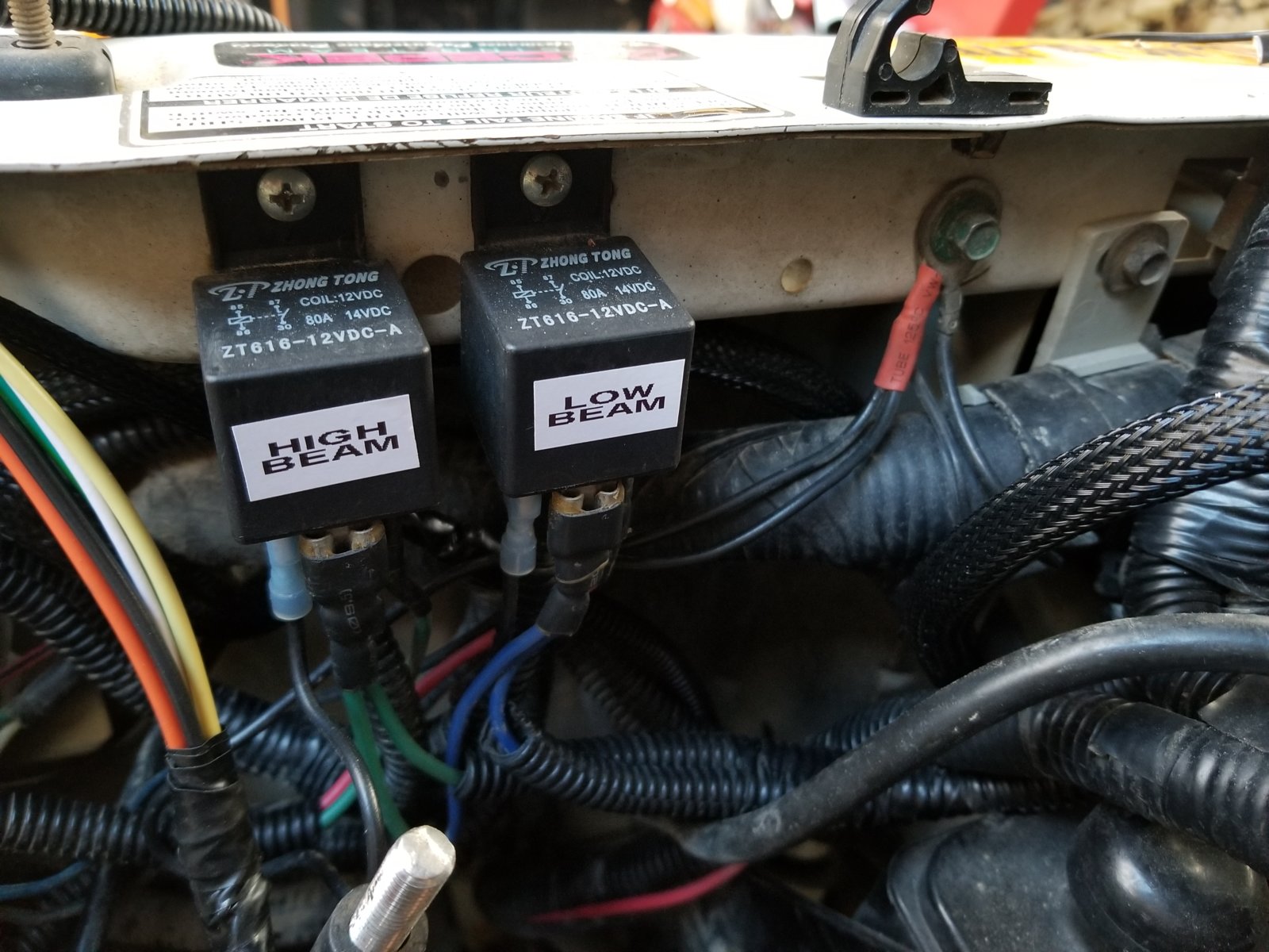

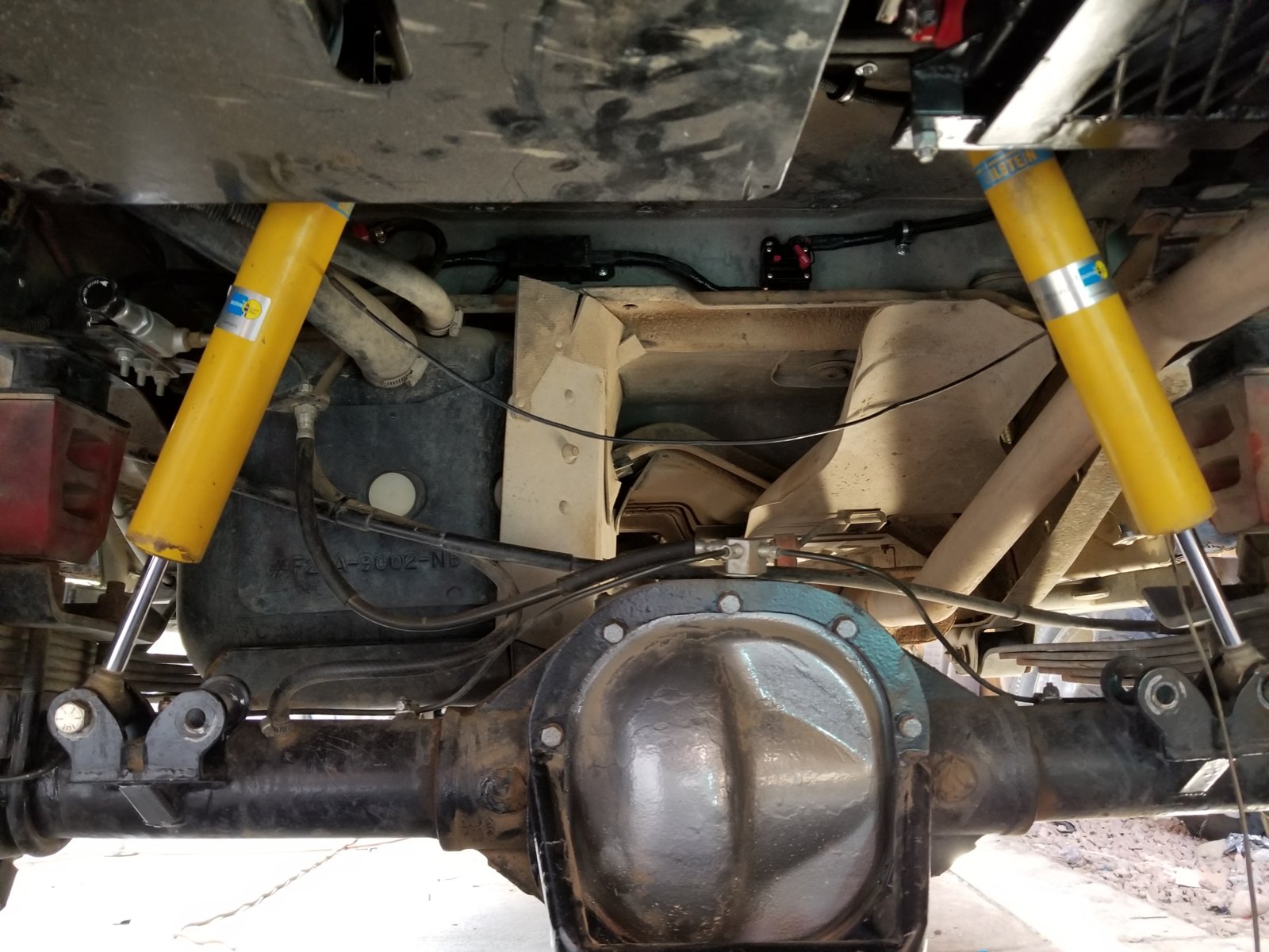

Got the auxiliary battery and air compressor wired in and installed. I was worried the compressor was fried because the it's old ground wire casing was melted in places, but it works. Forgot to take pictures of the auxiliary battery wiring, but its the same 2 gauge welding wire from the post in the engine compartment to the battery, but in between there is a 450 amp mega-fuse and on the battery side of that is a 200 amp manual reset breaker. I will hopefully remember and take a few pictures tomorrow.

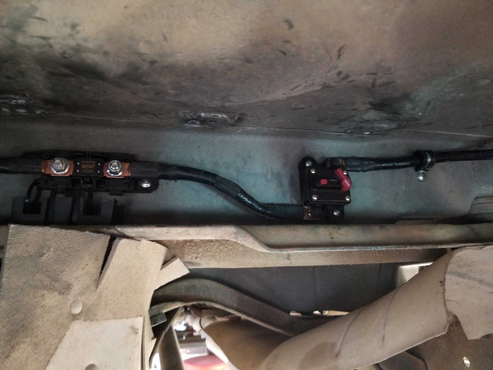

Fuse and breaker location for auxiliary battery. I can sit up in there behind the axle to get to them, and they are safely mounted out of harm's way.
When the red heat shrink tubing I ordered arrives, I will have red ends on all the + side battery cables.

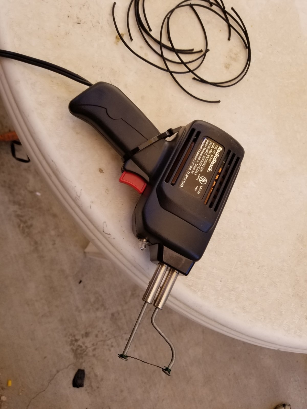

I also made a temporary hot knife out of a few nails and thin wire to cut the braided loom after fighting with the stuff for a month. It works great. I actually thought about going back and re-cutting all of the work I have done so far, but quickly forced that thought out of my head. This is taking long enough already.
Edit: I just got finished with the majority of the wiring! It got dark on me so I couldn't clean it up and wrap everything, but its mostly finished.

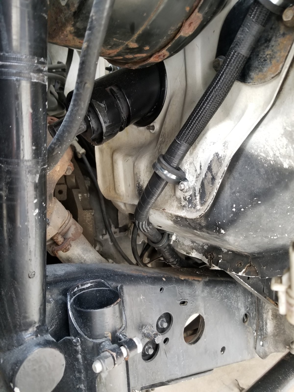

I finished up most of the wiring for the accessories today and it all works. I did a much cleaner job on it this time. Not quite finished with it. I need to drill a few holes in the inner fender to run ties to tighten it up, but I ran out of time for today. I am working at the Fallout Boy concert in a few hours. Here are a few pictures.
I moved the main harness that goes from this inner fender, though a hole in the frame and down the inside of the frame to the rear of the Explorer. Holds the fuel pump wiring, among other things. I moved it over so it isn't exposed outside the frame in the fender well. It originally was covered by the plastic inner fender, which I don't have any more. The 2 gauge wire running to the auxiliary battery is in the same loom. I double sleeved the battery wire with expandable weave loom all the way to the back, then wrapped the entire wiring harness in more loom. The picture makes it look close to the exhaust, but its actually farther away then in the original position. The round hole in the frame is where the harness originally was routed. I should weld a plate over the hole, and the two mounting holes for the ABS speed sensor which is no longer needed.

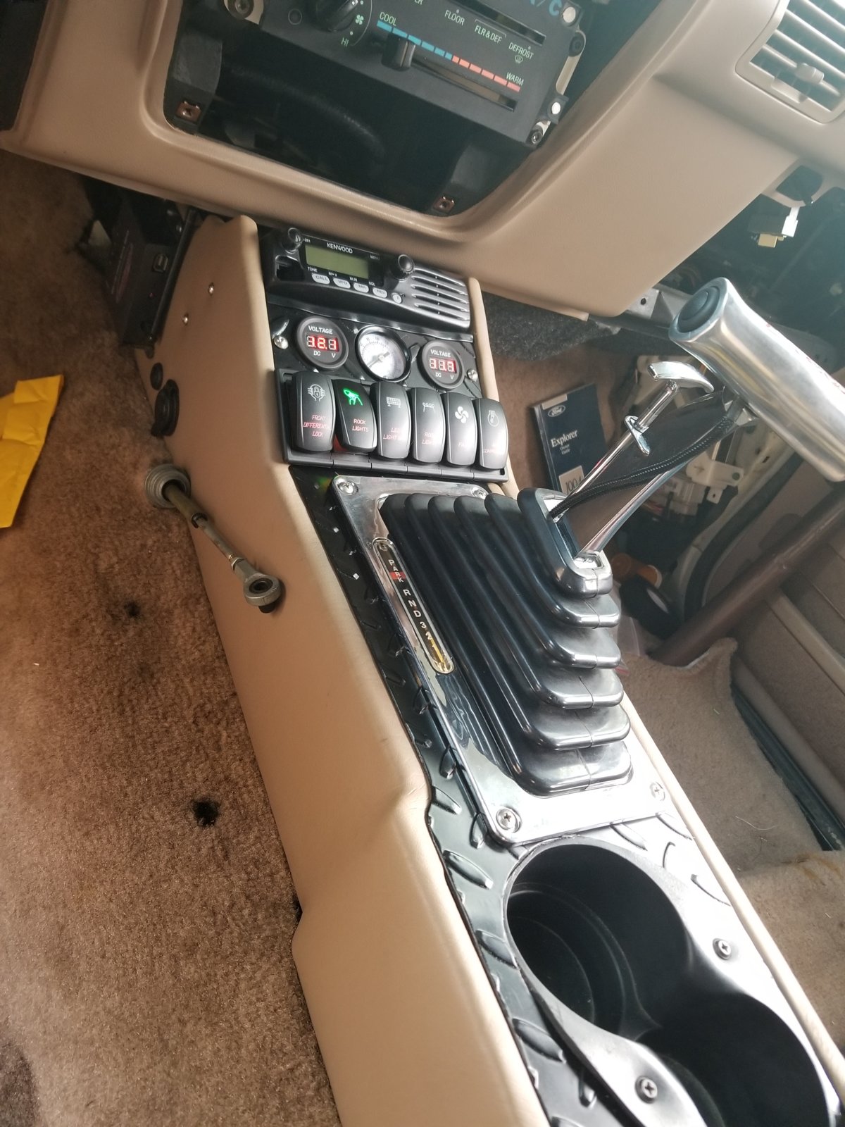

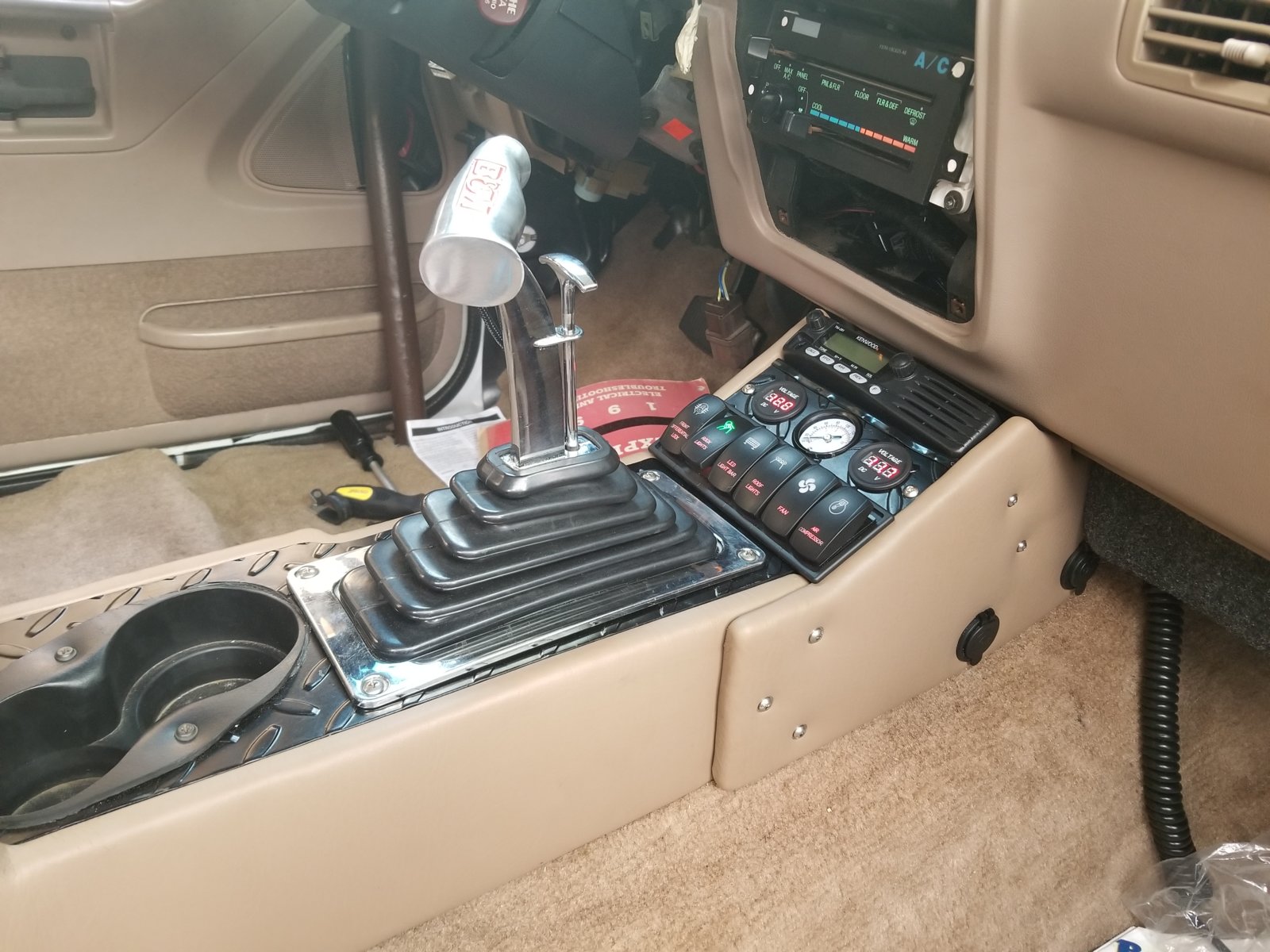

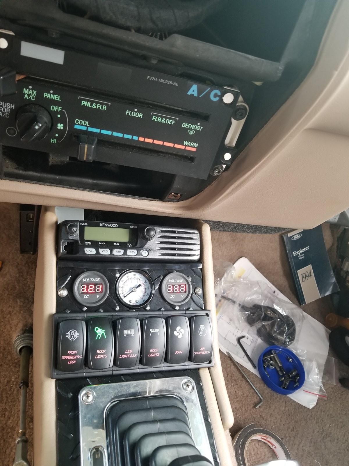

Center console done! Well, almost. The switch pod is not very secure. I need to add some metal strips to both sides to make it fit snugly and not pop out of position.
The gap above the radio was intentional. It will help dissipate the heat generated by the ham and CB.
I need to install the alarm and stereo, and the electrical will be finished, except for little details. I ordered different battery terminals because I purchased and installed some other terminals, but they don't have enough metal on them for my liking. After the alarm and stereo are installed, I can button up the dash and finally install Rock Ranger's double mic mount. I also might have to move the CB if it causes interference with the ham or vice-versa. They are next to each other in the console. I can move it under the dash if its a problem.
Should get started on the mechanical issues and interior next week:
