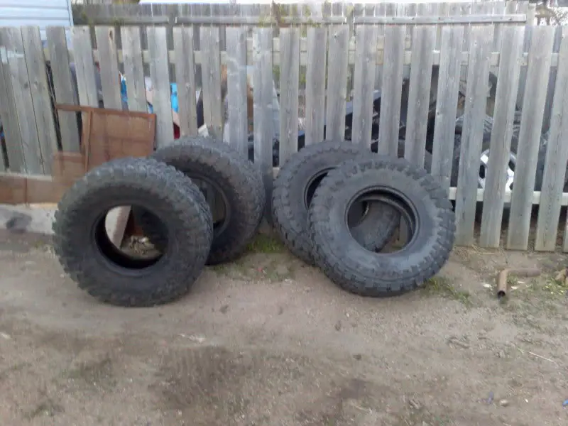

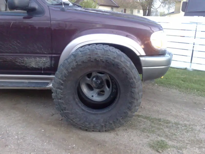

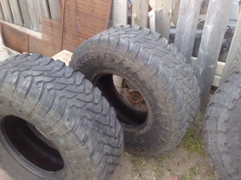

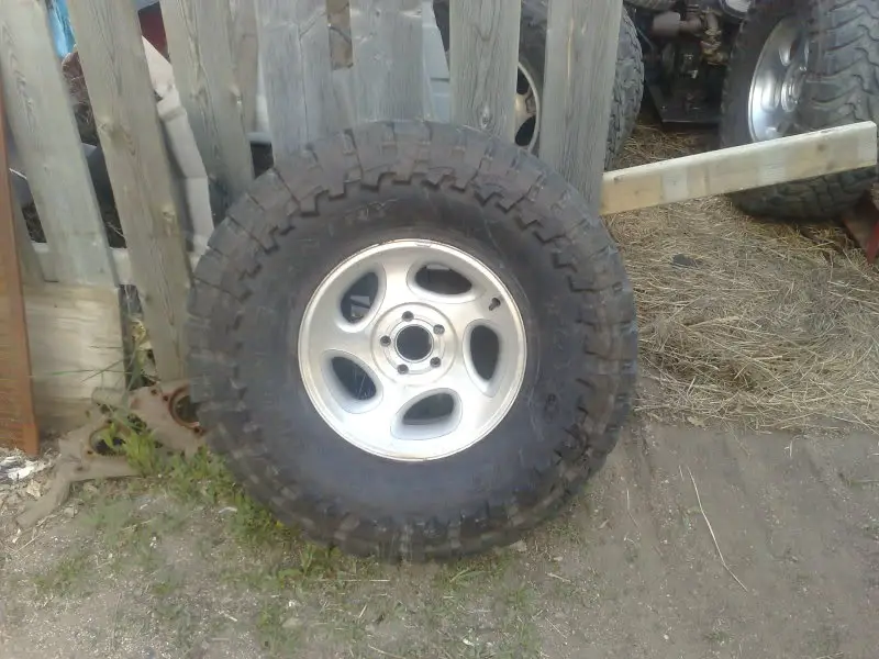

However... I did get some lovely halo headlights, courtesy of Sean99 and these beauties...
They're 315 75 16 Toyo Open Country MT's... and they were too cheap to refuse...
Here they are up against Tankerbell
And I got them mounted on the Sport rims, so I can test fit them once I get the transmission in..

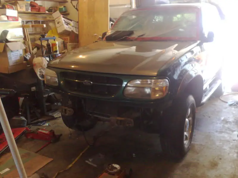

Since we're still moving house, things are going slow, however, I took the chance today to do a spot of "Pickling"..
I put the V8 plaque back on the engine, re-fitted the hood and lined up the bumper with the brackets from the lift kit... I hate those brackets.. the bumper still isn't lined up properly, it's about an inch too low...
I also put on the air dam thing at the bottom of the radiator, so the front end is now pretty much done.
I've just got to get the transmission in, sort the exhaust out, refit the rear bumper, and a few little odds n ends then she can go in for her first inspection.
Si

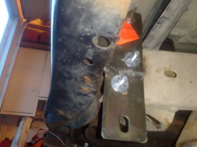

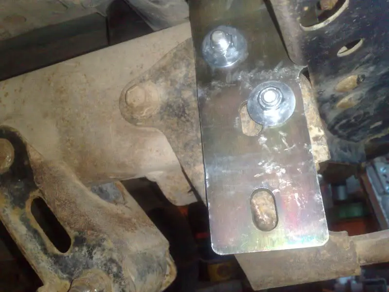

Well, finally got the issues with the rear bumper lift brackets sorted out... I hated doing a BL.. don't ever want to do another one!
I had to belt the crap outta the brackets with a lump hammer, then use a drill press to make new holes.. fits ok, slightly off to one side, but not too noticeable...
I'm now very happy and it's getting closer to being finished!!

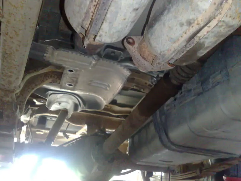

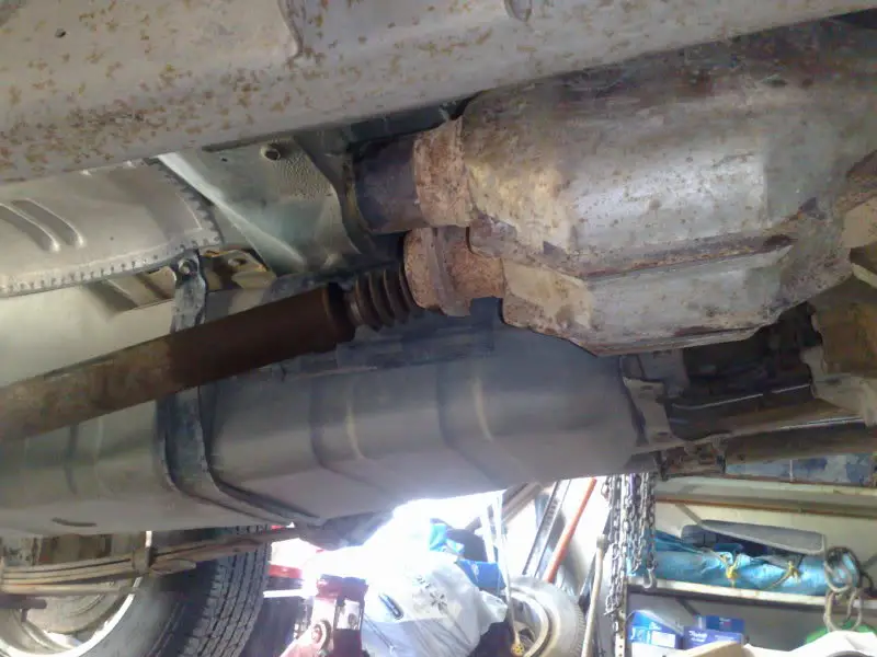

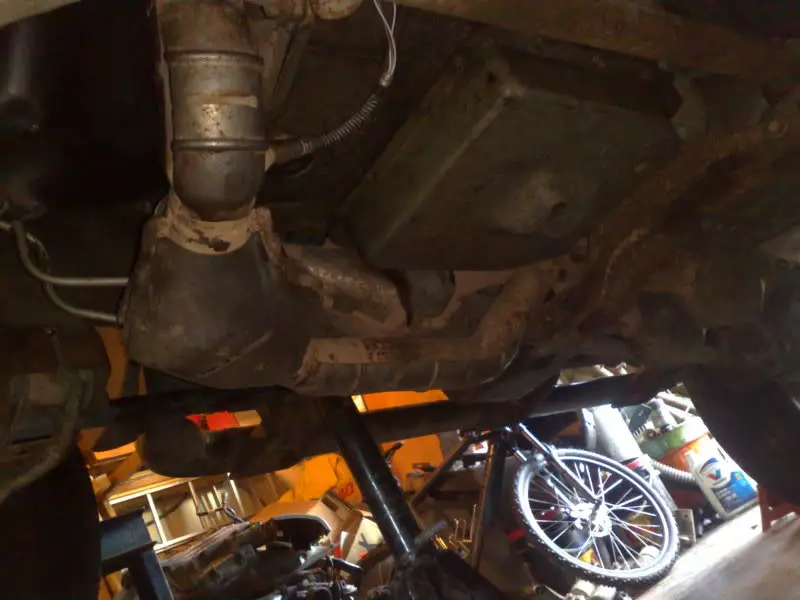

Here's some pictures of how the exhaust is sitting right now
Si

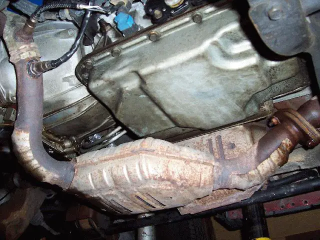

Thanks for the photos. Was the original 4 door exhaust configuration two pairs of cats followed by two inline mufflers? My Sport only has one pair of cats feeding a dual in/single out muffler followed by a resonator. The system appears to be original.
I knew that most of the 4 doors had a front and rear muffler but didn't realize there were two pairs of cats. If I ever switch to a V8 I'd prefer only 2 cats, 1 muffler for each bank, and a resonator if needed.
Good luck at the salvage yard!
The V8 donor I got had 4 cats. Each pipe from the manifold has 2 cats and 2 O2 sensors on them. They are true dual pipes till it reaches the muffler.

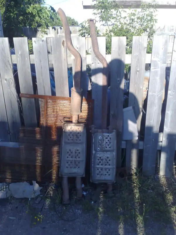

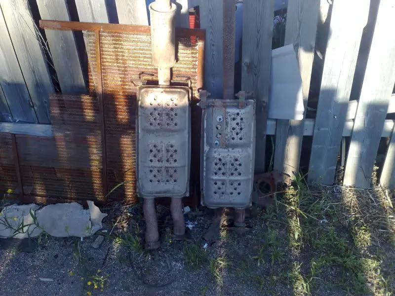

I took some pictures of the V8 rear muffler (left) and the OHV Sport muffler (right) for comparison. They're both the same size, but the V8 has an extra muffler in the rear pipe, they were also the same length but I chopped off the tail pipes to make it easier to get in n out of the truck.
As you can see the Sport muffler is a 1 in, 1 out affair, the V8 a 2 in 1 out.
In order to get through the safeties I have to keep the 4 cats, I can probably get away with some smaller mufflers though.

Here's the best picture I can get of the front exhaust set up...
Si
same muffler & resonator
Thanks for your trouble to take and post the photos. The V8 2 in/1 out muffler with resonator looks identical to what I have. Apparently until now I misunderstood what other forum members meant when they referred to two mufflers. I suspect they were counting the resonator as the second muffler. If I do a dual swap (V8 to 2 door & V6 to 4 door) initially I may be able to reuse much of both exhaust systems. Eventually I'll want only one high flow, 3 way cat on each bank. I wonder if your front cats are only for NOx and the rear cats are 2 way (HC & CO). I think a single (larger than stock diameter) tailpipe is more desirable than dual tailpipes. There is less total weight and complexity. A 3 inch diameter pipe should be adequate for even a stroked and moderately modified 5.0L.
