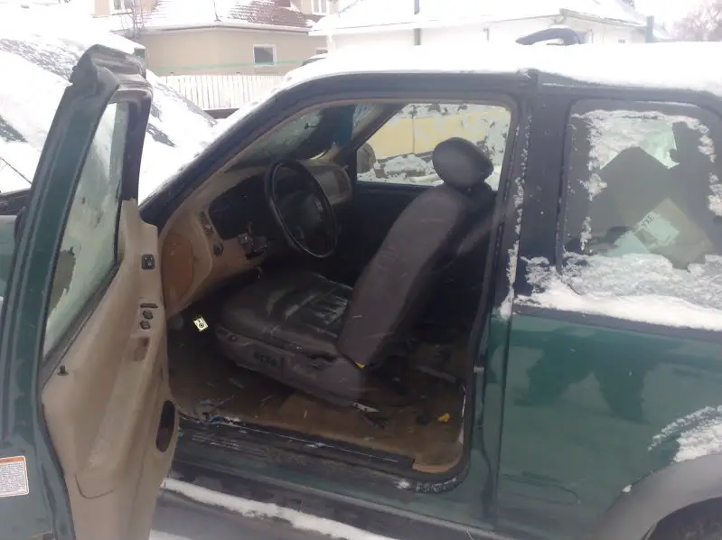

Today I took out the old driver's seat and test fitted the new seat... I also put a battery on it and everything works!!!

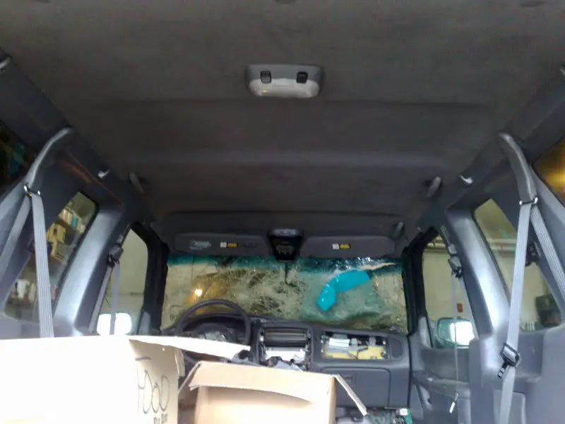

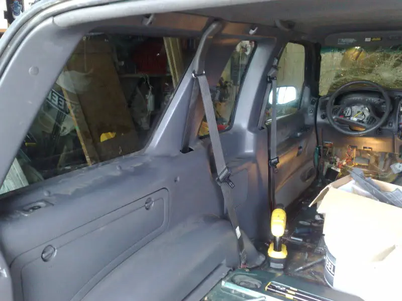

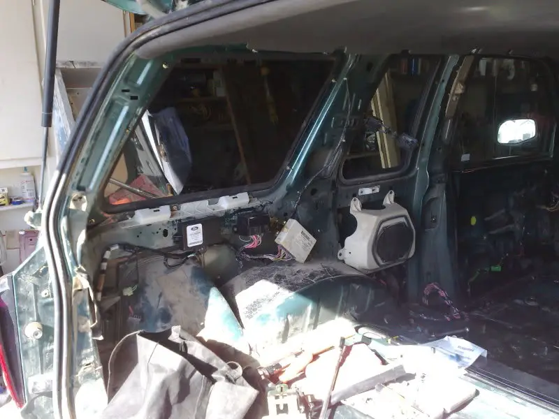

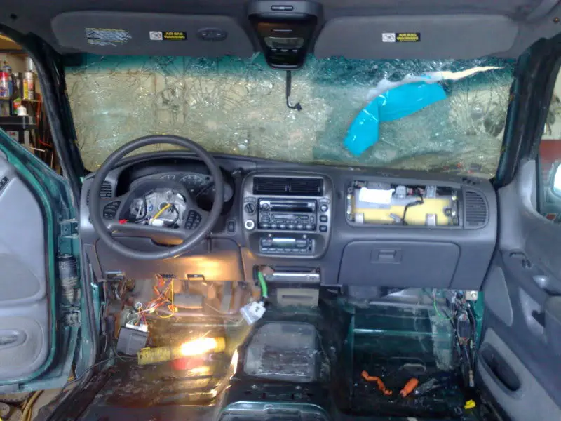

I've done the BL pucks and totally rewired the whole truck (except for the fuel tank wiring, but that's next) all the new plastics are in along with the new dash and new roof lining... and the V8 donor is arriving Saturday evening!!
All the control boxes in the rear
Factory sub
New Roof Lining and Plastics

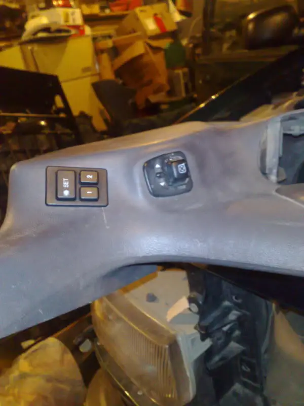

I had to make a hole in the driver's door card so that I could fit the switch for the memory seats (it's slightly wonky, but will do till I can find another door card)

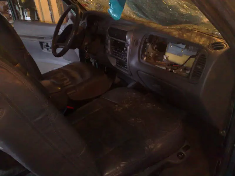

The dashboard was a PITA the get back in mainly due to the windshield being all caved in, but Sarah gave me a huge hand and we got it in, all wired up and everything put back where it's meant to be. I also installed the metallic radio surround found in a 01-03 Sport. Can't wait till next week, should be all up n running!

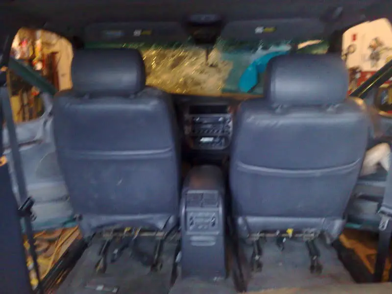

Managed to get the front seats, centre console, carpet and everything else sorted out before supper though, the only thing I've got left to do interior-wise is find some rear seats to match, put in the rear carpet, door surround plastics and I'll be done...
Sorry about the dark pictures.. I'll get some better ones in the daylight..
