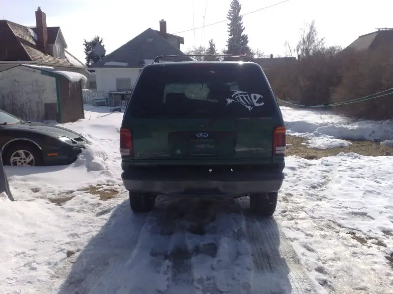

Since 2005 when I bought "Betty", my UK Explorer, I've wanted a sport...
well, now that I live in Canada, the chance has presented itself for me to get one...
This one.... it's a 99 sport, 4.0 SOHC... it's a total write off for the moment... but when I saw the advert on Kijiji I couldn't say no. It needed some love and I wanted a project to get stuck into, so I did my research and found out how much parts are gonna cost me etc etc.
So. I present.. Pickle.. (cos it's green and in a right mess)

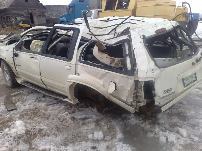

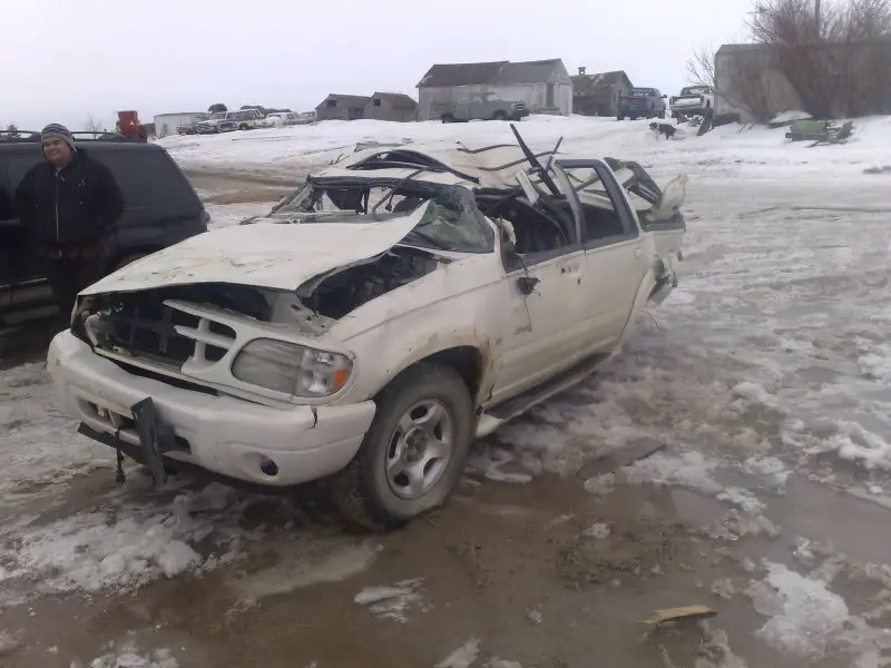

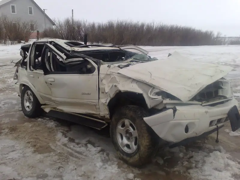

Well, Sarah helped me get Pickle out of the shop so we could make way for the donor "Pancake" that arrived today... however, there was no way to get "Pancake" into the shop.. so she's currently at a buddy's farm, I'm going to strip her tomorrow and then set to work on Pickle on Wednesday...
Here's some pictures for now....
And here is "Pancake"
Si
So whats the plan with pickle and pancake?
Disregard the 2nd part i edited out. I need to stop multitasking hahah
Pancake "was" an Explorer... she's a 2000 V8 Limited... I'm using the Engine/Trans in Pickle... Anything I can salvage will be sold off...

I see that now, I was talking to someone else and only looked at the picture for a second and it didn't even look like an ex! Haha
Wow!!! Pancake got knocked the hell out!!! You are a pro at naming your Explorers :)
"Pancake" was Sarah's idea.. I was gonna call it "Saskatchewan"... cos it's flat....
