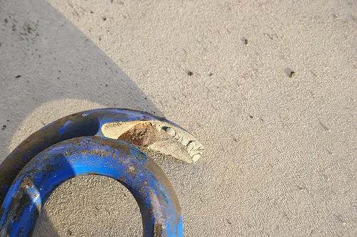

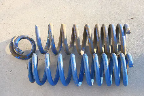

Last Sunday I decided to take an easy scouting run up to Charleau Gap. I wasn't taking the hardest lines (just twisting the truck up a bit). I got to a rocky section, started to go up and once when the front left tire went over a small rock (8" or so) I heard a new bang/pop.
I got out and noticed the left front of the truck looked a little low.. I figured I poped a coil spring out of the mount again (that happens when my RA bushings get worn)..
Turns out I did this to my Duff spring.. (good thing I have a spare set)

I called them.. they blamed it on jumping (kinda a sarcastic, you were jumping weren't you?), which I don't to..
For $184 they are sending me 3.5" lift coils (pair). They didn't seem interested in getting the old ones back to see why it broke. The one that broke was only 18 months old.. The older set (my spare set) had 150k+ miles on them with no breakage.

As a tool maker I see this type of stuff a lot with steel. It doesn't matter if its hard or soft.
Observe the fracture crystals very closely. Post a large picture of the fracture only so I can see. Sometimes the steel was already fractured before it finally broke. This is due to imperfections in the steel.

Here are very high res versions... DIAL UP BEWARE

to me it looks like it was a manufacturer defect... but I had them 18 months so they didn't seem interested in them.
If thats rust that I think I see in the fracture, its indicating to me that it has been cracked there for a while (long enough to rust) and I would let the manufacturer know about the possibility of the material used in the manufacture of the spring could be flawed.

If you were my customer I would jump through hoops to make sure you got another set of springs. That is a manufacturer defect 100K miles or not. Duff jumps their Bronco II in areana races with their 3" VR coils... and they dont break
