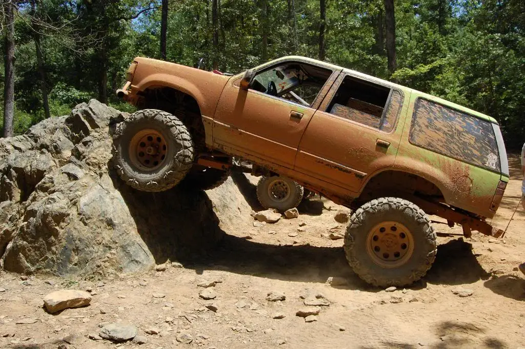

This was all done to pull the rad out. During the 2010 run at Uwharrie National Forest the explorer sprang a little leak after pulling up on a big boulder.
So the idea is to pull everything to make it easier to trace why my temp gauge is not working. Pulling the fenders was easy and will go back on easy. I was also thinking that the core support was bent but turns out it was not. The busted radiator came from when I had the accident in 2006 which almost totaled the explorer. It had to have pushed the fan clutch into the radiator at that time and I cracked it doing what was shown above. So now its getting replaced and then working out the other issued.
