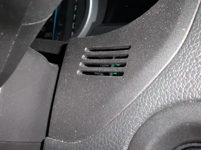

Has the noise been isolated to the fan? If so, it should be replaced. Tell them others have had authorized replacements done. If they refuse tell them you are taking your business to another dealer. Another option is to get Crystal (FordCustSrvc) involved with your dealer.

Since you can hear it when parked, that eliminates quite a few things. Also since you have a 2013 model, I would think that there is a very good chance it is the fan noise that others have heard. This would mean replacing the fan that is behind that small grill in the dash and is part of the cabin temperature sensing system.

They said the buzz/fan noise is part of the Blend Door Actuator system and they had to order parts. Hope that des the trick.

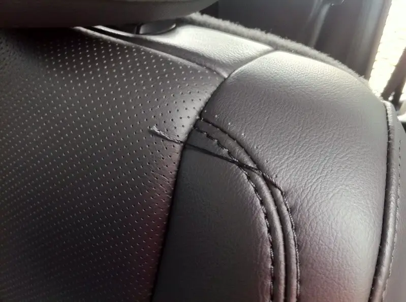

It's getting a seat seam repaired (middle seat, drivers side shoulder) and the door panel on the passenger side where it wraps to the dash is out if alignment.
All stuff agreed to get fixed when we took delivery. Would have ad it taken care of sooner, but we took the Explorer on its maiden voyage.
They claim that's fixed... they get the replacement door panel tomorrow... I guess I'll get me Ex back tomorrow. Next week, they'll be fixing the seam on the seat. I think they may be replacing the cover on that seat actually.

Thanks Crystal. According to my wife, the buzz is gone.
We need to take it back next week again to get the seat fixed... not sure what the wait is.
They can't fix the door trim... looks like this is an ongoing issue since 2011 where the trim on the passenger door at the wrap to the dash is not lined up properly. Seems that on a vehicle that stickers at $46K you wouldn't have to deal with this. At this point, I don't want the dealer to screw with it and make it worse. Other cares on the lot had that same issue. Some worse, some less, but all were not right.

Let's see how they address the seam coming undone on the 2nd row seat. I may need your help on that if it's not done right this week. Hard to believe it made it through a QC check with this. thanks, Bryce
