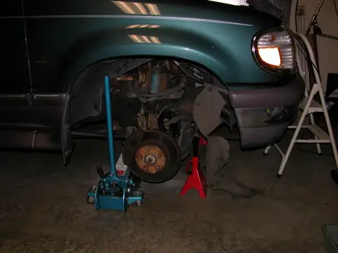

Finally got a free night. Figured if I could get it jacked up and taken apart, I should be able to finish this weekend. Since I'll be doing the plugs, wires, and sync at the same time, I put it up on jack stands and pulled the tires. Pulling out the coil packs to get to the sync was a bit more un-bolting than I expected, but the rest should go easy when I get back to it this weekend.
