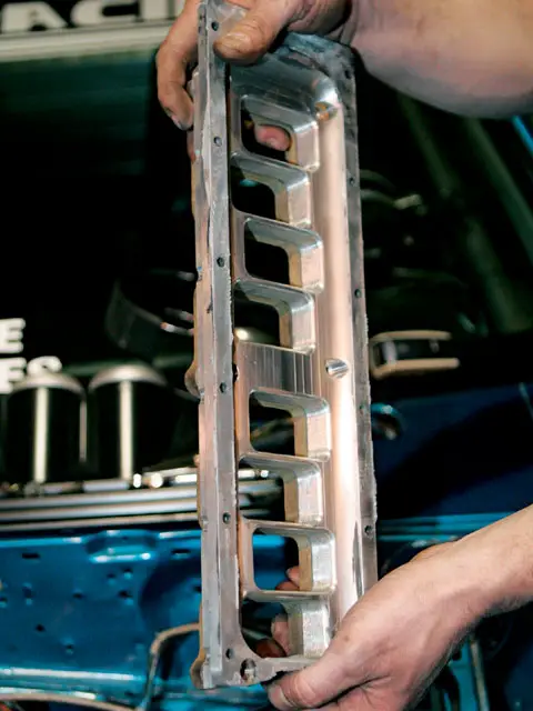

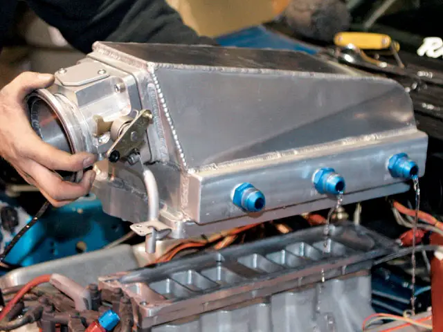

The best idea I thought of was to use an intercooler mounted above a TFS "R" intake(done before, pictured). That seems like the easy part, finding room around that to mount the supercharger is harder.
I suppose which idea would work best and which ones wouldn't depend on what V8BOOST is starting off with in terms of an existing custom fabricated lower manifold design or if he will use the stock (or stock style) lower. I think that there is enough vertical room in the bay to allow it all to be stack mounted as long as the AWIC core is chosen with care. The issue with offset or side mounting the blower is then you have to design and fabricate a good way to support it which can add complexity that is best avoided if possible. I am curious to see what V8BOOST is starting off with.
