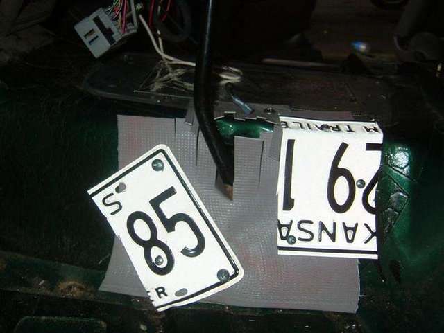

MountaineerGreen said:
15.You may want to fashion a cover to limit mud water and air from entering the cabin, just make certain it doesn’t interfere with the shifter function. Yes, that is a license plate I used to make my cover.
Won't this basically keep you from being able to play in the mud or do high water crossings?
if you seal it right that not a problem.
I used a boot mounted on both sides of the opening in the floor. with some simple metal rings, silicoln and pop rivets it would be 100% sealed.
This boot is from a Geyo tracker I pulled it at the junk yard.
The carpet helps
