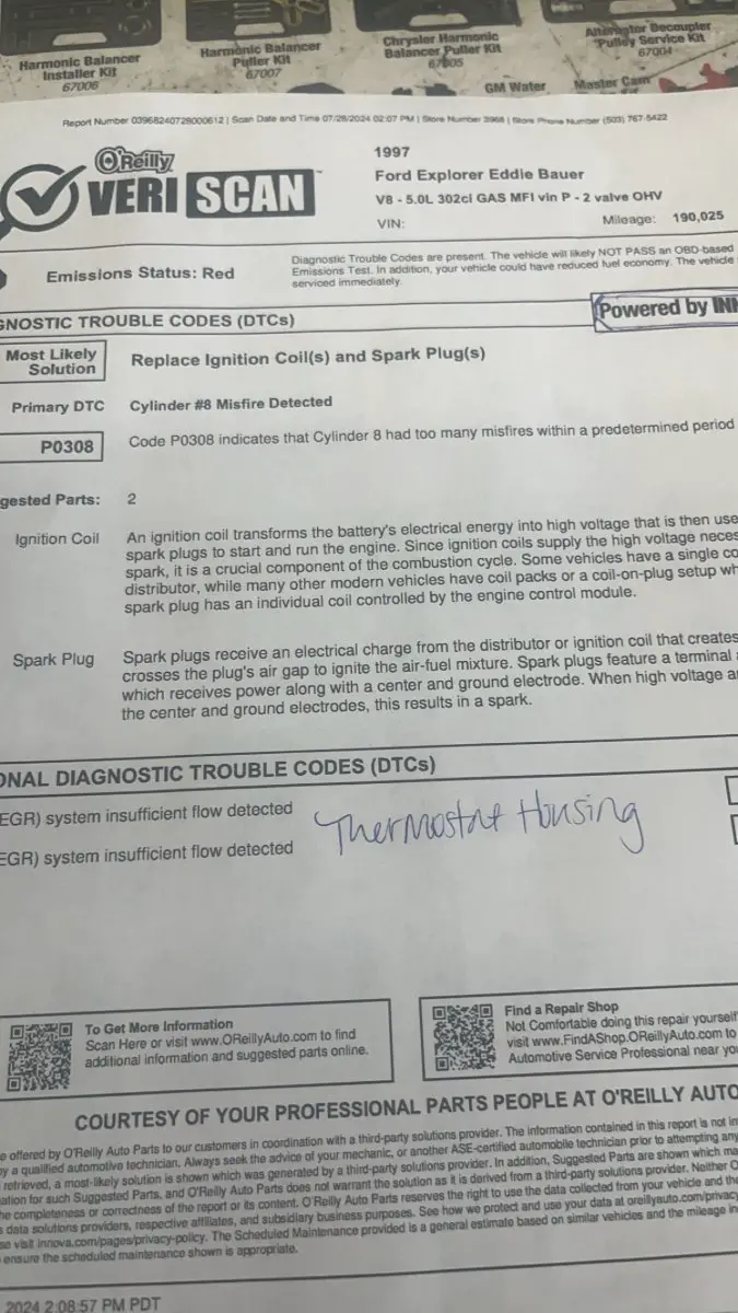

NOW I have a code for P0308 Replace Ignition Coil and Spark Plug; Cylinder #8 misfire. Could this be due to flooding of oil?

misfire could happen from the spark plus boot not locking into th coil on plug 8. Check the boot at the coil. You could swap the the coil pack, spark plug and Plug wire from 6 to 8. See if the misfire moves.
In my limited experience, a misfire code logged is usually caused by a weak fuel injector.
Your oil overfill could , and probably did, get into the intake tube and manifold. Possible fouled, plugged fuel injector.
I'd change all spark plugs , run a good fuel injector cleaner in tank.

Turdle is correct a misfire code that appears quickly is many many many times an injector issue. You see the ignition (spark) has a hard time determining a misfire so it can take many drive cycles for a misfire code to appear when the issue is a wire or plug
The computer is quick to recognize a misfire of a injector or bad valve, with these a misfire code appears in 1-2 drive cycles
So I would suspect the injector for cyl 8 (rear most cyl drivers side)
However since the engine was filled to the top with oil and ran many bad things could have happened… with the correct 5 quarts of oil (does not matter if it’s synthetic or not in fact finding a real Dino oil anymore is very difficult) run it and see if the blue smoke stops… it should. Then try some injector cleaner like suggested

You have a misfire code for an injector issue on #8
If that injector is stuck open then every time the fuel pump is running it is pouring gas into crankcase
Gas in the crankcase will destroy your crank bearings quickly
Was it 10 quarts of gasoline?
You need to drain some of your oil now and take a sample in a clean/ clear jar and inspect it
Stuck injector dumping gasoline would need to be fixed now
There is nowhere that gasoline can enter your crank case except through an injector
You can fill the engine with oil all the way to the top and still no way to get gas in there except through an injector
If #8 injector is stuck open it needs to be fixed right now
