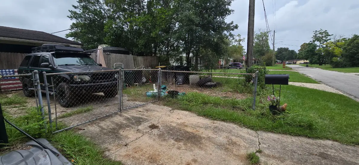

And finally, she's in the driveway! Family sold one of the other trucks, made room, and now it's time for work! Dang was she a pain to move from sitting for 2 years, then up a steeper driveway was fun. But time to start making progress!
